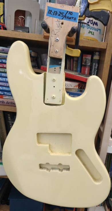

    10 coats of Brite Tone, now hanging for 30 days to cure. A few drips to fix. My best job so far with the brush, but my technique still needs work. I do the top last in each coat, and it is in the best shape. It may be that I turn the body too quickly and I got a few runs that way. Brush strokes leveled out nicely though. Taclon brushes are a big improvement.
    I may attack the few drips in a few days, before the finish fully hardens, so that the drips are hard but not brittle. I have noticed that the finish keeps tightening as it cures. I have managed to get drips out in the past, but have learned the hard way not to sand too soon.Click image for larger version.
