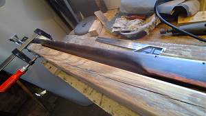

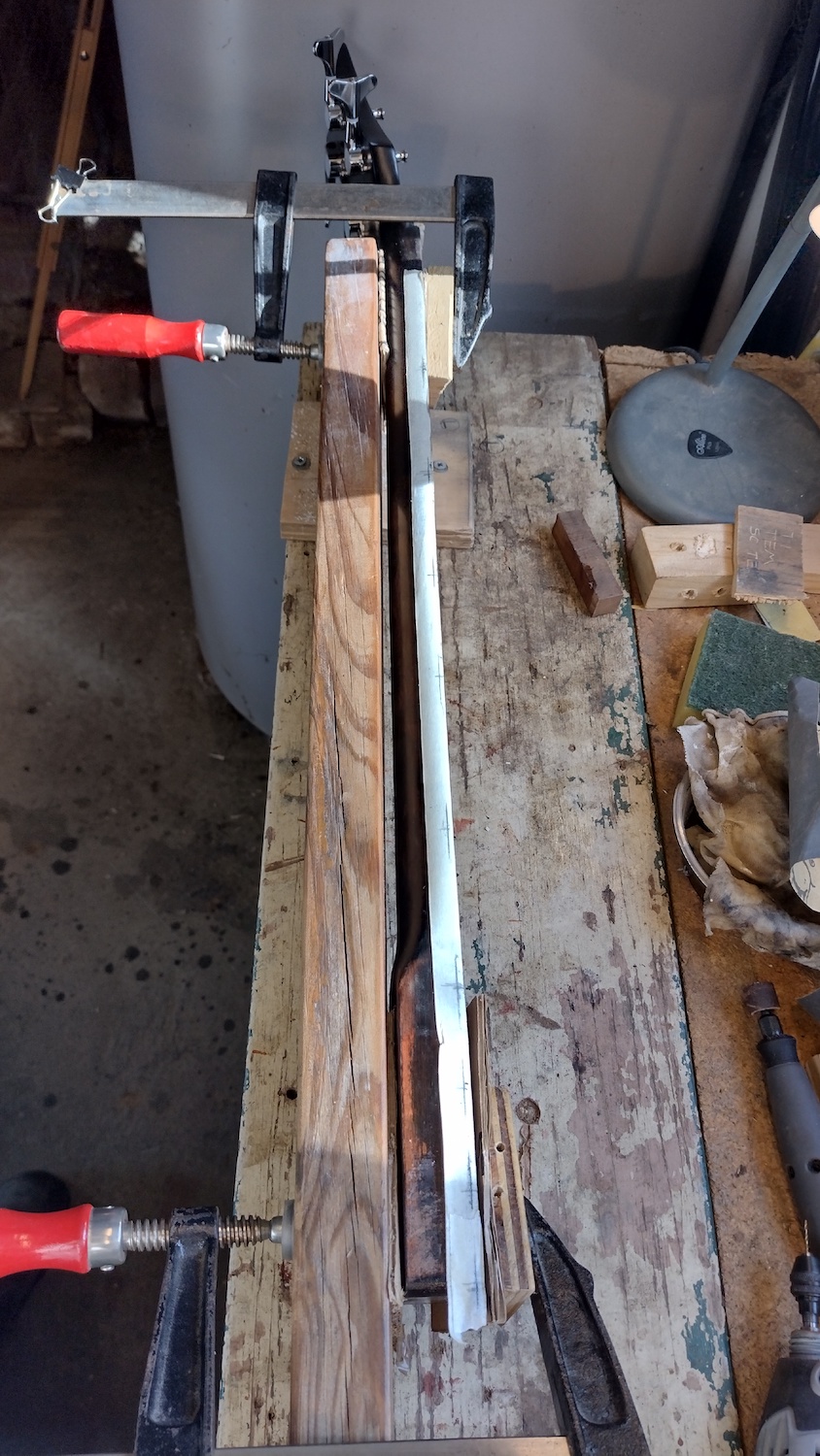

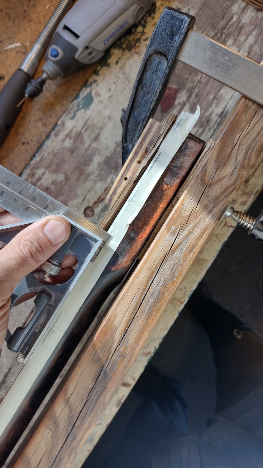

    Yesterday I decided to go ahead and mark the side dots on the fretless position (in line with the frets).
    I have put some masking tape on the side of the fretboard, tuned the instrument very carefully; then proceeded marking in pencil the position of the 3, 5, 7, 9, 12, 15, 17, 19, and 21st fret with a vertical line, using a tuner, checking across all 4 strings.
    I have clamped the neck gently to a simple jig I made, and with a square ruler I drew a horizontal line across the side of the fretboard so that all the new side dots are sitting at the same distance.

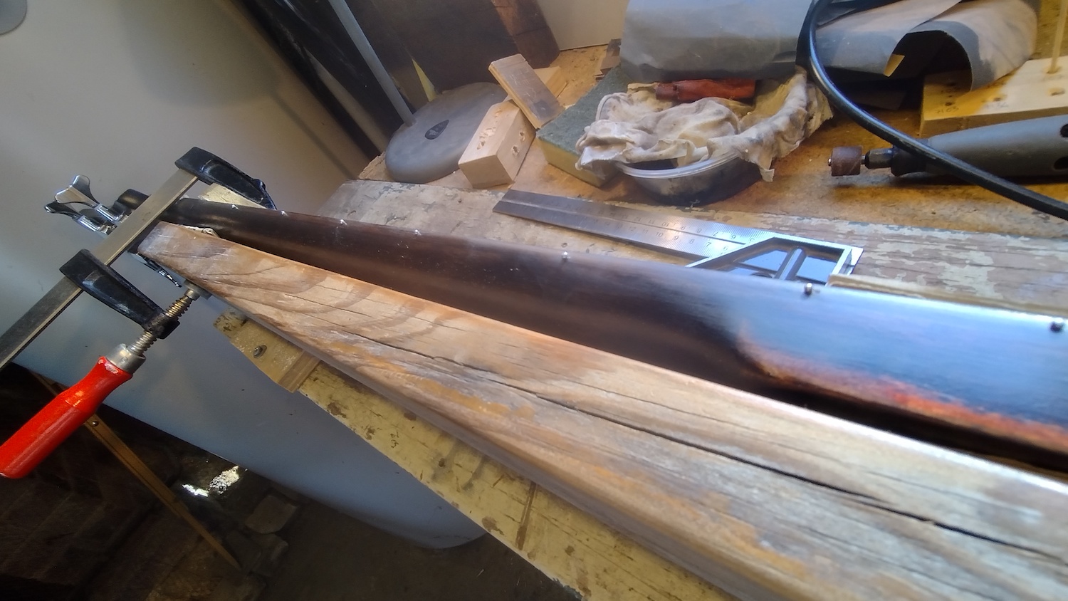

    After that, the process is somehow similar to what I have done at the beginning of this build to take the side dots out.
    I found a suitable drill bit.
Name:	03_drill bit smaller than pin head.jpg

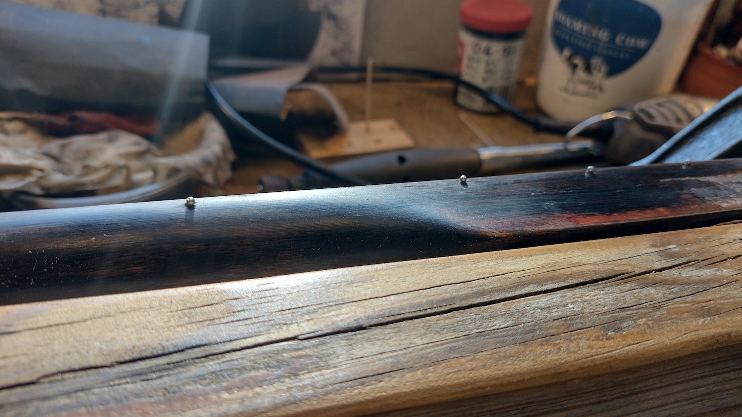

    drilled all the side dots in the marked position, removed the masking tape and inserted the pins, which were shortened to bite in the timber only about 1mm.
    Like I did for my last build, I am going with metal pins slightly protruding out for a tactile and visual feel because I have received good feedback from those ones who tried the instrument and because I like it. I fell like this time I really fine tuned this technique.

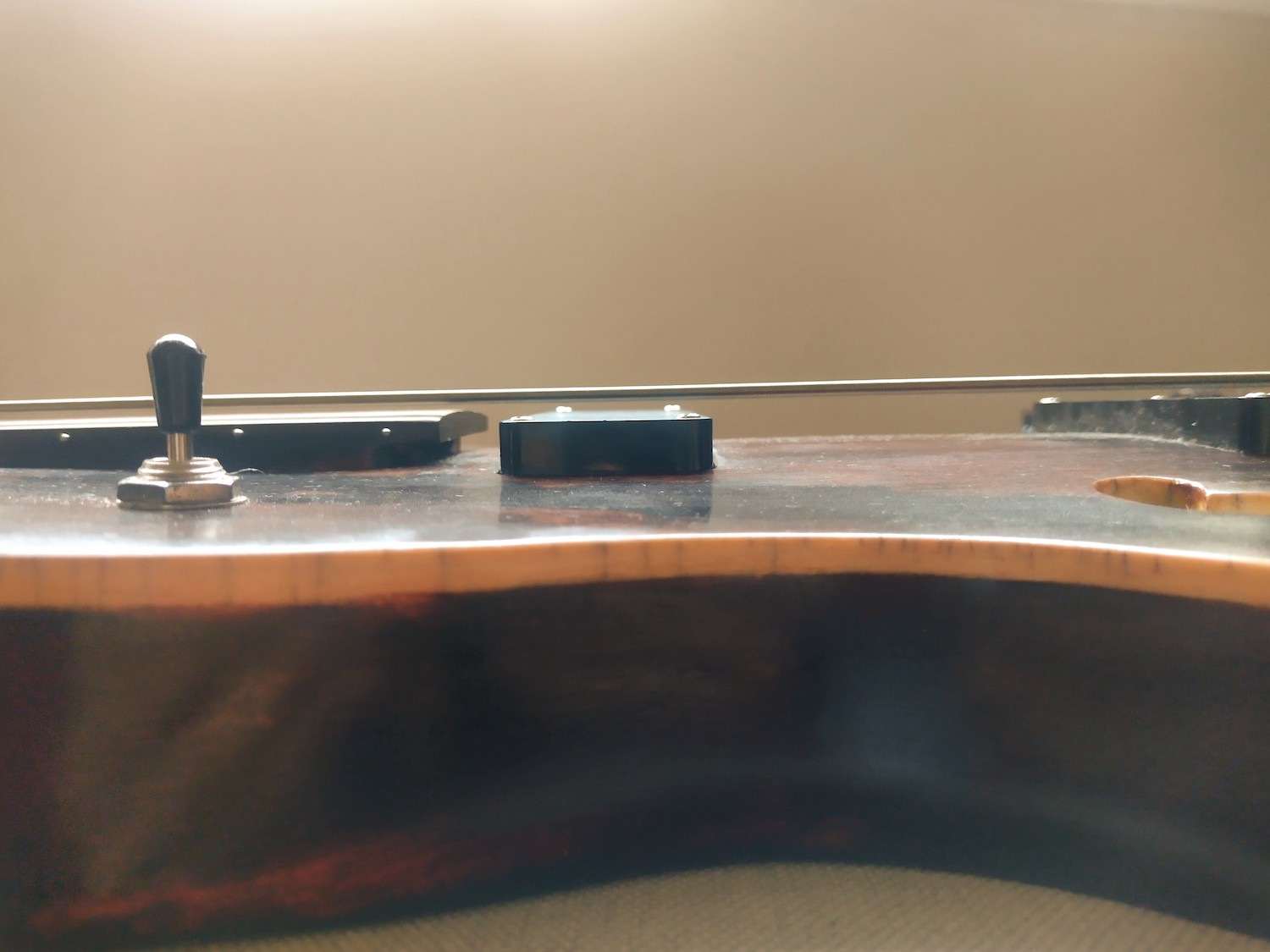

    Adjusted the neck pick up height which was sitting on a weird angle. Now it sits parallel to the strings.

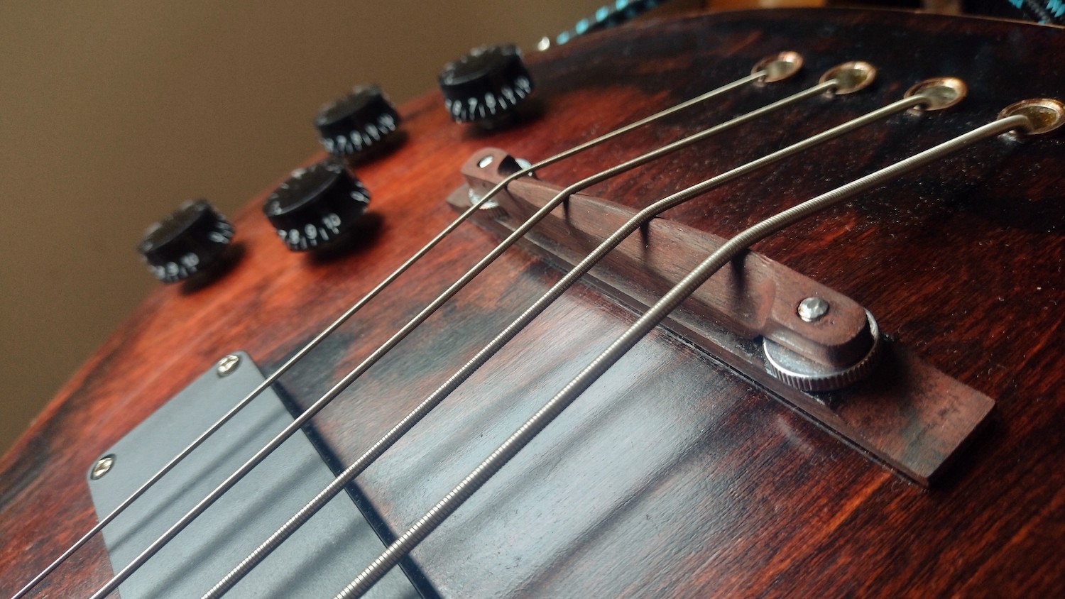

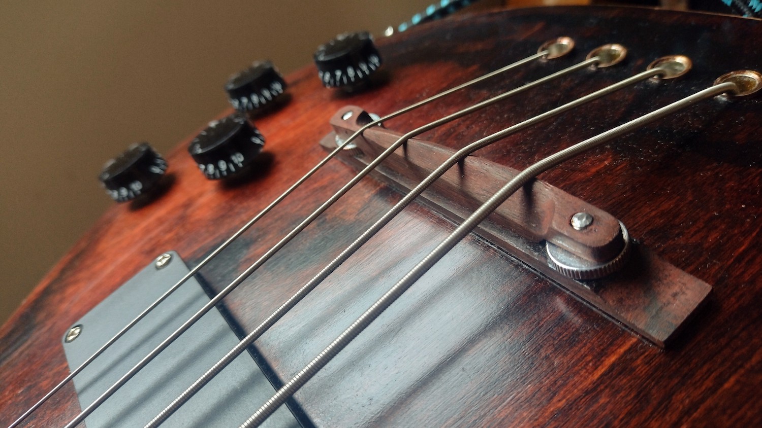

    Shortened the screws that were protruding out the floating bridge (the bridge will never get higher than that)

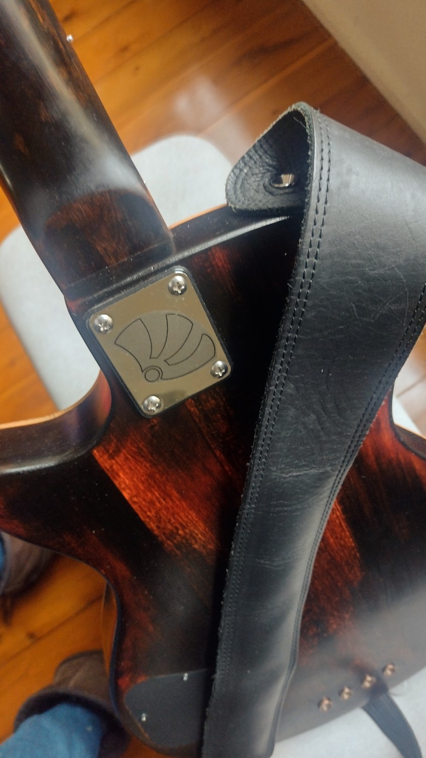

    Added my logo to the neck plate

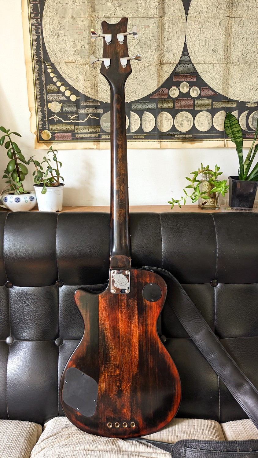

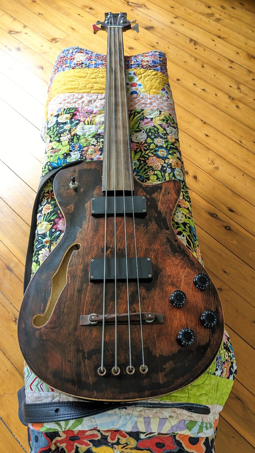

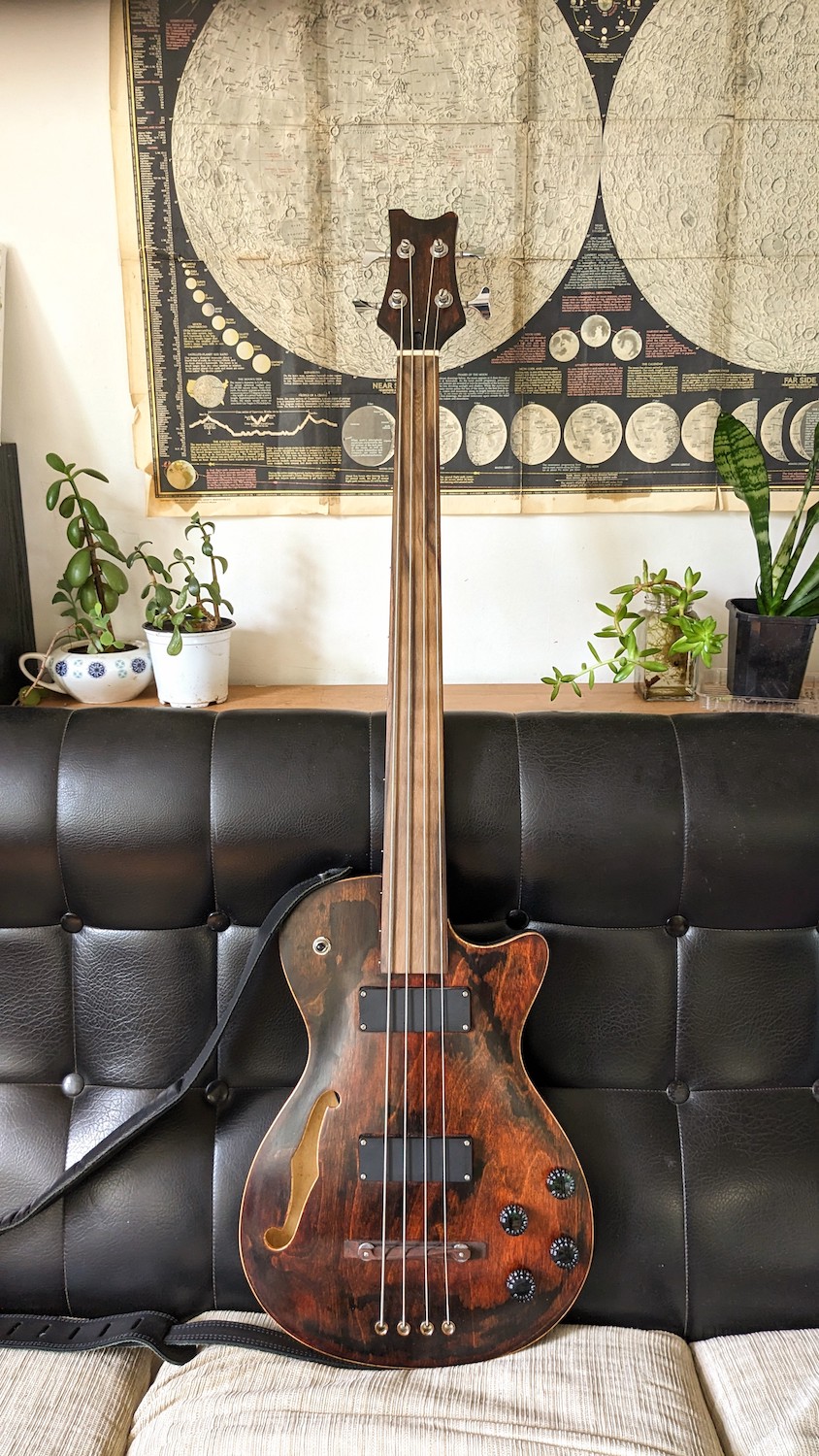

    bass finished a few months ago but haven't had the chance to upload some photos yet, here we go
