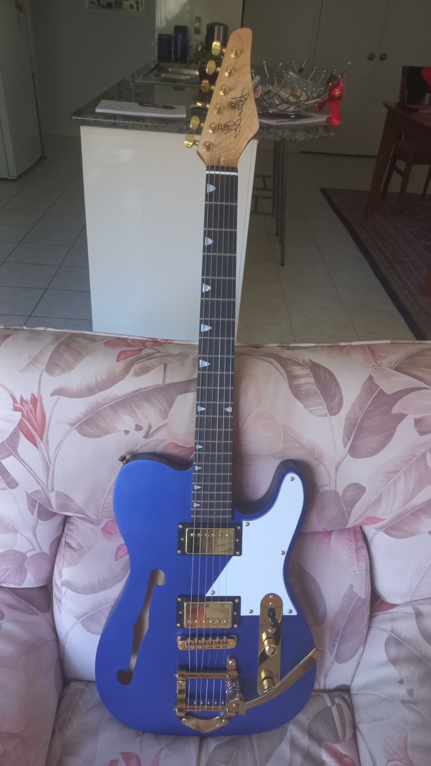

    Well everything ended up going together easily and I did end up with my guitar for Christmas 🎅
    However … there is no relief? When you hold down the string on the first and 20 fret the string sits on all the frets-no gap. I went through the truss rod adjustment video’s which said I had to loosen the truss rod. I managed about a full turn before it got stiff but no discernible change in the neck bow. They say don’t force the truss rod when it gets stiff, but no one gives a definition of ‘stiff’. I saw a video a number of months ago where they had the neck by itself on the bench, supported at the ends, and a clamp in the middle applying relief. Would anyone recommend trying this.? Any other ideas would be greatly appreciated. It looks good, but I would like to be able to play it too.

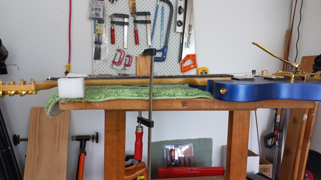

    Thanks for the link. I had a look at it, and tried the truss rod again but I am just too scared to put too much force into the adjustment. I am already applying a fair amount of pressure. I looked up as many setup figures as I could find and interestingly all the figures on the TL are in the ballpark - except for the relief. I chased up more neck adjustment video's and found two that apply physical force to the neck to adjust it so I have gone down that route.
    Its been sitting like that for about 6 hours, so before I go to bed I'll tension the strings and keep my fingers crossed for the morning check.

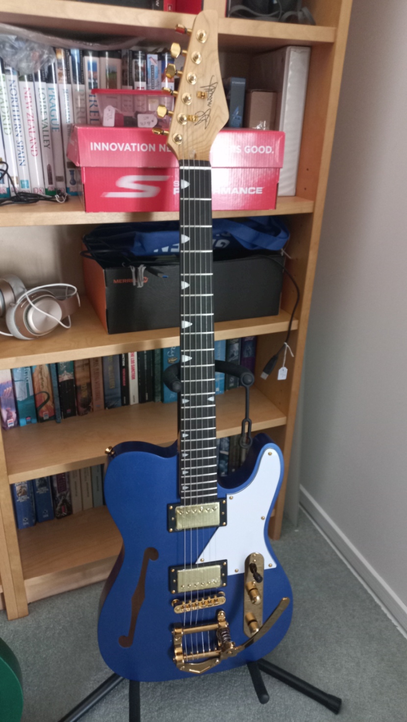

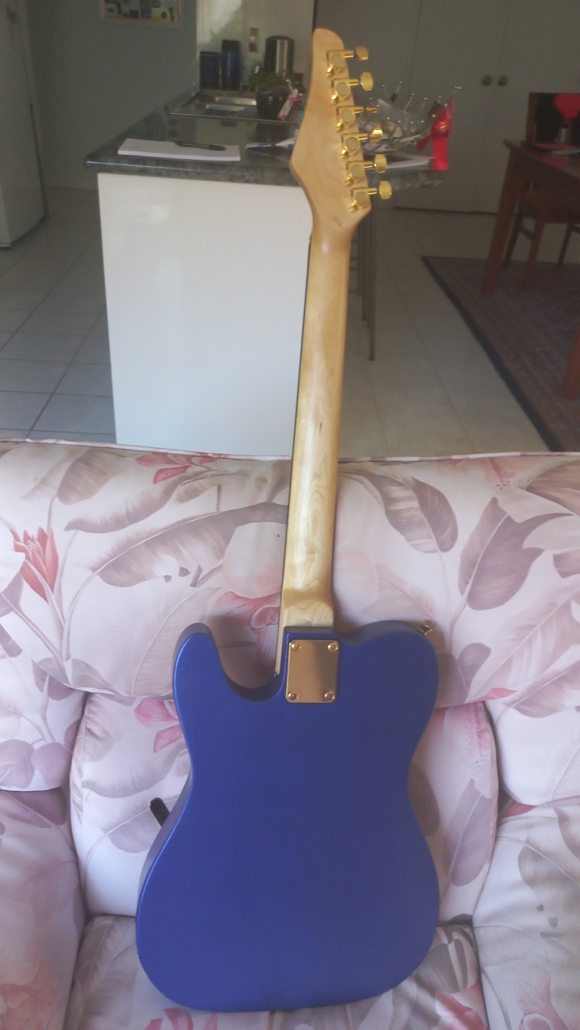

    Well the bending helped slightly, but I have found that the action has improved over the last few days. Maybe the neck just needed to be under tension for a while. I also lowered the nut by 2mm, which made a big difference. I think I am going to call this build complete.Click image for larger version.
ID:	43901Click image for larger version.
    So what is my next build going to be? I had a 335 clone when I was young and I quite fancy those. I have also lusted after a Les Paul, so watch this space. :-)
