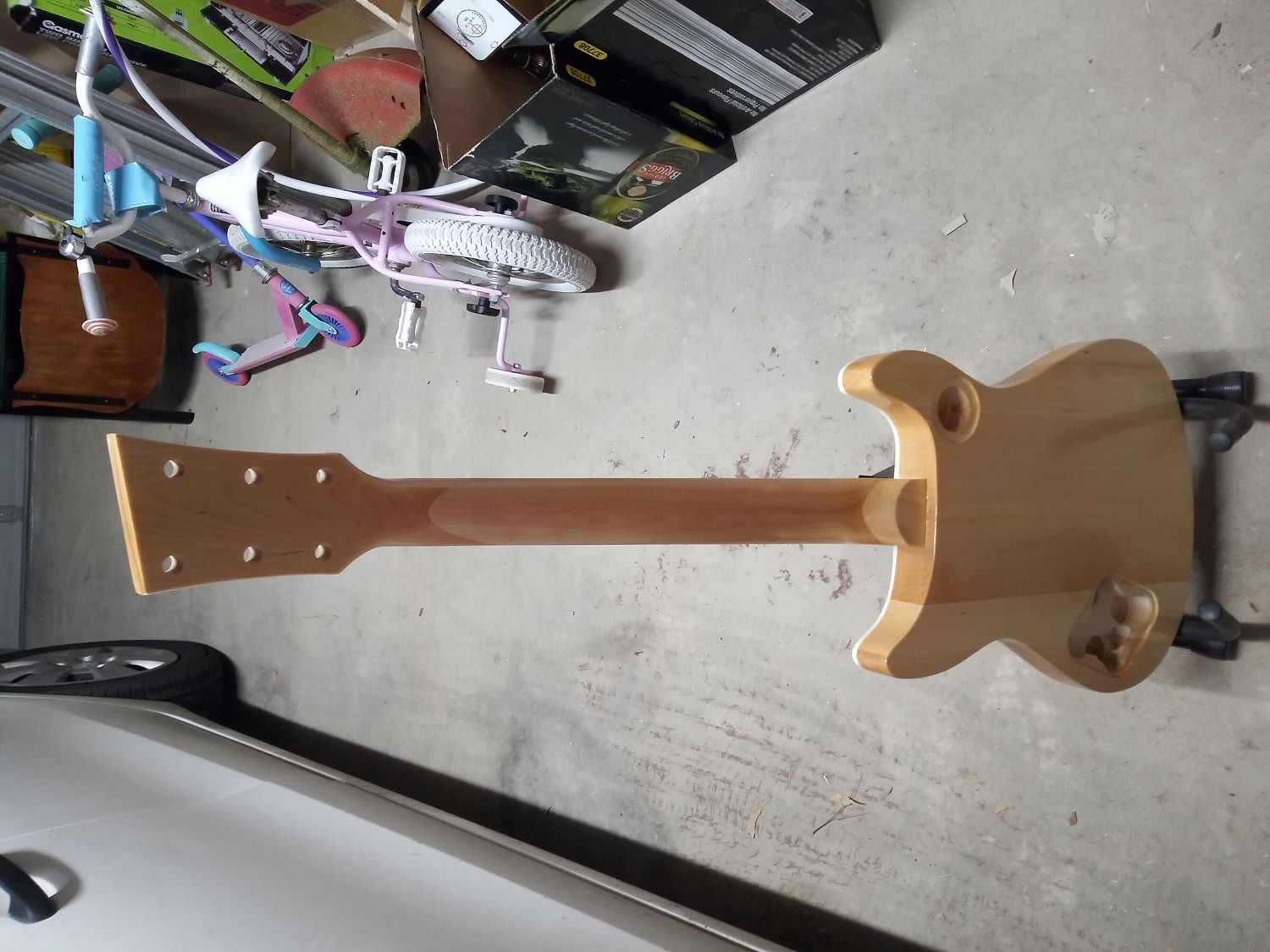

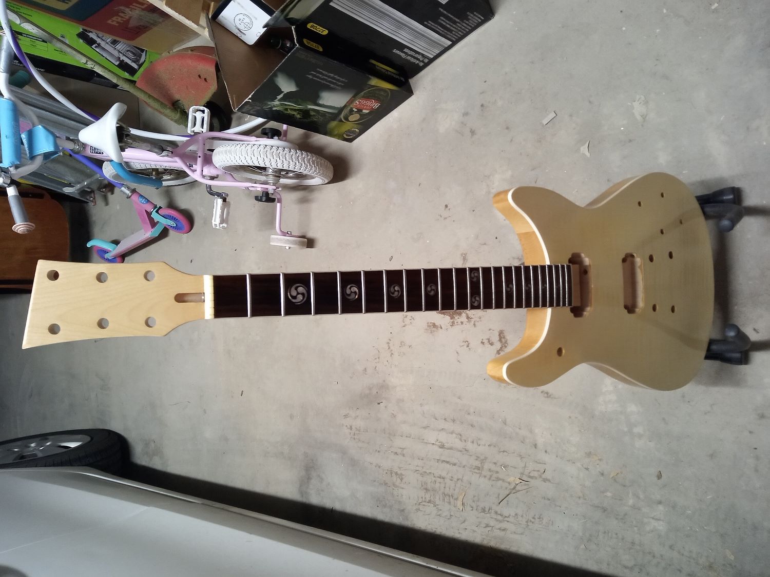

    Hi everyone. I've spent the last few weeks putting layers of oil on. I have done about 26 coats on the front (sanded it 5 times) and 21 coats on the back (sanded it 4 times). Each time I got 5 coats on the front and also the back I would sand the whole thing. After the last time I sanded I have put 1 more coat of oil on. I'm pretty happy with how it has come up.
    This afternoon I will start fitting parts to it - it's a big moment.
    I'll be sure to add photo's just in case I do something dumb and need to be corrected!
    Cheers
    Phil B

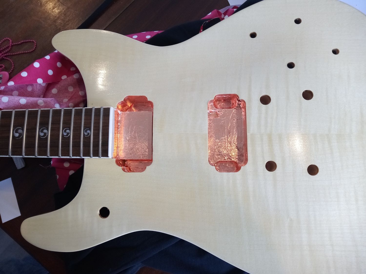

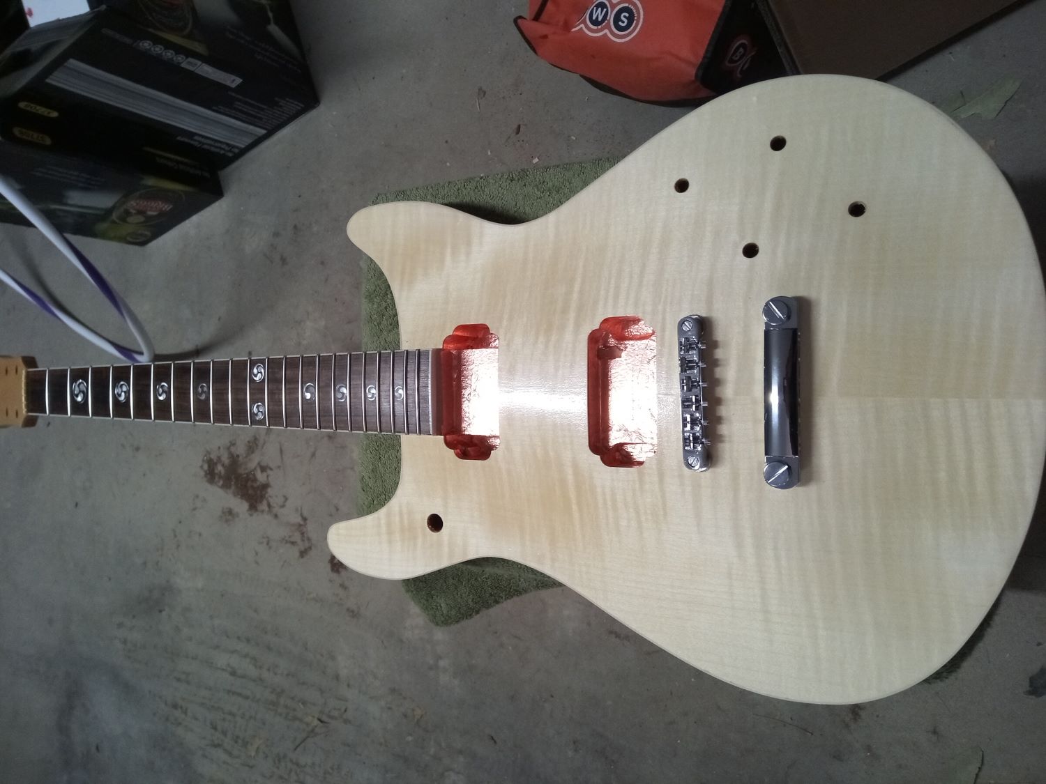

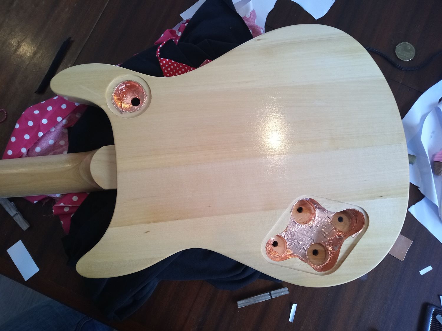

    I got a little bit done today. It was nice to be doing some different parts of the build.
    I put my copper tape in - I'm glad I was not wasting it there was hardly any left.
    Then I walloped in the mounts for the bridge.
    Hopefully the progress continues tomorrow.
    Phil B
