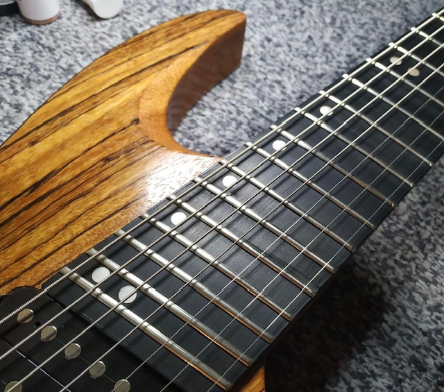

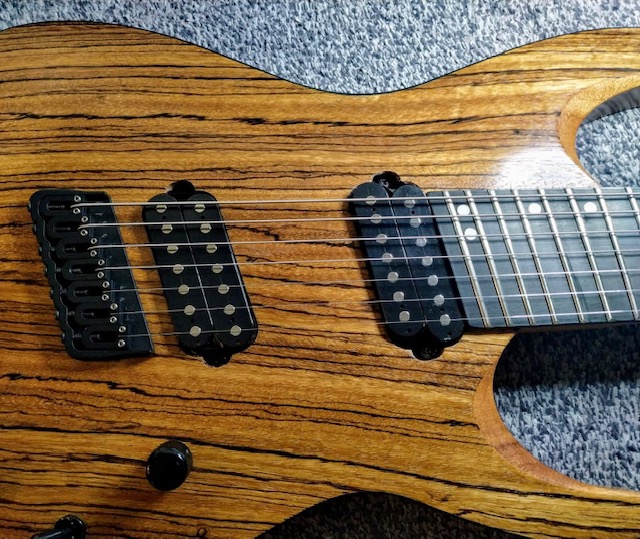

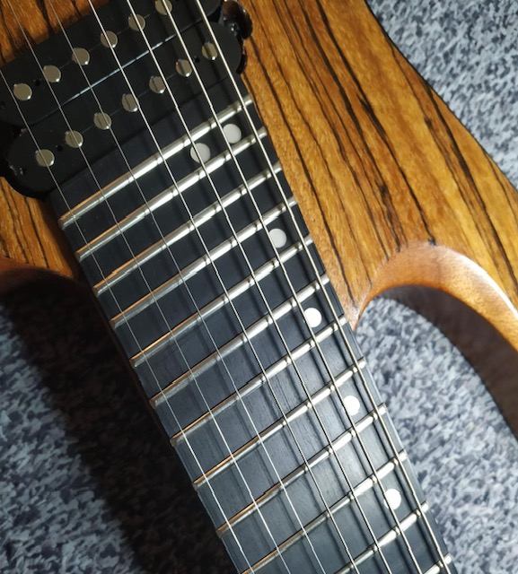

  5. #35
    Finally finished this, had a bit of trouble with it and had to get some help with a fret i damaged. Had to get it replaced
    it plays really well now, it has a push/pull cts pot (Just fits in) to split the coils
    would have been nice if the routing of the pickups were a standard size for an easier swap, but its impossible without a router and some more serious work which i don't have the tools for
    anyway. its a great guitar and fun to play

  6. #36
    Looks really nice. Well done.
    How are you getting on with the fanned frets?
  7. #37
    thanks simon,
    yeah not too bad, takes a bit to get used to, lots of looking at the fretboard whilst playing
