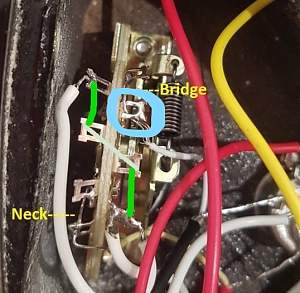

    I'd check one of your solder joints. If you haven't done it already, the the connection I've circled in blue doesn't appear to be soldered. it may be touching the switch tab at the moment and making contact, but it needs to be soldered for reliability.
Name:	no solder.jpg

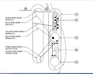

    I know I'm late to the party here, but for future reference, for any 2 pickup guitar with 1 volume 1 tone and 3-way lever switch, I refer to the good 'ol tele wiring scheme. HB's or SC's principle is the same
    Plain & simple:

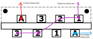

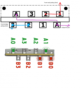

    If the unnecessary (but not harmful) extra link from each pickup wire (from A0 to A3, and B0 to B1) in the horribly flawed DiMarzio diagram is removed, that tele wiring is exactly where we ended up. I still feel bad for not checking that diagram in the first place, but at least the guitar is working now.

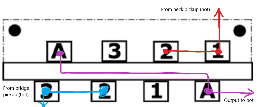

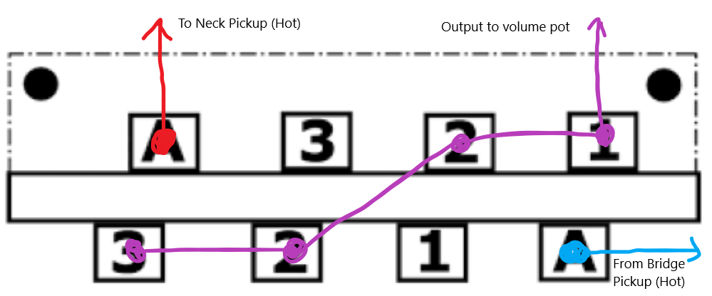

    This Dimarzio diagram that was linked to is perfectly correct. https://d2emr0qhzqfj88.cloudfront.ne...t_3w_all_0.pdf
    These are the 3 ways I've found (so far) to wire that type of switch, with that Dimarzio diagram being one of them:

    The third one is really just an extension of the second one, as the extra links are superfluous, but it still works.

    Simon, you are correct. Hampered by not having a switch handy that I could test with a multimeter, I have misinterpreted a (misleading?) detail on the Fralin diagram. They have the relative positions of the terminals mirrored - "A" in your diagram is shown as the terminal closest to the end on each side. I interpreted this as the switch being viewed from above rather than below but it is actually a red herring with no meaning at all. Terminal identification is purely an order/left-to-right affair. If I ignore the different terminal offsets then all diagrams you linked make sense. Here's a composite image showing the Fralin image on the bottom. Terminal numbering is identical, but the offset relative to the two narrow ends of the switch are mirrored compared to every other diagram I have seen. Confusing, but not wrong.
