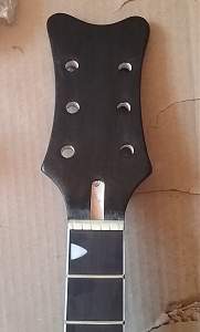

    Head and neck get a 3rd coat, and I like it, but the photo reveals that I accidentally wiped off the wood what was close to the nut ... and it seems I've put some unsightly blackened fingerprints on the fingerboard! Let's pretend it's extra-ebonising of the ... umm ... rosewood.

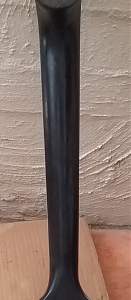

    Question 1.: What's going to be a nice way to get rid of most of;
    • the darkening of the binding and inside the f-holes?
    • the smudges of intensifier on the glueing surfaces of the set neck?
    Please advise, thanks, good sirs.

    Removing stain from binding is a pain but personally i would use a stanley knife blade and gently scrape. Don't be tempted to use steel wool or sand paper as that risks cutting in to the finish beyond edge of binding.
    Thanks, Waz. Got a reply in before I finished editing! 8)
    So use of solvents isn't recommended then, I gather?

    Nah, Solvents could leach into the existing finish.
  7. #37
    Scraping the surface of the fretboard (with the grain) with a sharp Stanley knife (box cutter) blade or single sided razor blade may get some of the stain off. A good scrape never goes amiss on a rosewood or ebony board. Cleaning/rubbing with lemon oil may also help. Lemon oil will also darken the general appearance of the board. As Waz says, wait until the end and scrape the plastic binding clean then, so I'd wait to do the board at the same time.
  8. #38
    Beveled Oboe Reed Knife for binding scraping. It makes it fun, and won't slice the crap out of your fingers. You can wrap your fingers around the blade and it won't cut you, but sharp as F*** for scraping. I literally wrap my fingers around the blade, and use my thumb as a guide against the top of the surface (sorta like a router guide).

    Thanks, Waz, Simon, and Agus for the options. Much appreciated.
    I actually don't mind the "smokey" look that the binding has now. I might try to clean some off, but I'm not particularly concerned. What worries me more is that gents such as your good selves will think ill of me for not going all-out on this, my first build. So, will bypass solvents, will try a little Stanley knife blade scrape. Will also bypass the reed resurfacing tool as a ... luxury item. :P
    Because the intensifier went on somewhat thickly, I'll be giving a little wipe down tomorrow -- unless you think it should stay on now that it's there and seems pretty evenly applied?
