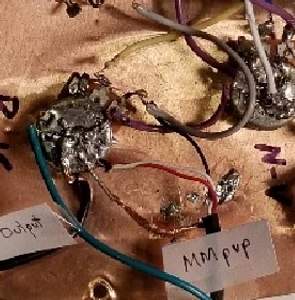

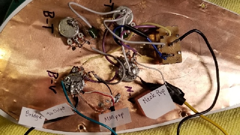

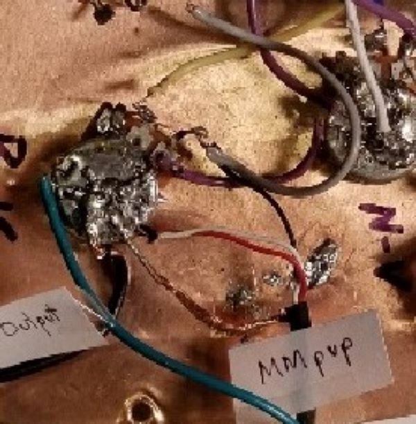

  9. #39
    Member OctoberBassRCA-4's Avatar
    Nashville, TN, USA
    106
    RCA 4 Wiring Photo
    So I'm posting some photos of my wiring job. I included the GFS wiring diagram sent with the MM Pickup.
    The bottom illustration is what represents my wiring.
    Somehow this is wired Out of Phase, or it sounds Out of Phase with the Single Coil Neck pickup. The SC is way louder than the MM HB. I have swapped the Hot (red) and the Ground (black) in effort to get In Phase.
    I understand my soldering is really bad.

  10. #40
    I may have seen some neater soldering.
    It looks like you've soldered the coil tap wire to ground. so you'll only get a singe coil sound. Simply cut the white wire right by the pot and you should get the full pickup output back. The white wire is only connected to anything (ground) if you want to tap the pickup. Otherwise just leave it free, but just make sure the end can't touch anything else, so best to wrap some insulating tape around it.
