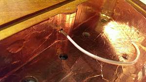

    You don't actually solder the ground wire to the post, it just makes pressure contact when the bushing is pushed in. Recent discussion about how to install it and what to do if the bushings are already in.

    To get the bushings out, drop a small screw (upside down) or something down in the bushing then screw the post into the bushing. It'll lift right out.
    Then strip the end of the earth wire, poke it through so that there's 1.5cm or so in the hole and put the bushing back in.

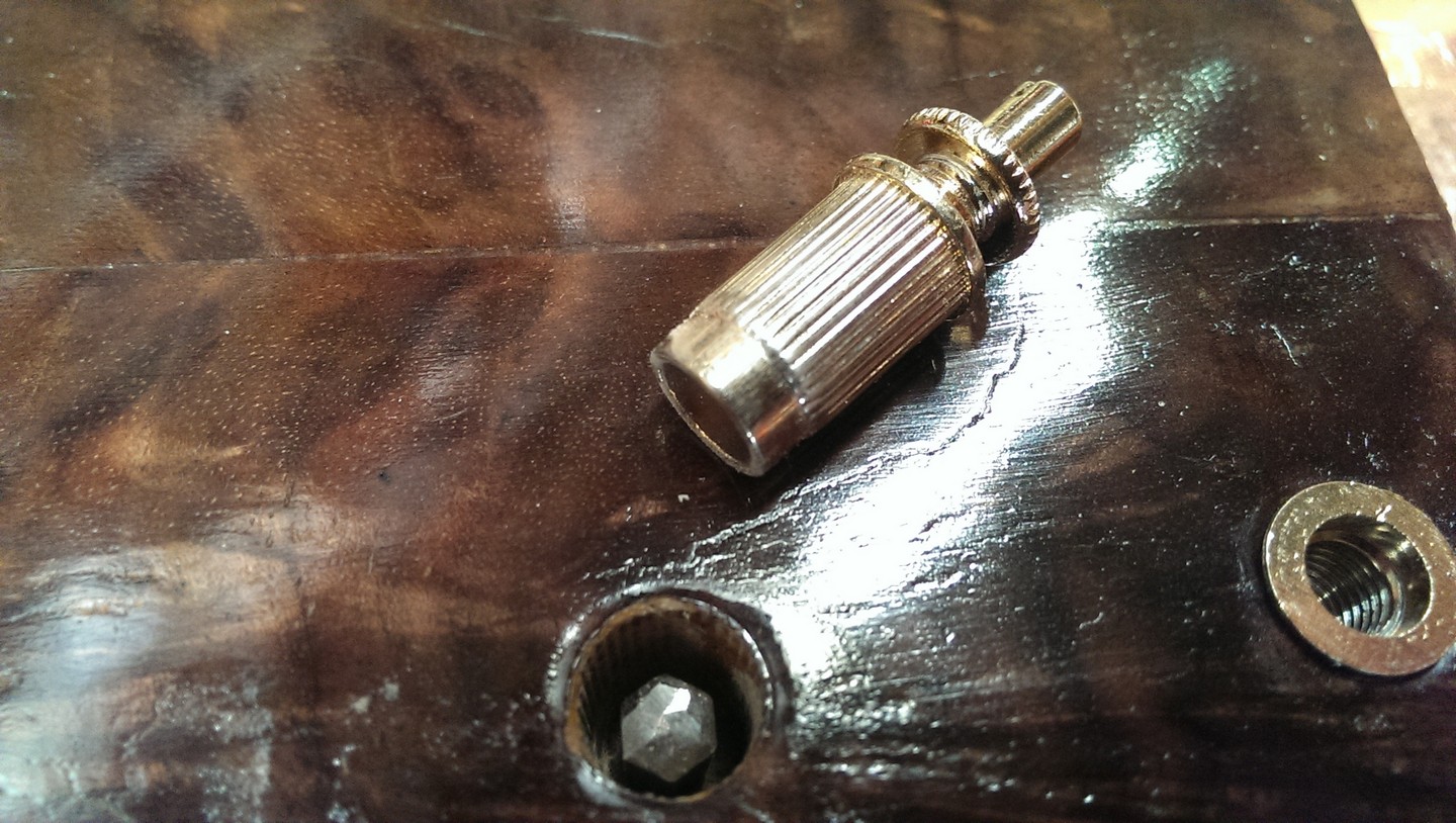

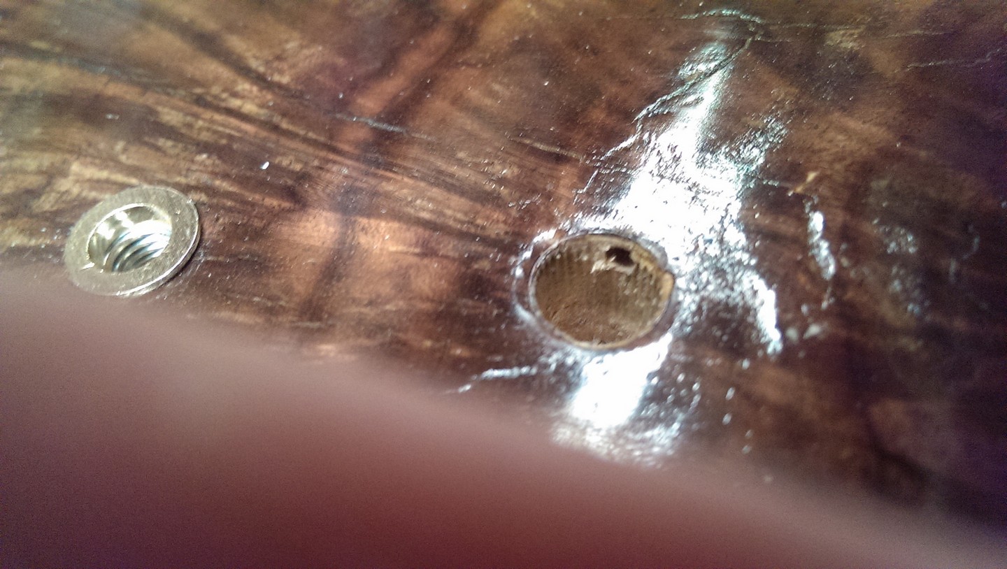

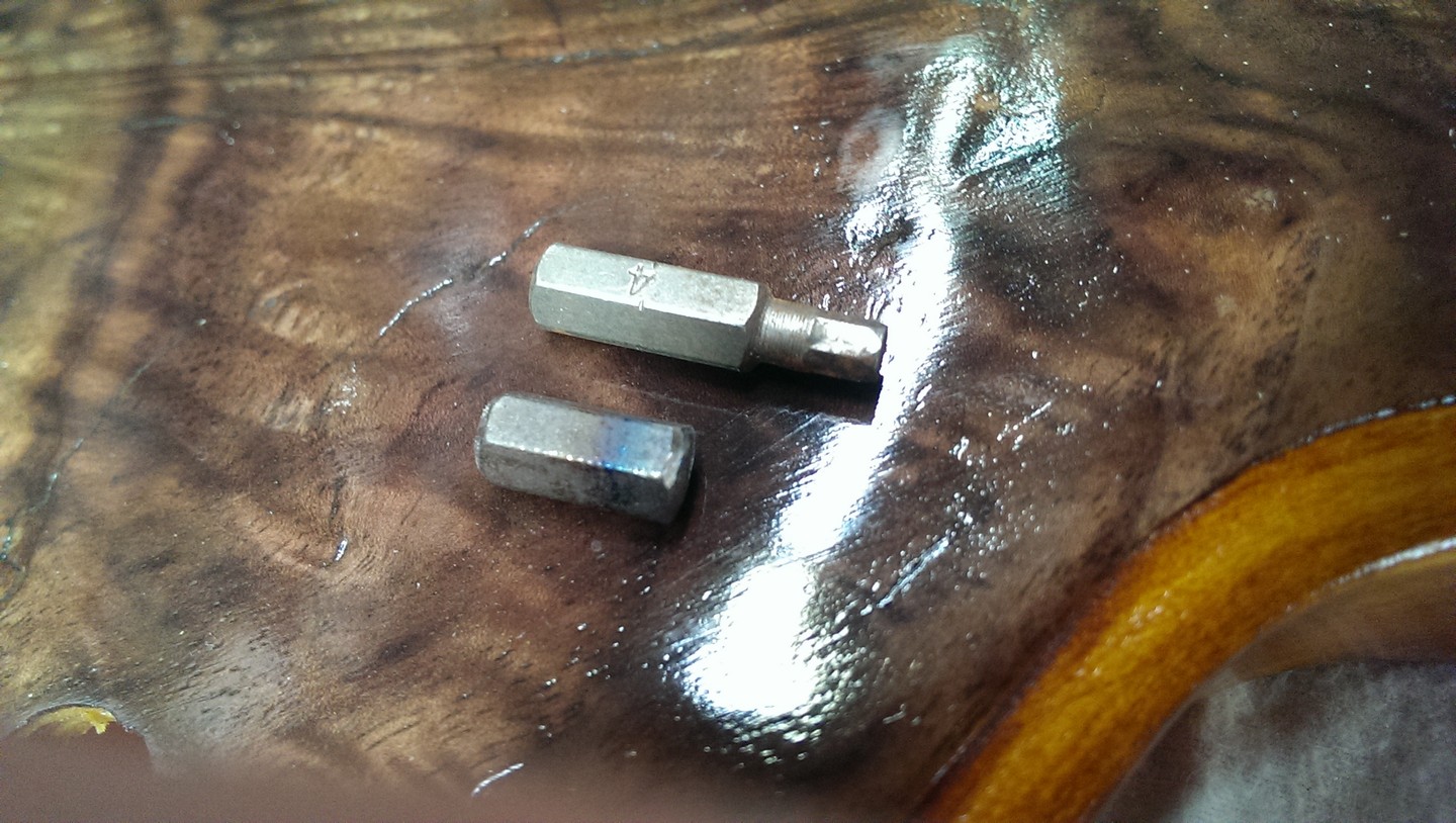

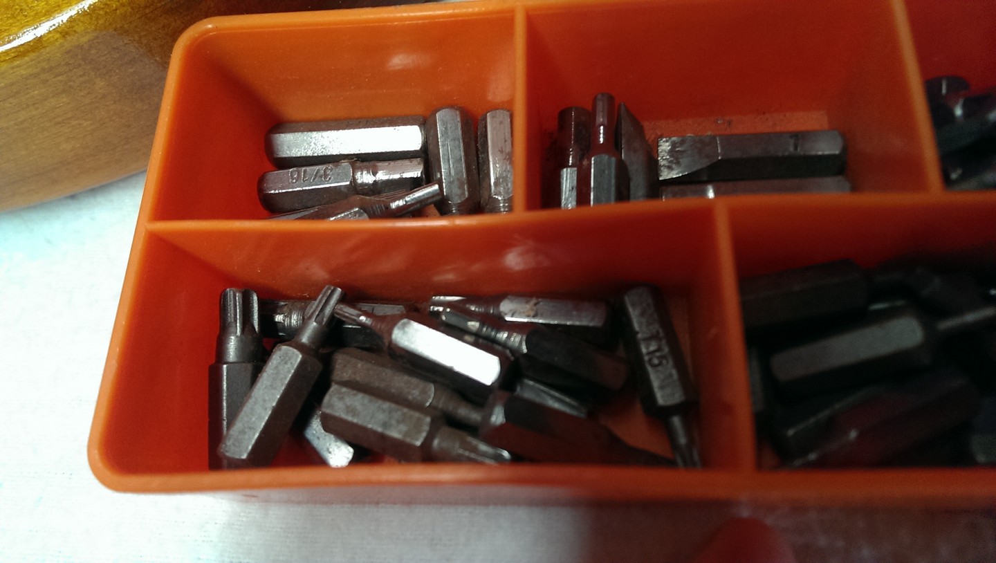

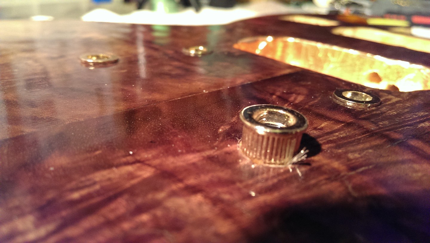

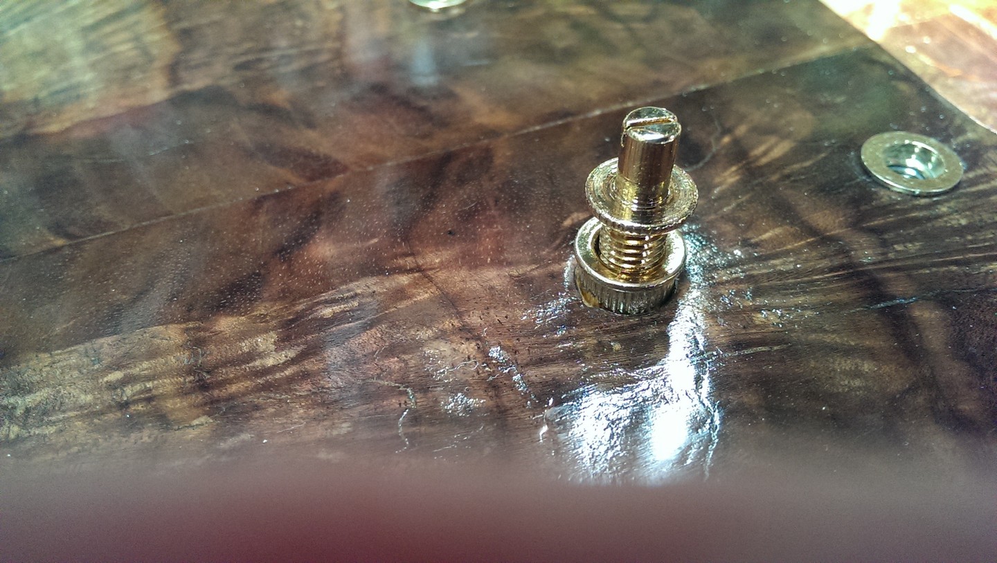

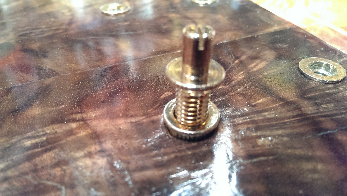

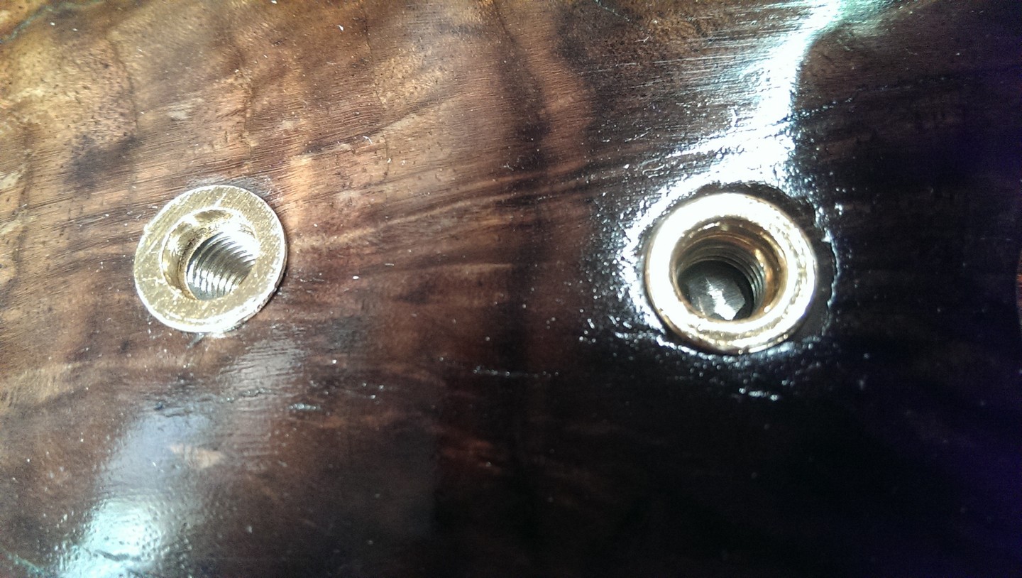

    Ok, big thanks to Weirdbits, Dan, FredA and Stan. It worked like a charm but with a slight modification.
    I was too lazy to go and find the correct thread size so i looked in the shed to find a substitute. All i needed was something solid that would perfectly fit into the post without getting stuck.
    A Drill bit fitted perfectly, so i ground the end off so it was below the thread line so i could screw in the post fitting and BINGO, it came out like a bought one.

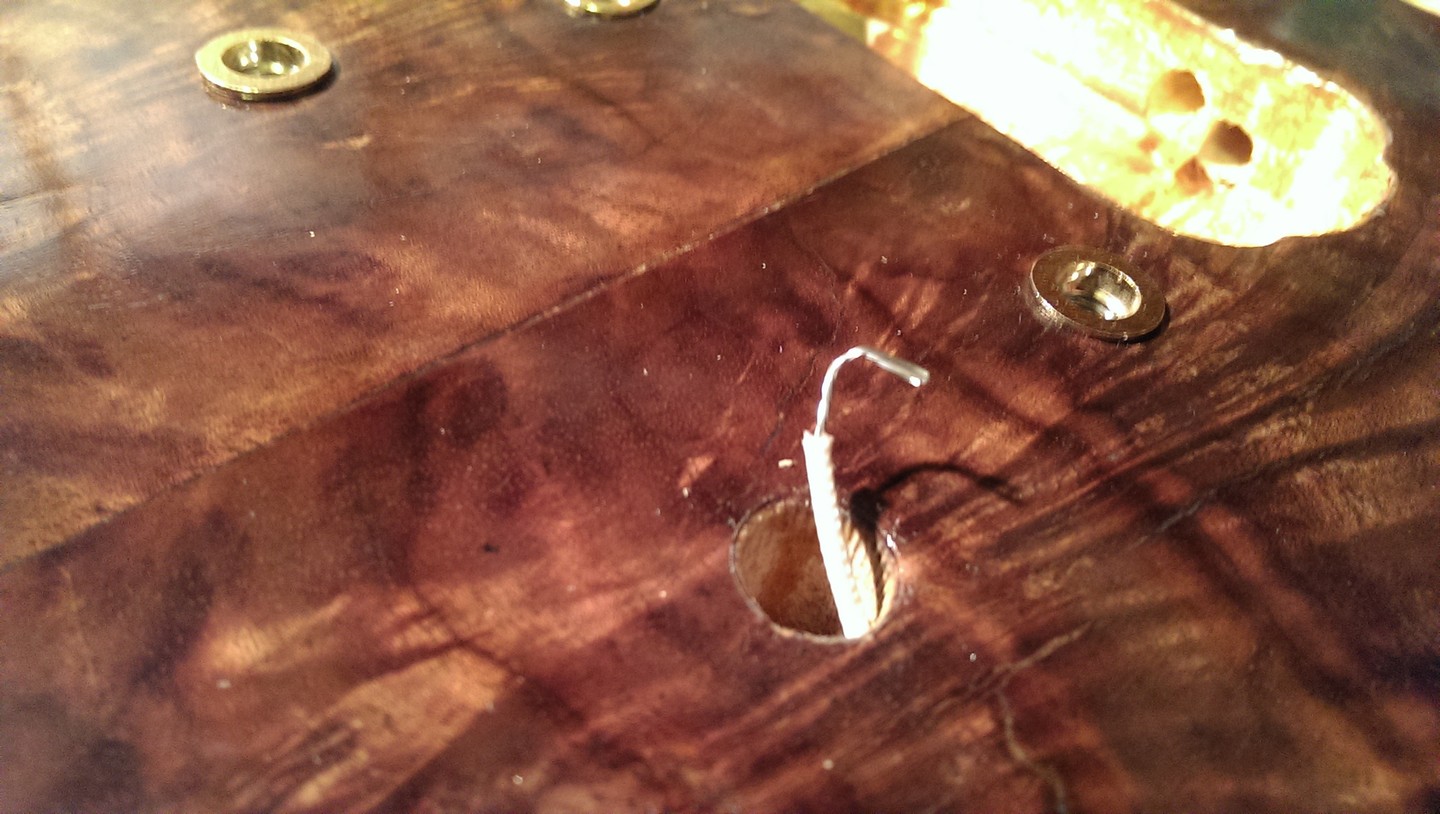

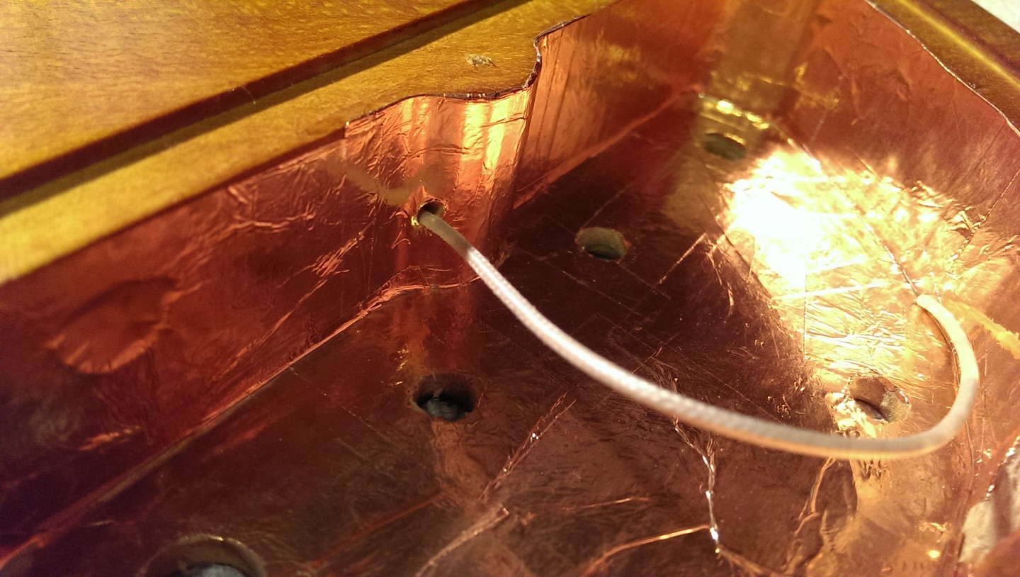

    Next i cut a piece of braided wire to fit, bared the end and bent it back so when i replaced the post the bare wire end was firmly wedged between the post exterior and the wood hole that it was going into.
    It came up like a treat, thanks again guys.
