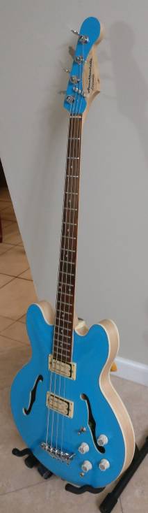

    Pretty happy, yeah. Got two of the four steps completed on setup. Will need to file the nut a little...but it's close and actually playable now. Looks pretty good. Starting to feel pretty good (really like the feel of the J neck)... If it sounds as good I'll be ecstatic ;-)

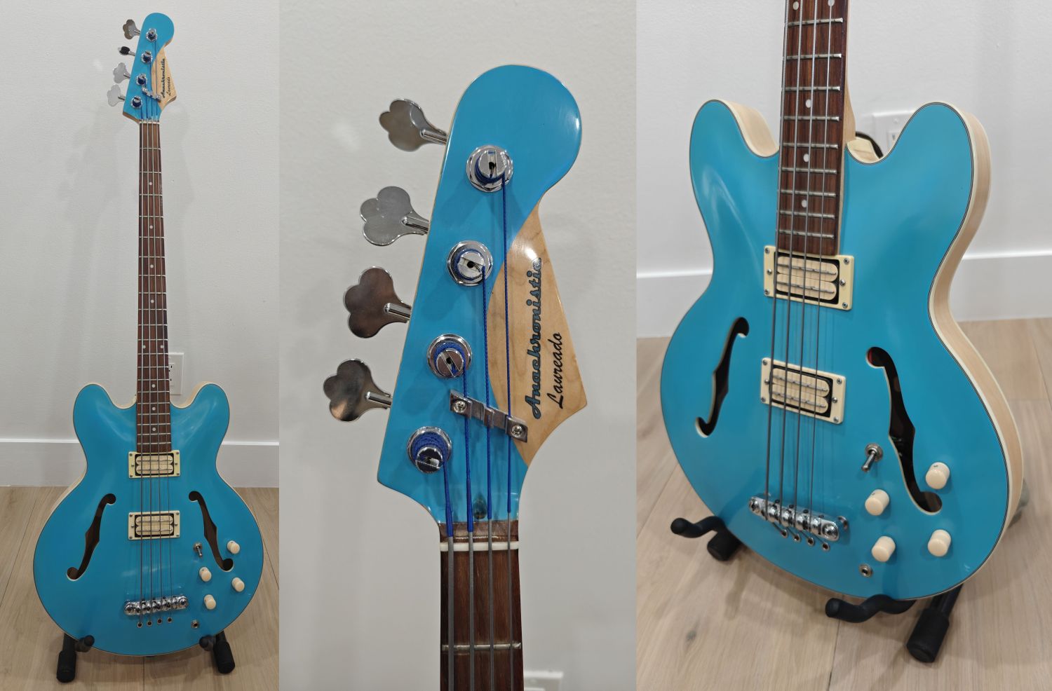

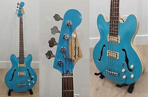

    Finally finished! It fought me until the very end. Last problem was that a chunk of wood I had glued against the center block was just wide enough to keep the jack from fitting. Fortunately this was fixable by using a thin chisel through to hole.
    It sounds great! The pickup in the mudbucker position is nice and dark, but not muddy. The one in the middle position is very p-bass like. It has four distinct humbucking settings--the fourth is when both single coils are engaged.
    Single coil sounds are good, but there's a little buzz. But in any humbucking setting it's dead quiet. I used shielded cable in the wiring harness and that may have helped.
    Thanks to all who provided advice, counsel and moral support! I am very grateful for all of your help.Click image for larger version.

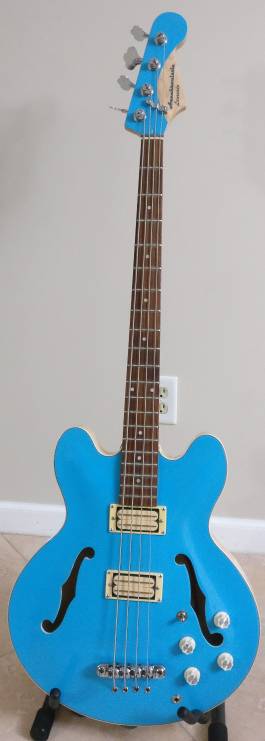

    Quick update with the "new" knobs. Not all that new actually...but hadn't gotten around to posting ;-) Took a while to find cream knobs that actually matched the cream on the bobbins and pickup rings. As a result of several failed attempts I have a large variety of white and off white knobs that perhaps I will eventually find a use for... The final set of knobs came from Xcentric Guitars. Even if you are not shopping for knobs it's an interesting site to browse...
