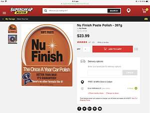

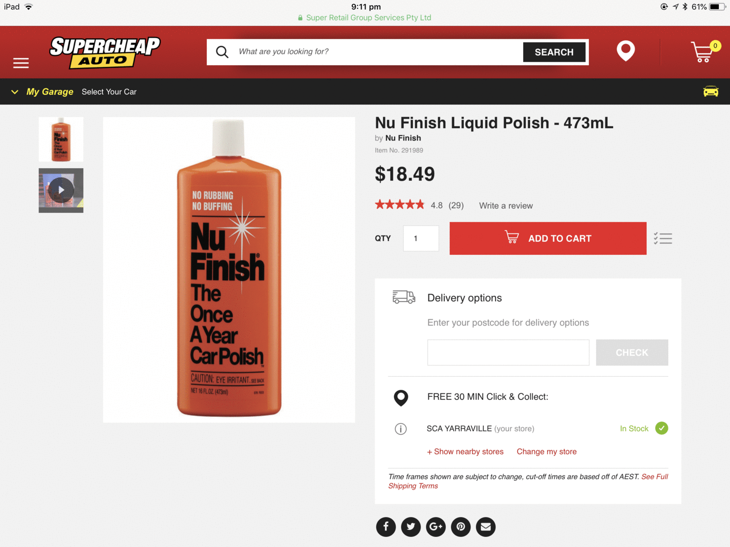

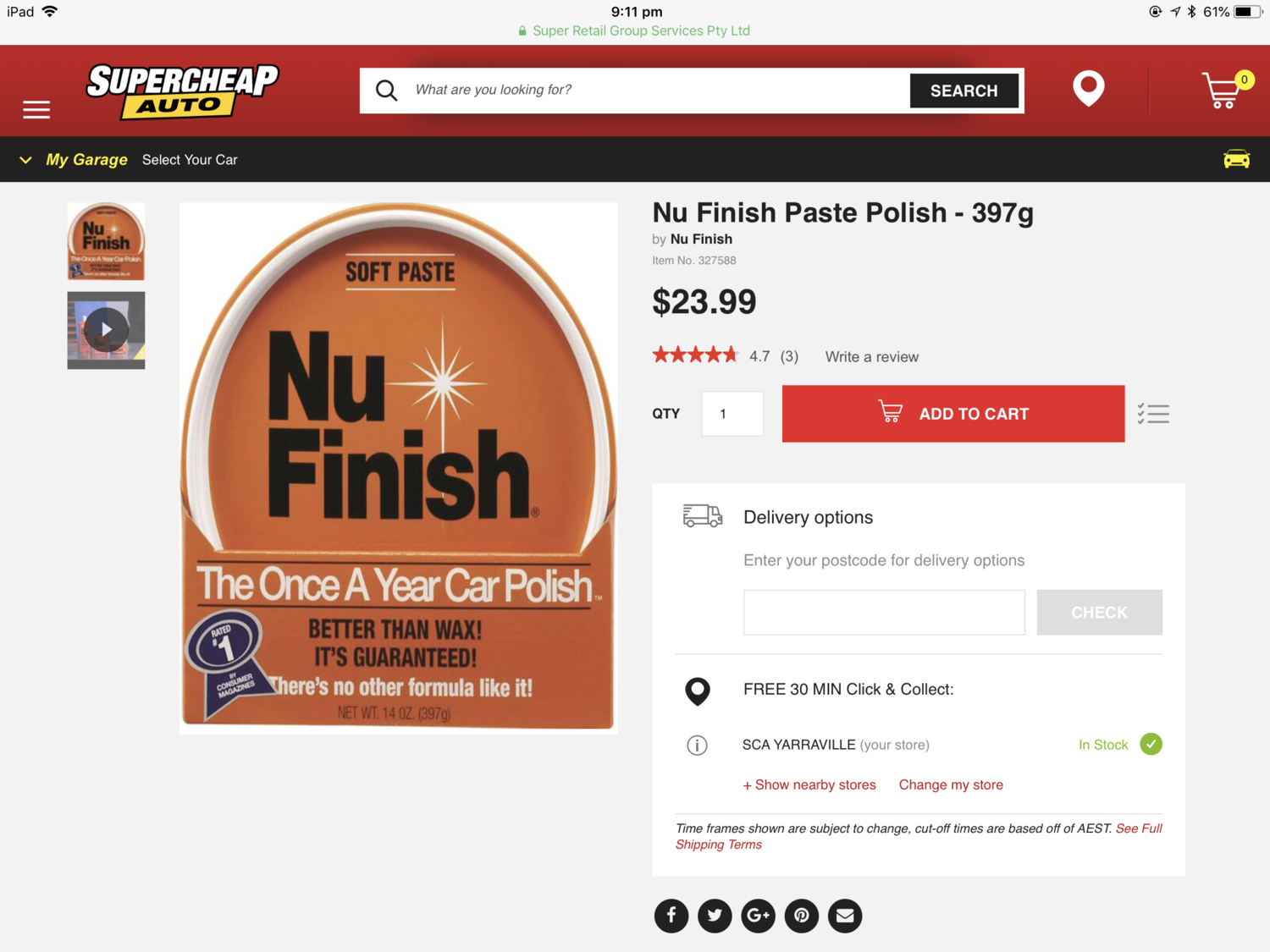

    What polish and/or compound do you all use to buff the gloss? Everyone recommends Meguairs Ultimate Compound followed by Ultimate Polish, but I can’t justify spending $60 on both together. Surely is there not a product with compound and polish in one, or can I just use one of the ultimate compound or polish without using the other?
    I found that people seemed to recommend this Nu-Finish Polish as a product which achieved both aims in one go.
    What are your thoughts?
