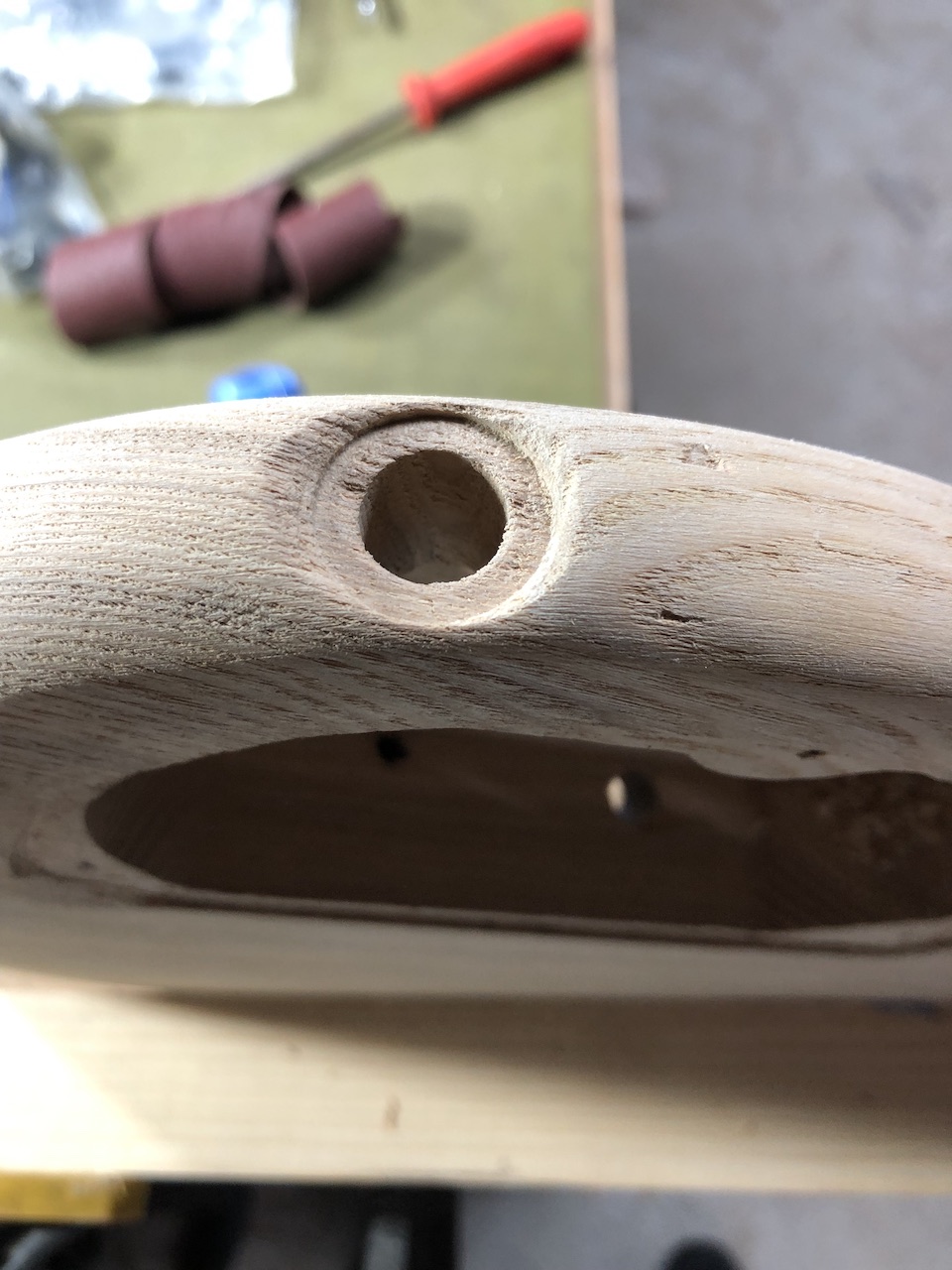

    So some additional work got done to recess the jack point.
    I set t up in my drill press with a 19mm router cutter and it did a serviceable enough job. I only wanted to get the jack itself flush with the curve of the body rather than protruding so the cut depth was only about 5 mm. I ended up with this.
    There was a little bit of smoothing off to do but the final sand will take care of most of the finish detail.

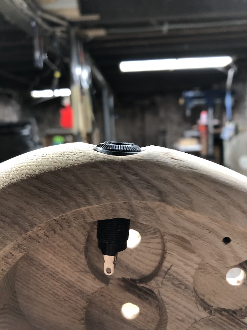

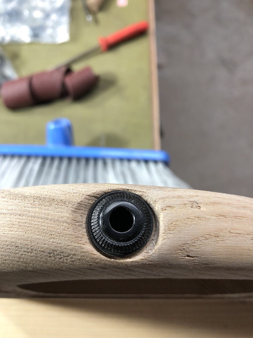

    with the Jack in place it looks like this:

    There was an existing issue with the pot placement, even with the mini pots provided, I think i can get around this by taking another 3mm in depth into the pot cut outs, but at this point there is direct contact from the jack barrel to the pot casing. at worst I could insulate one from the other but i will see what els could be done.
