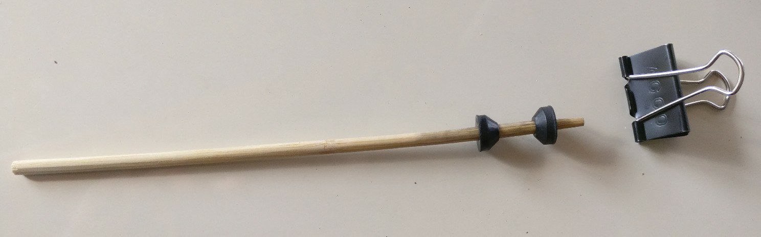

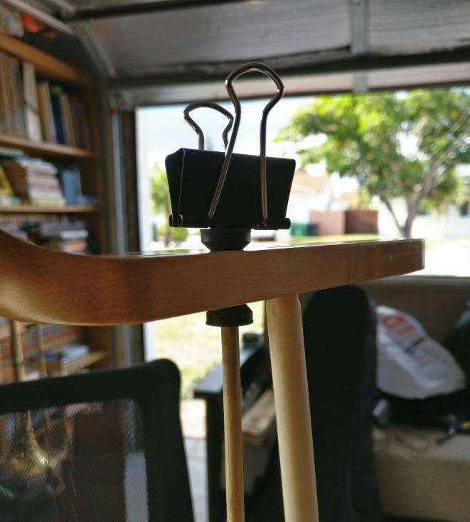

    3,020
    I would like to be able to do the whole neck at once and not wait. It's a sort of a time thing in that the finish does best if it goes on in two hour intervals.
    I like the McCreed jig, so I decided to copy it, but I wanted to be able to flip the neck with one side still wet.
    So I added a flipper. After several failed attempts I came up with this flimsy looking thing. A chopstick, two conical washers and a medium spring paper clip.
    Believe it or not the paperclip holds the washer in place well enough for me to be able to flip the neck holding the other end with just the pressure of my index finger against the truss rod screw (which is in the heel of this neck).
    A bit Mickey Mouse, but seems to work.
ID:	34373Click image for larger version.
    BTW don't tell anyone about this. My wife thinks I am cleaning out the garage...which I am...I just got distracted.
  6. #26
    Necessity certainly is the mother of invention!
    I realised I should have used the phrase "touch dry" in my earlier post regarding the flipping question. (I think I'll go back and edit it when I'm done here)
    I also should have mentioned the when I do flip it, I use a short piece of 5mm dowel through a tuner hole to minimise touching the headstock (similar to your idea but not attached).
    I'm able to handle the heel end well enough and avoid any significant marking on the finish.
    If I'm using lacquer, it flashes off really quickly, so time between coats is really short. With poly it's longer, but because I'm spraying lots of very light coats, it's only about 1/2 an hour.
    Glad you found a system that will work for you though!

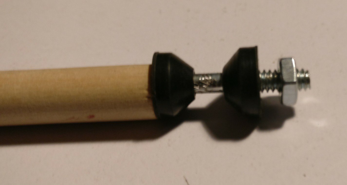

    Found a threaded rod with screw threads at one end, and bolt threads at the other, and decided to make a better flipper.
    It sounds like the finish is am using is s bit in between. Not sure it's the best finish ever, but it finishes hard, doesn't change the color much and I know basically how to use it without major mishap or accidental poisoning. Plus I own some...Click image for larger version.
