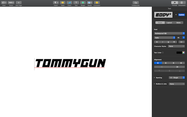

    I found the perfect font for my guitar. It's called Bulletproof. I'm having trouble uploading a sample at the moment and will share asap.

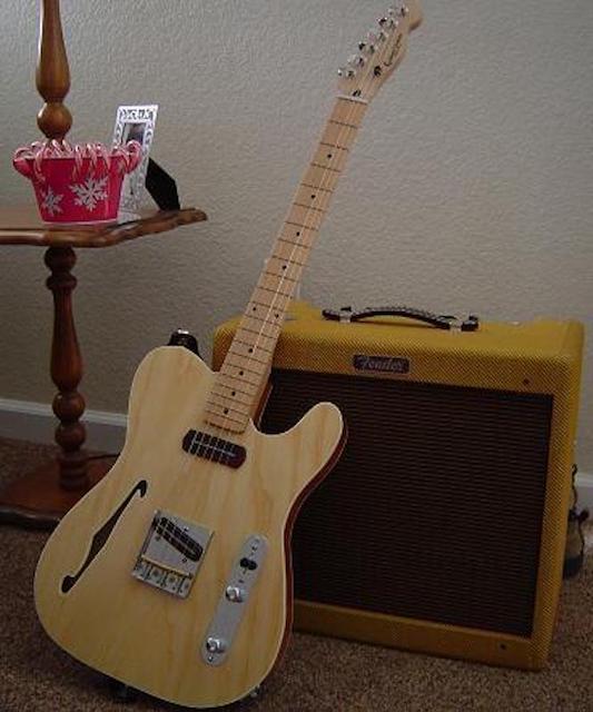

    My plan has always been to do a simple Tru-Oil finish over the quilted maple veneer, similar to this guitar. Recently I began to wonder if it would be possible to do a very light, water based stain to help bring out the beauty. Has anyone tried this and if so what were the results?
    Last edited by TZK321; 21-07-2019 at 06:49 AM. Reason: forgot to add 'similar to this guitar'
  5. #24
    Jan 2019
    Shanghai, China
    233
    Here's the font for the decal.
    I also did a bit of research regarding staining maple. From what I've read an oil based gel stain is the way to go. I think I'll just keep it simple and use only Tru Oil. I've heard that over time the color will change and hopefully add some character to the quilted maple.

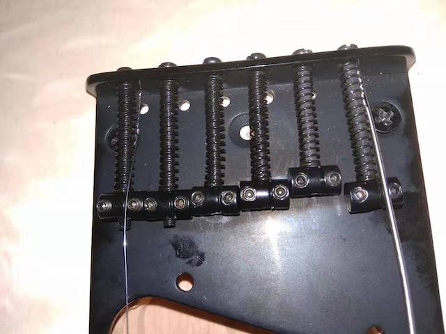

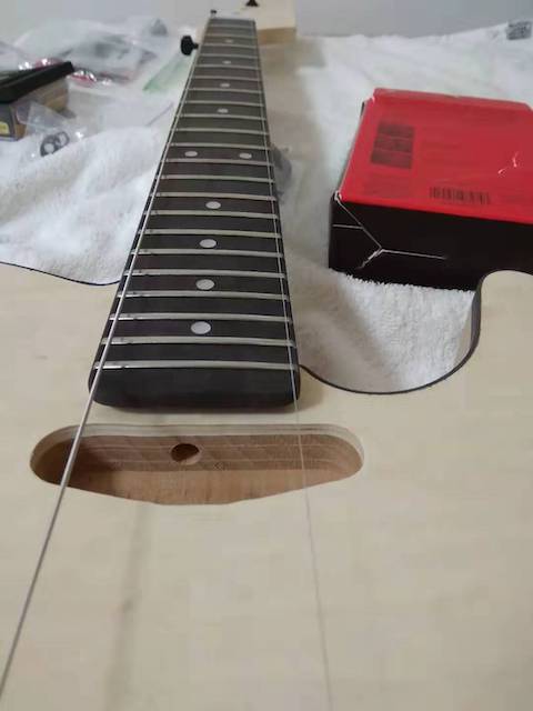

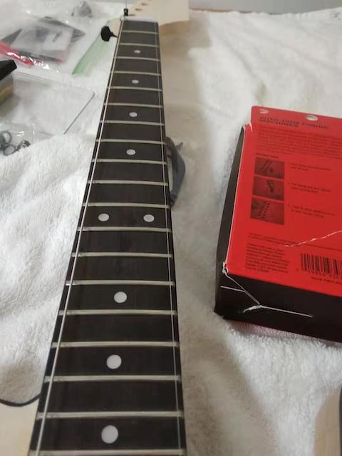

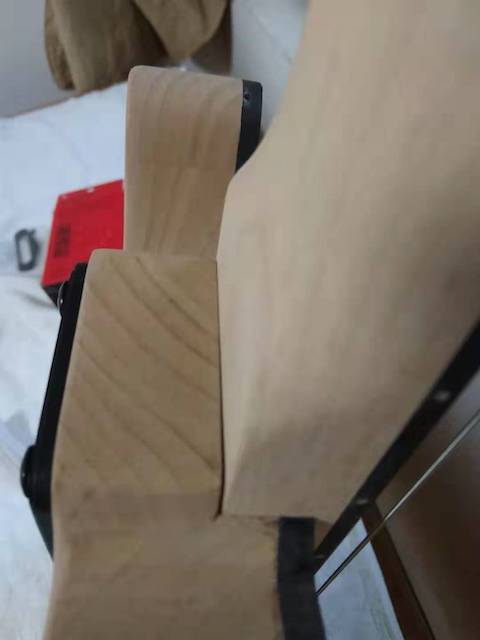

    I'm back from vacation and that means I can start work on my kit. I requested that the factory drill most holes for me. I want to make this first build as easy as possible. I screwed the neck into the body to inspect. There's a very slight gap on one side. Is this something to be concerned about.
    Next I screwed in the bridge and checked that the neck was straight. It looks fine to me but I'd appreciate your guys' opinion. Honestly I'm not sure I'd be able to tell if there was a problem.
    Lastly I checked the scale length. I hadn't noticed before that not all of the adjustment screws are the same length. I might need to get some longer screws to properly intonate. Some of the screws are at the limit - if I unscrew much more the saddles will fall out.

  10. #29
    I'd check the squareness of the neck heel, then check the coners of the neck pocket for burrs or little remanants from the routing.
    Sometimes there can be a little step in the corners that props up the neck to leave gaps like that.
    You may also just want to check that the fllor of the neck pocket is even and level and that the radioused corners of the heel and the pocket fit properly, particularly in the very bottom of the pocket Radii.

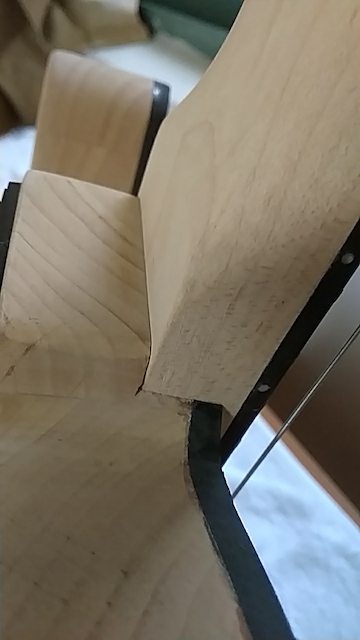

  11. #30
    Jan 2019
    Shanghai, China
    233
    That's much better now. No modification required. It was just a matter of tightening that top-right screw first.
    Does everything else look ok?
    I think I'm ready to customize the headstock.
