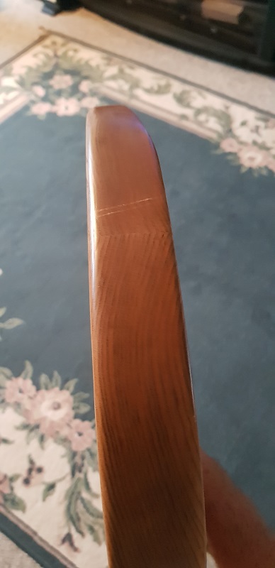

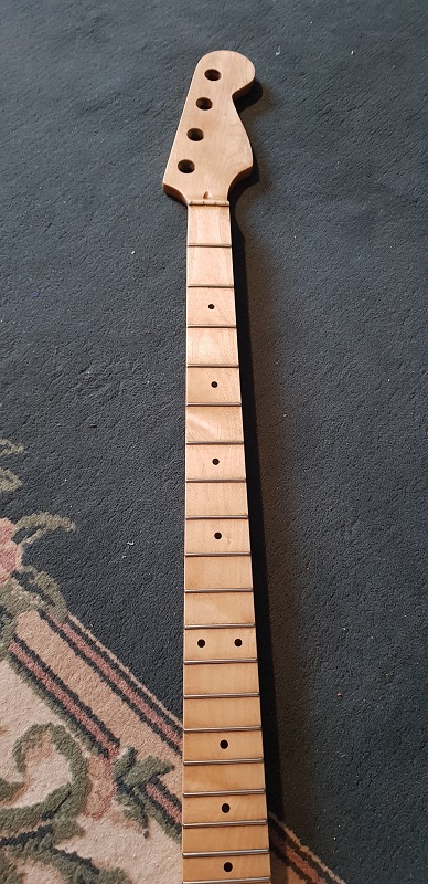

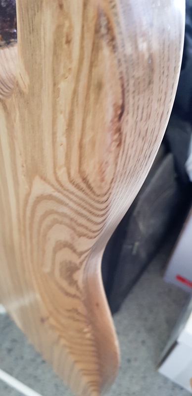

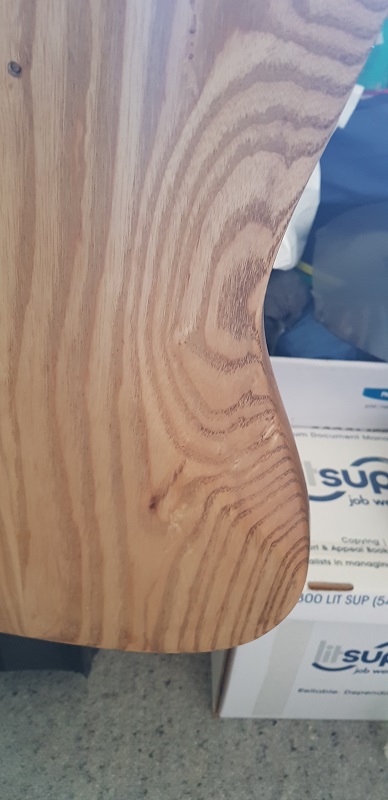

    Two coats of fine buffing oil.
    I have sanded and timbermated (is that a word?????) all over...body...neck...fingerboard.
    Not one hundred percent happy with the headstock....but it matches the template I have pretty close.
    This pics taken just after the application of second coat of Fine Buffing Oil......leave to get tacky then hit with a coarse rag....leave for five hours and then buff with a soft rag....it cleans up very nicely.
    It is applied with steel wool...so you get the little black lines from the shredding steel wool....but they buff off pretty well.
    Some more dry and buffed pics this afternoon.
    Back to work again tomorrow. Roster change....so not gone ten days now.....four days away for three days home....more guitar work.
    Look close at the body front and back....some serious bug/worm/weather damage lines on these pieces of wood....they have a nice 3D effect to them.

  2. #22
    Mentor ozzbike's Avatar
    Sunshine Coast, Queensland
    1,109

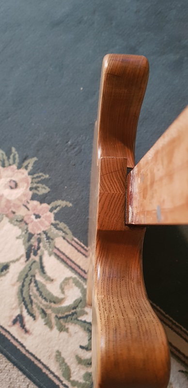

    ...couple more.....
    The neck looks bland and has no flame or grain much at all.
    The front of the headstock has some growth circles as if the neck was cut flat and not in the quarter sawn manner.

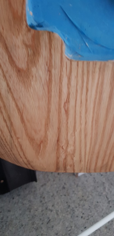

  5. #25
    1,109

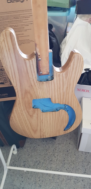

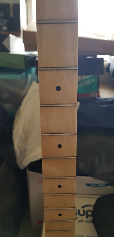

    Four Coats of Fine Buffing Oil.
    I have done four coats of the fine buffing oil. The neck feels so smooth and has a creamed honey appearance to it. I am noting a few spots of wax build up on both the body and neck. I think I will let it hang for a few days and then buff it out....before making a choice whether I put any more coats on.
    Honestly, I think the neck is done.....hang....solvents gas off....then wax a few times.
    The body has a few spots that could benefit from more Fine Buffing Oil. I think I may work towards the seven coats I did on the last one I used Fine Buffing Oil on.
    The nice smooth and natural finish under the hand is amazing.

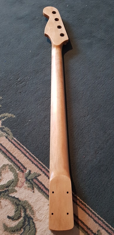

  6. #26
    1,109

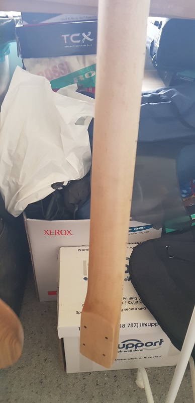

    ....and the neck.....
    Some nice necky pics......and one of the bum.

    The seven coats of Fine Buffing Oil are done.
    Wow this one has gone fast. The body and the neck/fingerboard/headstock have now all had seven coats of the Feast Watson Fine Buffing Oil.
    They will get the coarse cloth buffing and the fine cloth buffing later today and then hang until my next group of days off.
    I like the figure in the body, and even the neck looks good. But I have to say WOW the neck feels so smooth. It is not polished and buffed wax smooth....but very silky and naturally without grip. I like this semi-gloss sheen finish.
    The body pics.....
