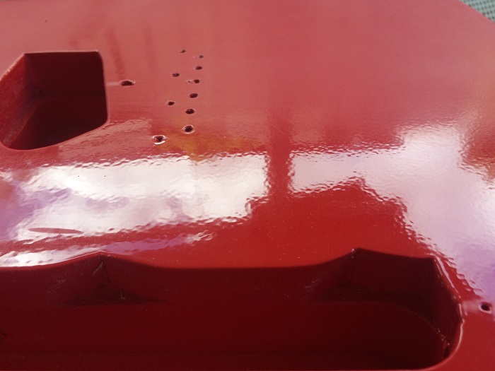

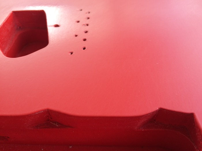

The top of the guitar. I start with a fine Brad Point Bit for its accuracy and then drill a hole about half way through the body with a regular bit. The tricky part is to drill the 2 outer holes all the way through the body. Make sure the drill is as vertical as possible. This is where a hand drill is preferable to a power drill as a hand drill does not “get away” from you like a power drill. Ask me how I know??

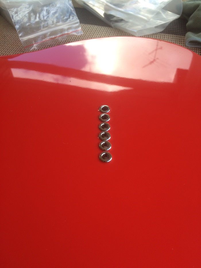

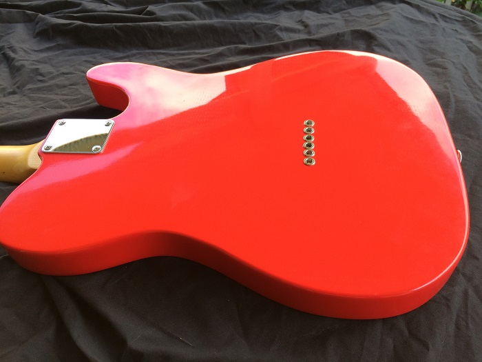

The back of the guitar. This is the important part. With the 2 outer holes already drilled through to the back, all you have to do now is space out the remaining 4 holes and drill them though until they meet up with the holes you previously drilled through the front. They don't have to line up perfectly with the holes from the front but as long as they are spaced out fairly evenly they should look OK.
Obviously the holes in the back are larger as they have to take the string ferrules, so I find a Brace and Bit is a better way
to drill these holes.
