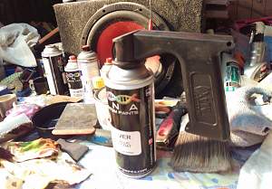

    Yea Weirdbits is right, i used a bit more expensive spray can handle, essential if you are using a lot of cans, what it does is stop you from pressing the nozzle forward where the spray can hit the top of the rim, causing the blobs.
    It cost about $15 au.
