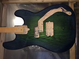

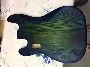

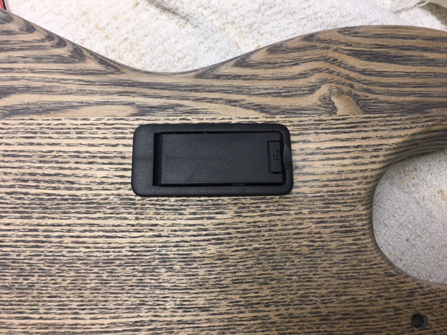

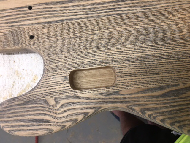

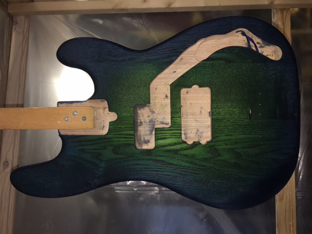

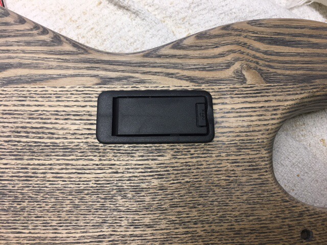

    Ok got some work done on the bass today after I ran my first 5k race.. I got the battery box router out and had to make some adjustments to the control cavity to fit the active preamp controls. And I got the first coat of trans fast dye on looks like it coming out pretty good..

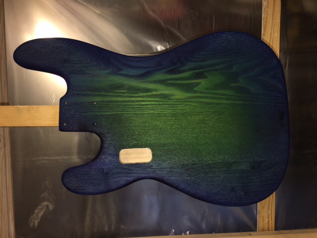

    Here is another pic of the color.

  6. #26
    DD, that colour is epic! Its like the effect you get on Beetle carapaces, multi hued and slight shimmery. Wonderful stuff!
  7. #27
    Thanks Franken,, I wanted it to somewhat match the tele build..

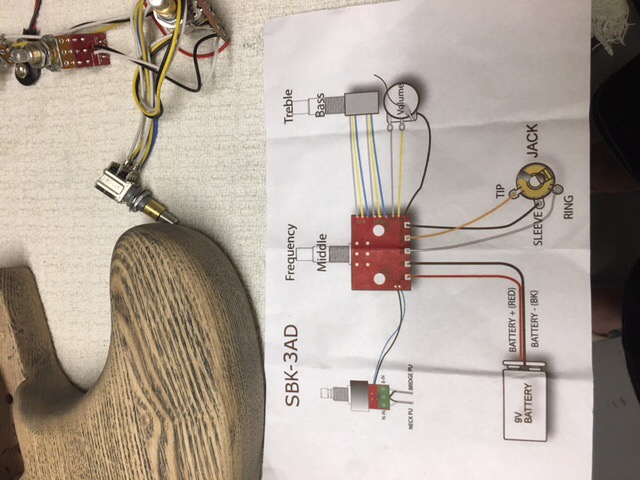

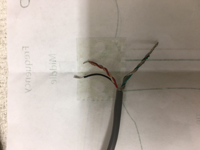

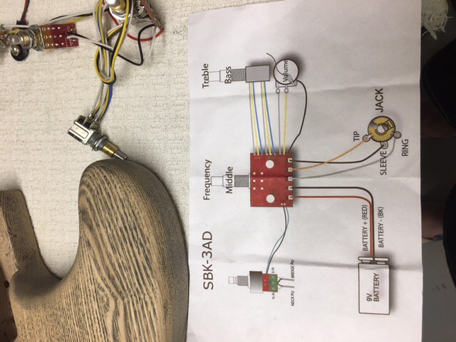

    Ok I need some advice and wiring help from you experts. I have purchased a preamp kit for this from tone monster and it has a. I solder connector for the two pickups. I have seen people wire these dual humbucker musicman style pickups so they can switch between parallel and in series ...I think. Would it provide any additional tone or flexibility if I installed a switch so that I could switch the rear pickup and how would I wire it into his setup.
