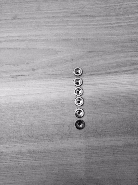

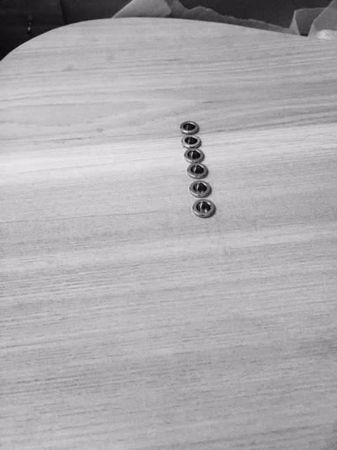

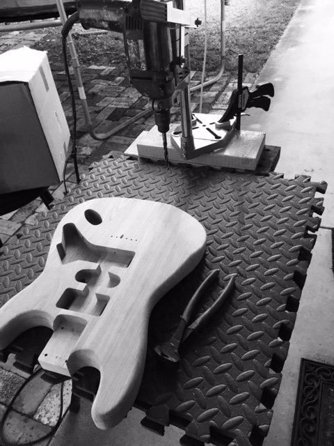

    As with my mantra, all mods are completed before sanding etc.
    ....aaaaand as its a string through, time to roll out ol' snaggletooth

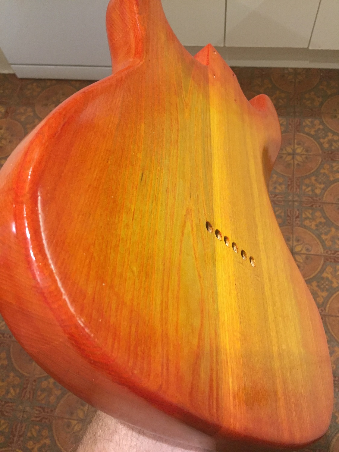

    not my best work but, as its mine...it will do
ID:	15795Click image for larger version.
  8. #28
    Did you drill all 6 holes all the way through from the top? I'd been told to just drill the end two holes all the way through, and the other 4 most of the way. Then on the back use the bridge plate to mark the centre positions for the centre 4 holes using the two outer holes as a guide, and drill those 4 holes part-way through from the back. Almost guaranteed to get a neat line of ferrules.
