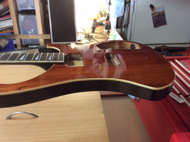

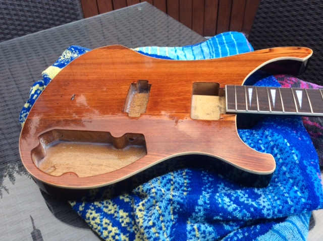

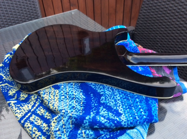

    Just polished up the face. Came up nice and glassy, although there are still a few tiny pits. Can't complain after what it looked like at one stage.....!

  3. #23
    great save!
  4. #24
    That's coming up nicely.

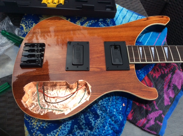

    Just done final polish, very happy with it.
    Ready to start installing all the bits.......

  6. #26
    SHIIIIIINYYYY! You have to be happy with where you've taken this one Andy. That's a great save all up and that gloss, well,
    I know I'm repeating myself here, but .....SHIIIIIINYYY!!!
  7. #27
    nice one Andy whatever you did it looks great !
    that plastic nut looks very high so will need the slots lowered or bottom of nut sanded
  8. #28
    Mentor Andyxlh's Avatar
    1,206
    Thank you! It's a polyurethane clear.
    You are probably right re the nut Wokka, I'll try the strings that came with it on when I get it together, and work from there. A nice brass nut would suit it I think?

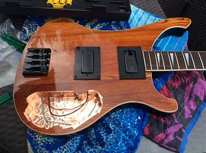

    Bit more work while watching the Lego Movie with my son....

  9. #29
    looking good Andy, yes a bone or brass nut will make it play much nicer for sure. Also the bridge saddle heights are probably different to the kit supplied bridge so you will have some setup tweaking to do
  10. #30
    1,206
    Yes I think the bridge saddle heights are too high. I'm planning on having to grind a little off of the bottom of them to allow them to sit lower in their slots, but I'll get some strings on it and get it up to tension and let it sit for a few days first.
