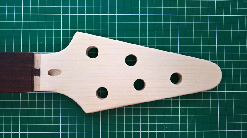

    small problem by exposing the channel that the truss rod runs in. I'll probably just put a small piece of veneer over the spot and try to make it invisible.
    Attachment 16319
    Make up a truss rod cover out of some sort of plastic that starts at the nut rather than the chamfer

    It's not going to be easy to make a truss-rod cover as the headstock's quite curved at that point (unless it was a very thick one that had enough depth to incorporate a curve). You don't want to flatten the curve of the headstock as this would thin the neck at a structurally weak point. So I'd have thought that you just run the veneer up to the nut and cover up the gap that way. You wouldn't want to stop the veneer short of the nut as you'd have an obvious line.
  6. #25
    There should be some scrap left over from the bit of rose wood that was removed that you could use it in front of the 'Adjust-A-Nut' to cover the exposed truss rod channel.

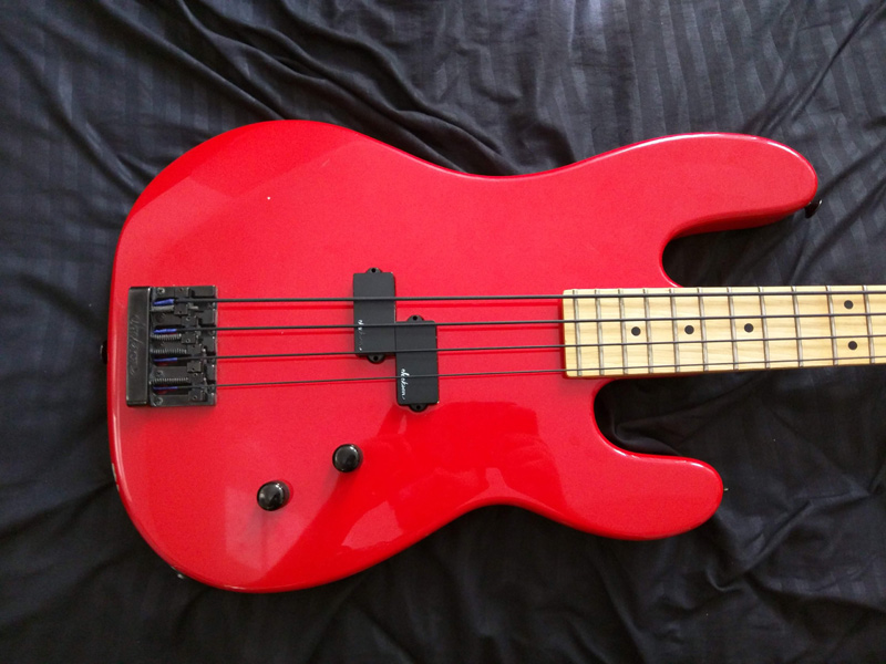

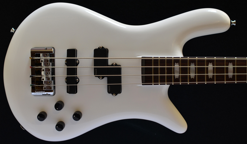

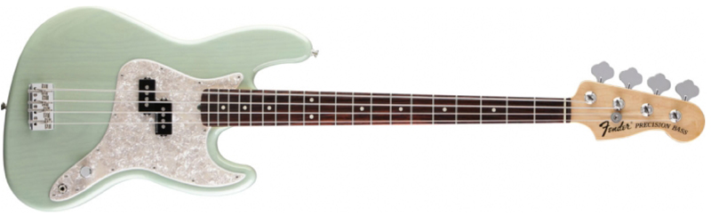

    A question for the brains trust ...
    Has anyone had experience with playing around with the orientation and placement of the split pickup on a P-Bass?
    I'm thinking that I have the opportunity to experiment with how the pickups are positioned, since I haven't actually routed the body yet.
    I've read that swapping the pickups around gives you a warmer top end and a tighter bottom end, but wondering how true that is ...
    What do you think?
    ... any advice/wisdom would be very welcome!

    Most of the early MIJ Yamaha BB bass's have the reversed P setup, and they are quite highly regarded (esp.up to about '85) - I've got an old '79 BB800 with this layout and it sounds so very very right (shame my playing doesn;t do it justice but anyway).
    Apparently having the p/up closer to the bridge improves the treble response and visa versa so having the E/A string pickup closer to the bridge than the D/G one evens out the sound across all 4 strings.
    Whether any of this actually makes any real difference to the noise you make who knows - but the reversed P setup certainly doesn;t hurt things

    Certainly with a 5-string, reversing their relative positions should have the beneficial effect of making the bottom B string less woolly sounding.

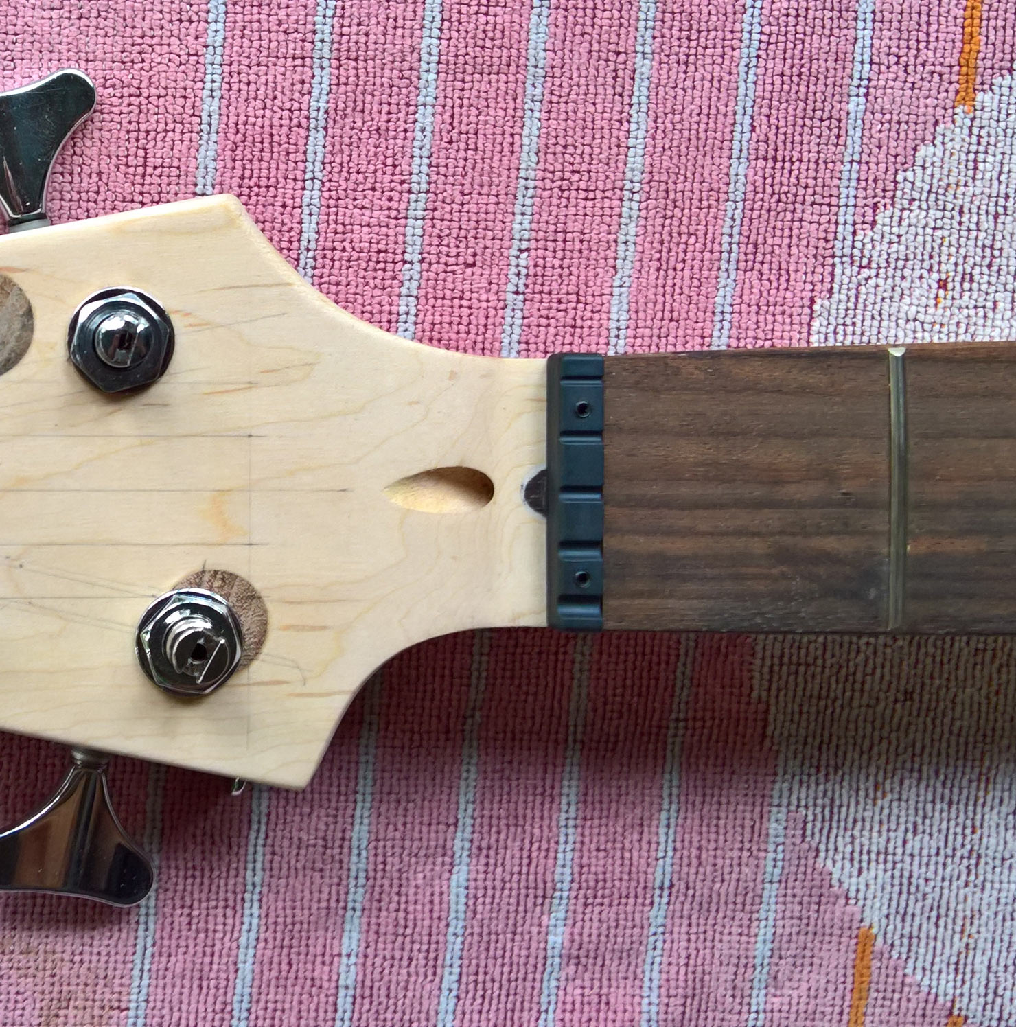

    Quote Originally Posted by ThreeBbass View Post
    Hi Simon,
    I've got a Warwick nut that I'm using with this one. I removed the old nut and all the material behind it, but left myself a small problem by exposing the channel that the truss rod runs in. I'll probably just put a small piece of veneer over the spot and try to make it invisible.
    Attachment 16319
    So I've finally sorted the top of the headstock and fixed the truss rod channel problem at the same time.
    I ended up getting a thin piece of maple veneer to cover the whole area and then sandwiched it with some foam packing material between the clamps to force it to follow the shape of the headstock.
    It worked pretty well, although there was a small split in the veneer, which I filled with TimberMate.
    Before
    Attachment 16311
    After
ID:	16893 Click image for larger version.
    Now for the sanding and finishing part ...
