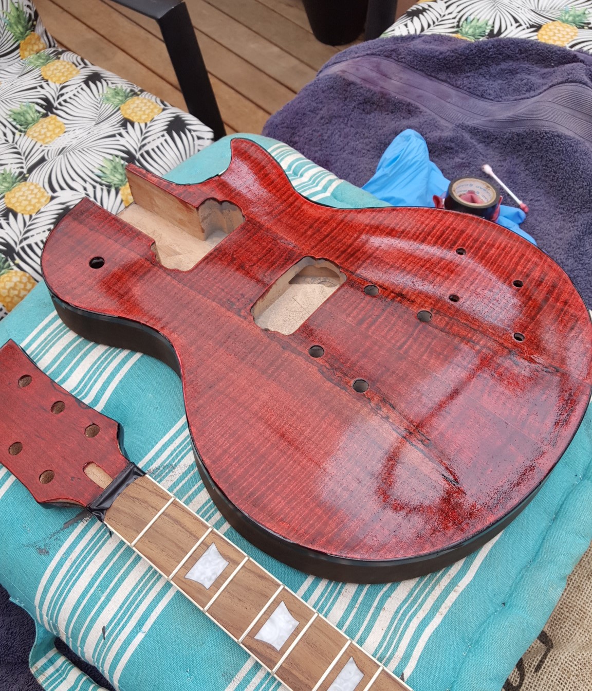

    Quick update. Guitar is coming up well.Click image for larger version.
Name:	guitar update1.jpg
  8. Liked by: wazkelly
  9. #28
    2,804
    Very nice indeed
  10. #29
    Moderator Brendan's Avatar
    Apr 2013
    3,444
    Looking great Josh - nice and shiny!
  11. #30
    Nice colour and shine looks great
