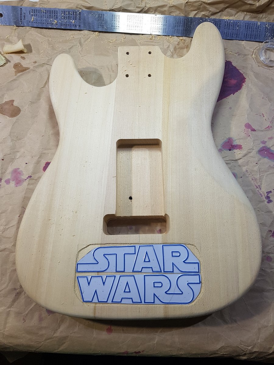

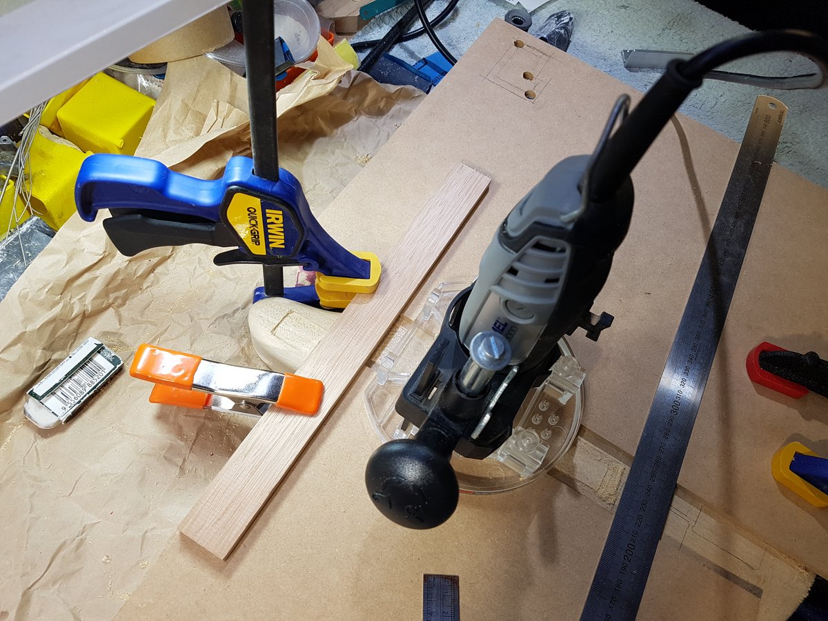

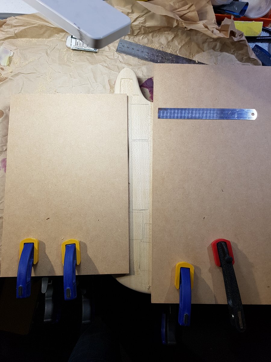

    So a bit of progress today. I went on to create recesses for each plate.
    I first marked where each plate was going, and then used MDF sheets to build a jig to guide the dremel plunge router base.
    I started by only using guides for the long sides, but of course got carried away in one spot and went past the line, so I ended up using guides on all 4 sides:

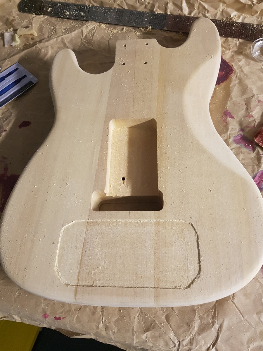

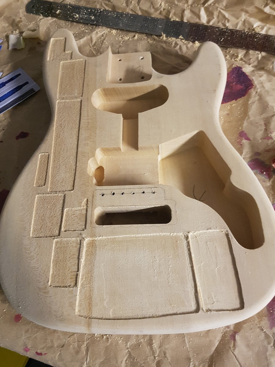

    Was pretty tedious and took a long time, but got there.

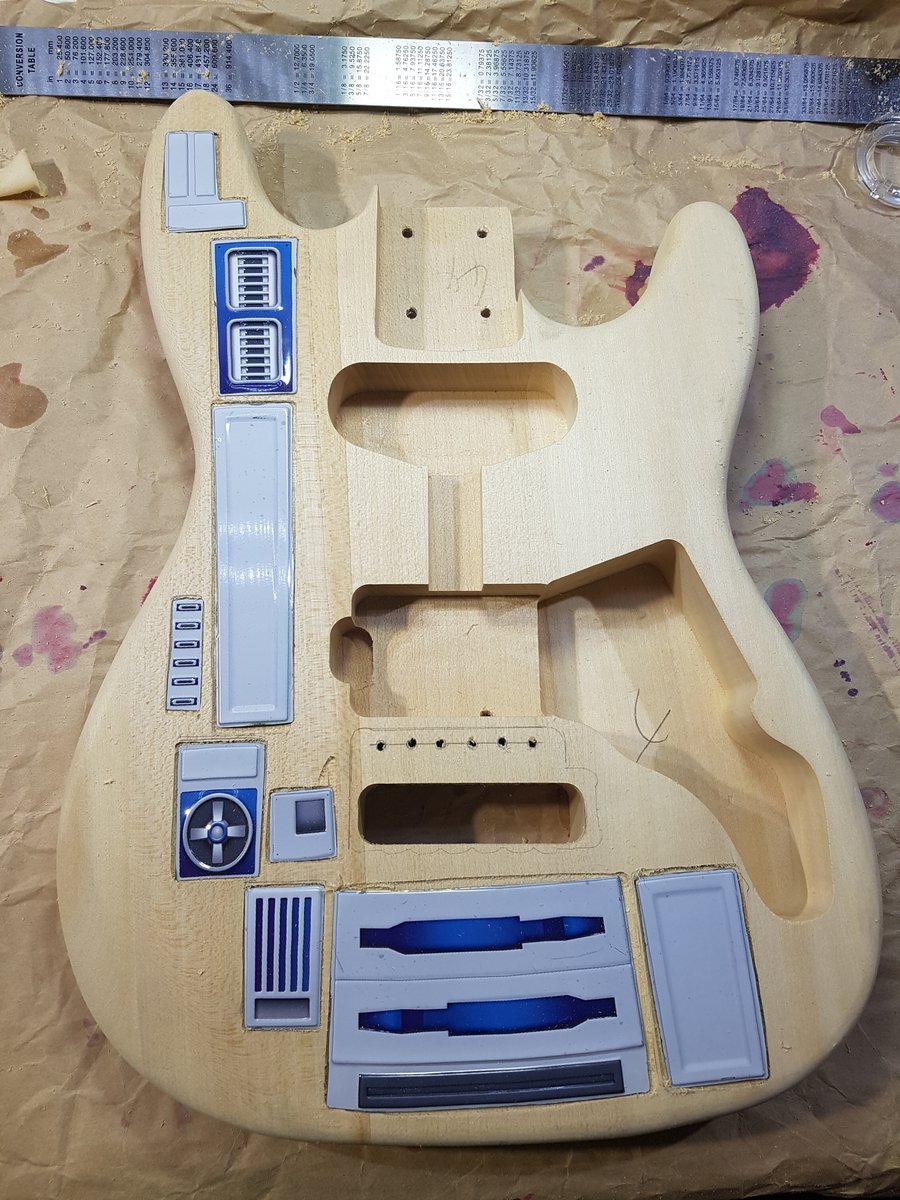

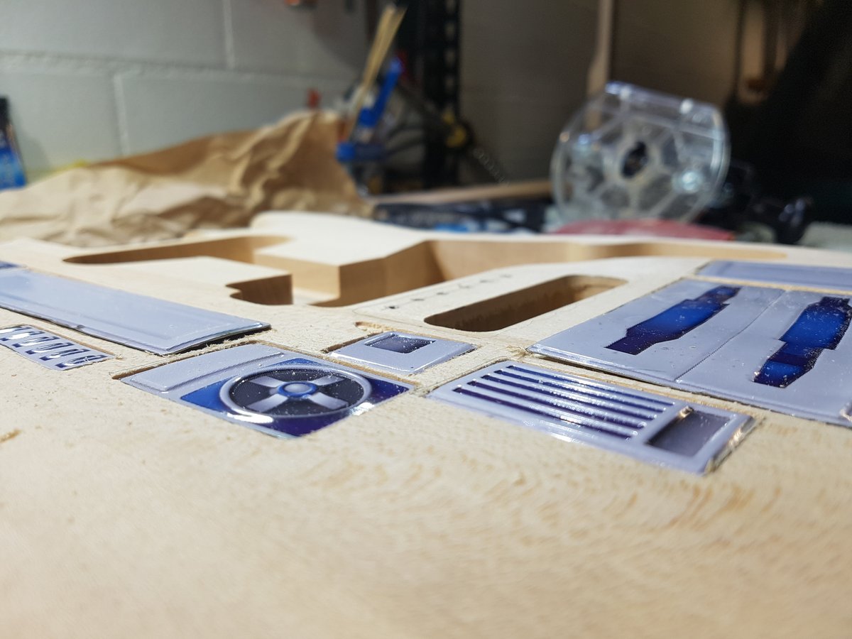

    Looks okay with the steel plates, it will keep the edges lower than the surface so I can seal around each plate:
    Nest step we'll have to clean the edges, but that will be part of the overall sanding.

    I've been thinking that a dremel might be something I'd use, and now I know it will be. What model do you have?
  9. #29
    Mentor FredA's Avatar
    Sep 2015
    Surry Hills, NSW
    500
    I've got the Dremel 3000 with the flexible shaft. $128 from the green shed.
    I also got the plunge router attachment. Some on the forum say that the StewMac plunge router attachment for rotary tool is much more stable (http://www.stewmac.com/Luthier_Tools...uter_Base.html).
    I can't comment as I've only used the dremel one, but it does look a lot more solid being all metal.
