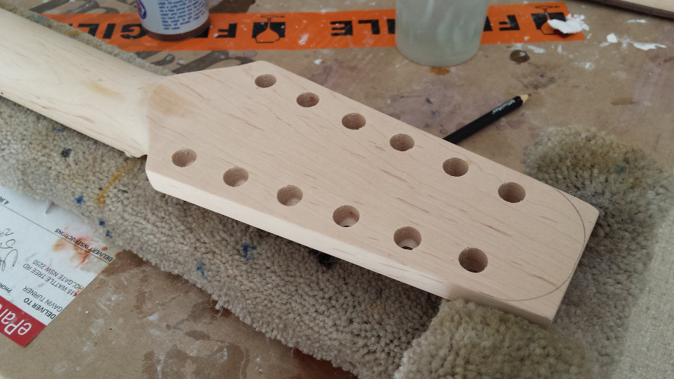

    Great looking build Gav, spectacular finish! The only critique would be the headstock shape. Is that what it came with, or was it a standard paddle shape? I guess I'm used to seeing the standard Fender shaped headstock on these guitars that this looks slightly out of whack being so symmetrical.

    Thanks Zandit. Thing about the headstock was it came as a paddle but with very little room to move at the top. I wanted a "Fenderish" look, but with both sides taken up with tuner pegs I was at a loss. In the end I settles for a simple rounding over because it was as close to the Tele rounded end as I could get. Probably more was possible, but my limited imagination couldn't get there .
    Personally I love the full jangle so haven't experimented with losing strings here and there. Definitely something to consider int he future! (probably with the next 12 string kit :P).
    I see what you mean, it didn't give you a lot to play with! I would have thought you'd get a larger, squarer paddle like a G series head stock.

    A shame it wasn't an undrilled headstock. Then it could have been made narrower, with the added benefit of straight string pulls from the nut to the tuners, plus the opportunity to make it a bit more Fendery.
