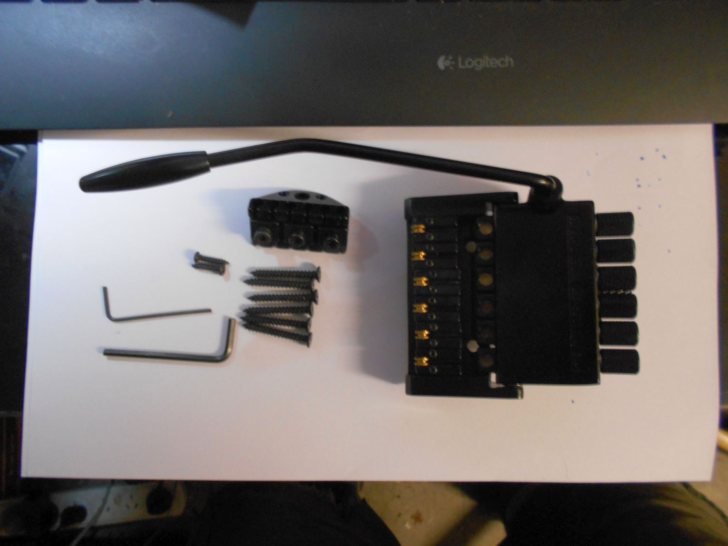

    Yep, turns out I was spot-on, it is the new bridge, what's more, it seems to be of a much better quality than the original Overlord Of Music bridge, not only that, I only have to make some minor mods to the original body routing to accommodate the new bridge because it is almost a drop-in fit, one of my concerns was that the mounting screws for the new bridge were going to be a bit too long for the body, but I did a quick test fit and they're fine, each saddle has it's own set of two height-adjustment screws, so what you do is you first set both the 17th-fret action, and the string intonation, then you lock the saddles into position with a small allen-screw located on the left-hand side of the bridge, you can then do some fine-tweaking of the string heights like you would on a Fender Stratocaster, here's a pic of all the new bridge-hardware I received in the parcel, each string saddle has a small brass roller, this is to ensure good return-to pitch for all the strings after using the whammy bar, I also noticed that the bridge-locking lever was much more solid and substantial too:

    The only issue I had with the new Bridge Hardware, and it was a very minor one, was that the allen key for locking the saddles into position was missing, fortunately I happened to have an allen key that was the right size to do the job, overall, I'm much happier with the new Bridge Hardware, it even came with a trem arm that seems to work better too.
    So, this Headless Guitar build project is officially taken off the shelved projects list and it is now a go-ahead, al that needs to be done is to do all the finishing work on the body prior to installing all the pickups and etc before final setup/and stringing, stay tuned for more updates.
