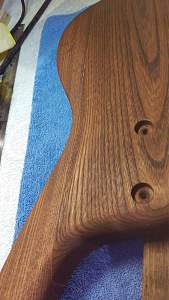

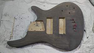

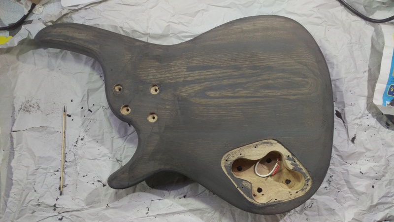

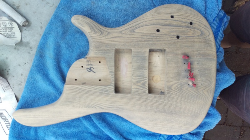

    I got the grain filling done. I loved how the ebony timbermate made the grain pop on my STA1M, so I used the same process for this one.
    Photos with ebony grain filler just dried:
ID:	7255 Click image for larger version.
    And sanded:
ID:	7257 Click image for larger version.

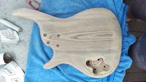

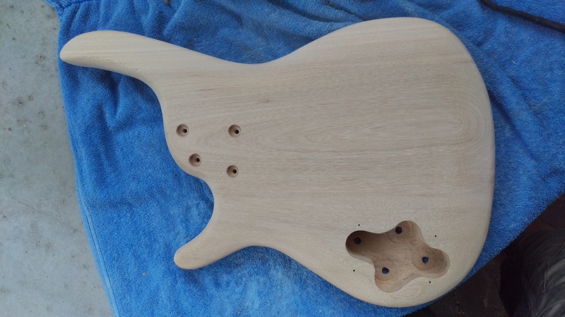

    And just for comparison sake here's a photo of the back before grain filling:

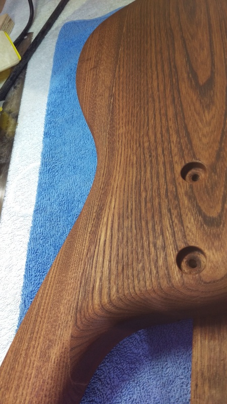

    I was then ready to start staining, so I started applying the Dingotone Dark Walnut stain today:
    I like it!
    It's not dark enough yet, but I'm planning to stain the neck, and then pretty much finish the stain bottle on the body and neck.
    I want the neck to be a bit darker than the body, but the neck maple is actually lighter than the ash of the body, so I'm considering staining the neck with the black colortone I've got left from the STA1M.
    Anyone knows of any issues with using Dingotone over colortone?

    I've done a test run on a small bit of maple left from the other guitars headstock and the DT didn't seem bothered.

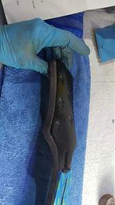

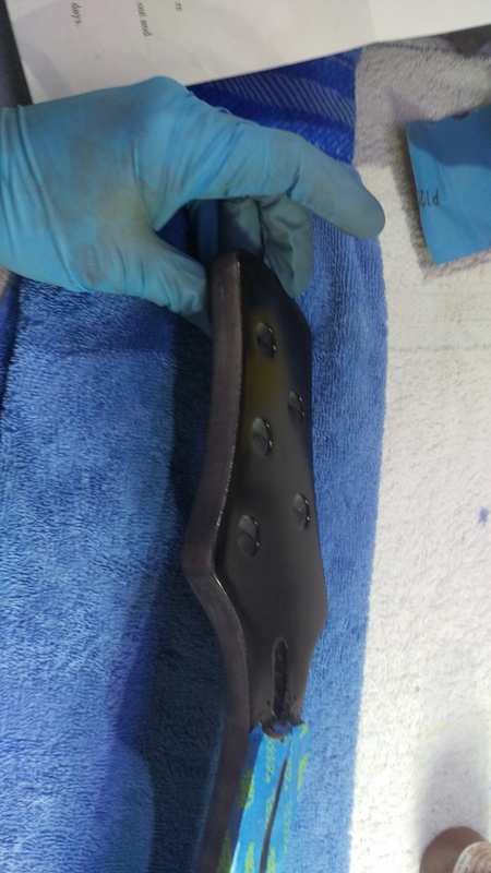

    So as mentioned, I sprayed the headstock black, nothing special to notice:

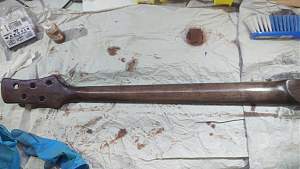

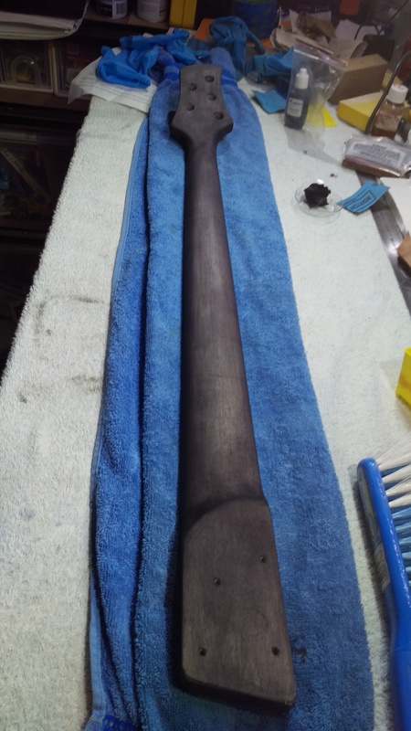

    I then stained it black with Colortone:
    Looked Okay.

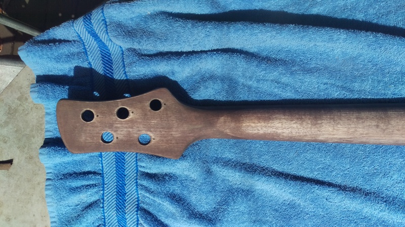

    I then applied the first Dingotone coat, using the same walnut stain I got for the body:
    I like it, but it is not dark enough, and now quite different from the body colour...
    It looks like the neck wasn't accepting the stain too much. It went in and was quite smooth, but the colour didn't pop.
    I wonder if it's not because I sanded the neck too thin (I sanded to 800) and that didn't leave enough grain to get the stain.
    Any of you guys have come across this before?

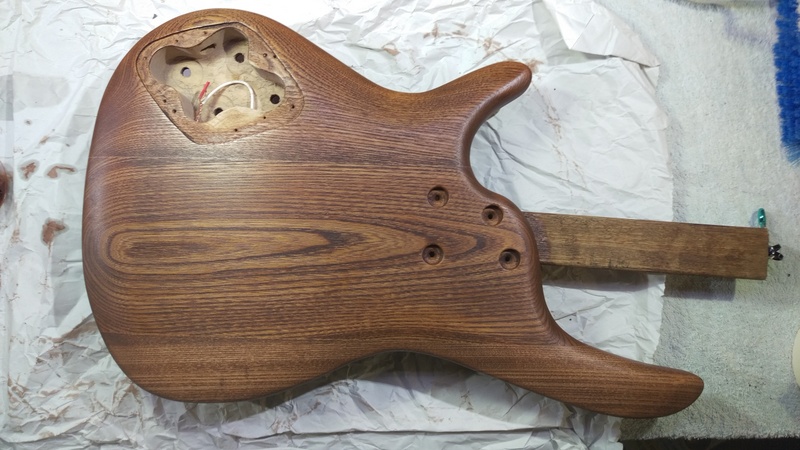

    I've got another issue/question, this time on the body. After staining the body with 1st Dingotone stain, I've got some pretty visible glue lines. It is where the planks have been glued together. Not messy glue spots, just very straight glue lines where the boards meet.
    See:
    Any idea on how I could hide /fix these?
    I bought the timbermate wax pen from the green shed, and I tried on an offcut, but because it's wax it won't accept any stain or anything oily on top. I'm wondering if I'm not going to use my son's brown colouring pens to try and mask these lines...
    Any ideas?
    Cheers

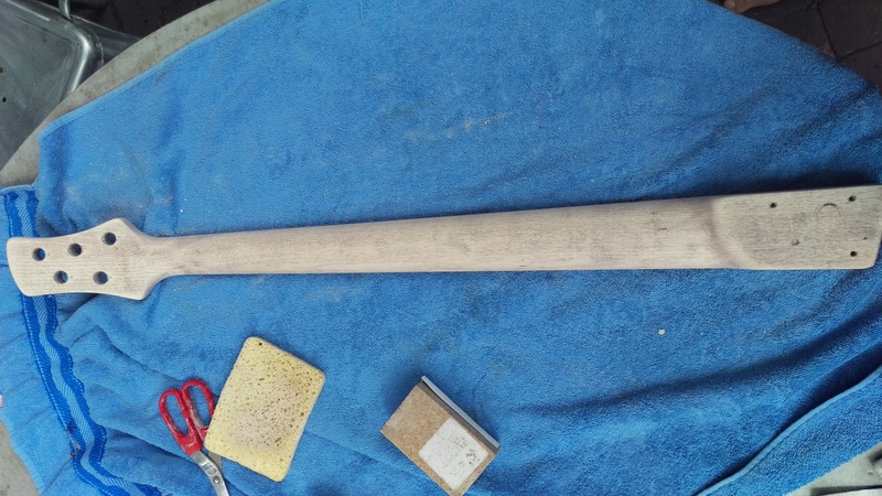

    After a few days I realised that the colour on the neck was looking pretty sh$$t...
    Must be the mix of colortone and Dingotone... It's become all patchy and the walnut colour just didn't take:
    So I ordered a custom set of Dingotone from DB, with walnut and black stump stain. I want to try to either mix them before application or just alternate coats of each.
    So while I'm waiting on that I got the 180 grit out, and we're almost back to before:
    DB advised to try and limit the sanding at 220 before applying the stain coat, so after I had it cleaned with the 180 I gave it a good sand with 220 and we'll try with that when I get my delivery...
