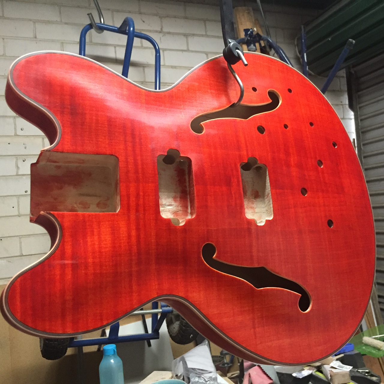

    Hi everyone.. So I'm up to my second intensifying coat and the colour is really starting to sing! Love it..

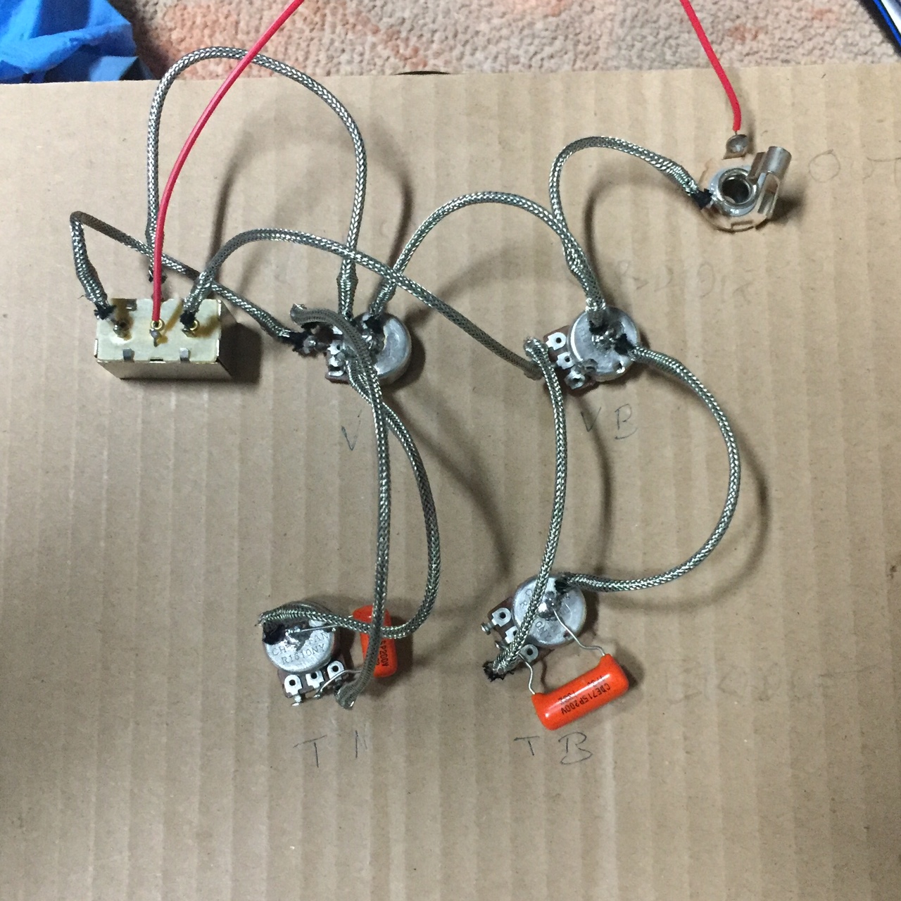

    I've also done some of the wiring (everything except the pick-ups).. Ran out of braided wire for the hot wire so have ordered some more..

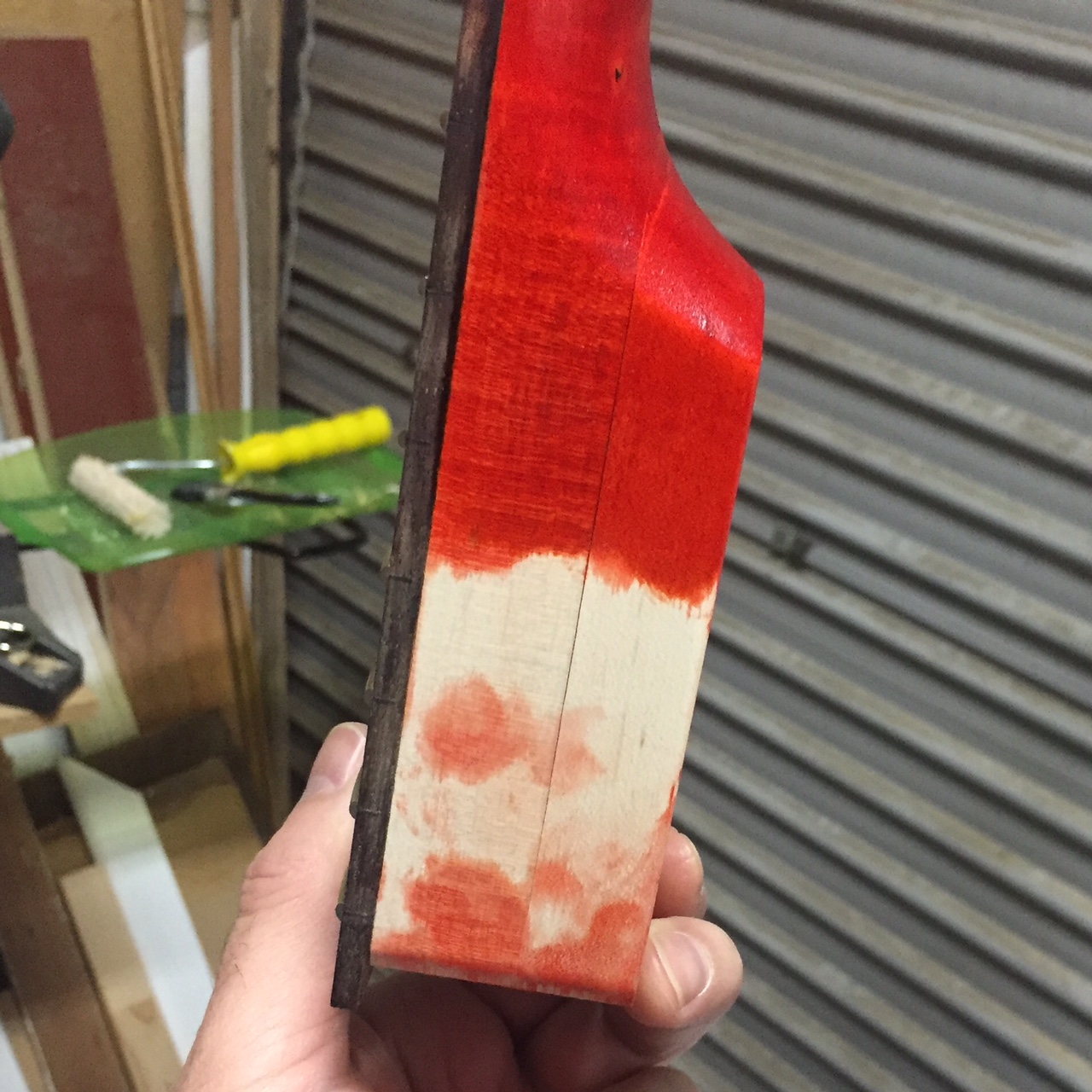

    I have a little concern with the heel of the neck.. as you can see in the pic there's a crack that has formed.. Not sure how it happened but noticed it after the first intensifying coat had dried. Will this weaken the neck at all? Any advice would be hugely appreciated!

    Hey Damo that colour is looking really intense. Good work on the wiring looks neat too.
    With the crack in the side of the neck heel,is the exposed part cracked ?
    I think the part in the neck pocket the glue should hold it together
  4. #24
    Hey Wokka!
    Yeah the crack comes up a little (about 1cm) above the pocket.

    That looks like a separation there buddy... When you hold it up to a strong light source, can you see through it?
    You might need to get a syringe and try and force some titebond in there and then clamp it up.
    This should fix that problem but then you may need to sand the bottom face of the heel flat.....
  6. #26
    Thanks DB!
    Can't see any light through so it's only come up on the one side it seems.
    Thanks mate I'll give the glueing and clamping a go.

    That looks amazing. Clamps and glue as DB says.

    @ Damo you may need to sand any glue from the exposed join of the neck heel and re-stain but will be worth it.
