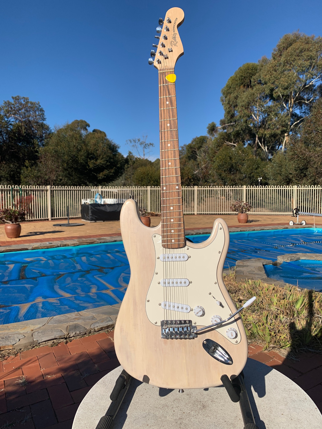

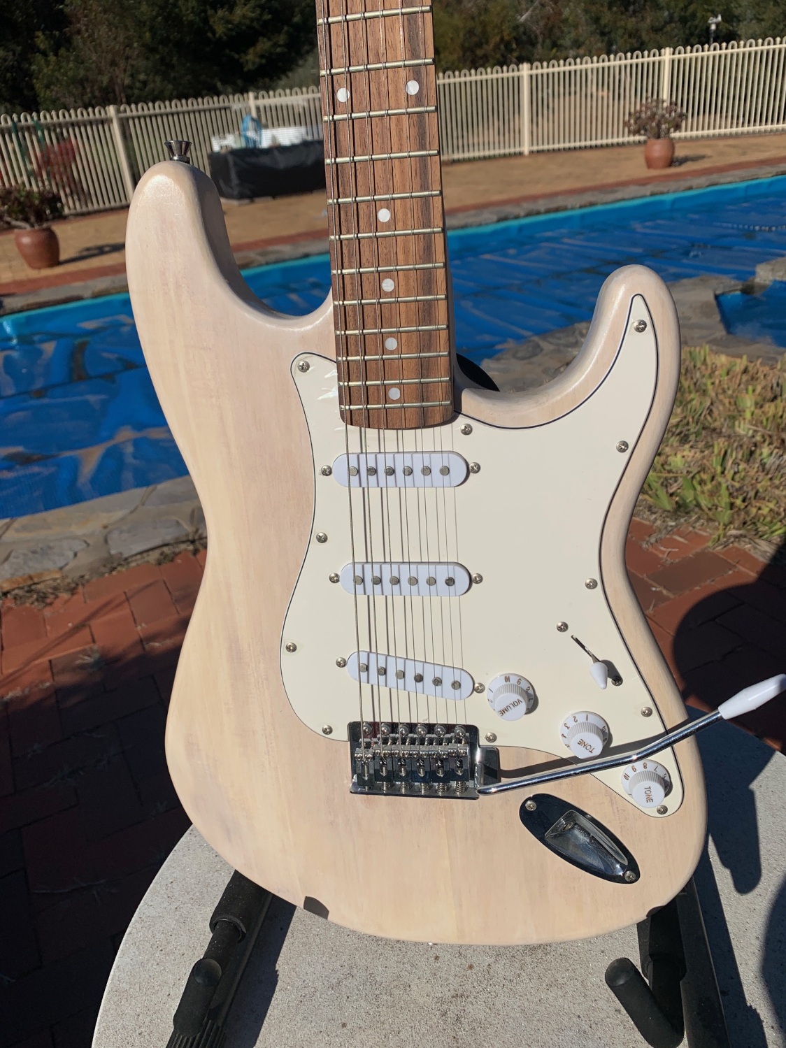

    The Rabbitzcaster 10 years on...
Name:	Strat 10 Years On 02.jpg
ID:	45657   Click image for larger version.
Name:	Strat 10 Years On 03.jpg
ID:	45658   Click image for larger version.
Name:	Strat 10 Years On 04.jpg
ID:	45659   Click image for larger version.
Name:	Strat 10 Years On 05.jpg
    Col.
    \m/

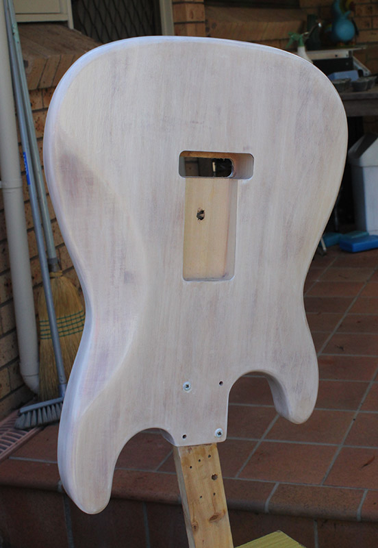

    Working on a "tan" by the pool?
    Is it a trick of the light or has the finish "softened" a bit - Not quite a white as it was....
Name:	Rear 5 Coats Clear.jpg
ID:	45661Click image for larger version.

    It's a little pinker I think. The images are misleading as it is white and will change with the ambient light.
    I am pretty happy with its stability.
    I am not happy with the fact I haven't had time to play a guitar since we moved down here...
