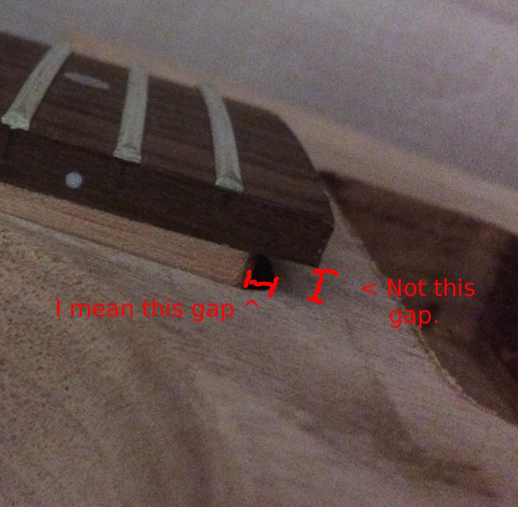

  4. #24
    Quote Originally Posted by keloooe View Post
    The gap is supposed to be there, it is for the pickguard to slip underneath.

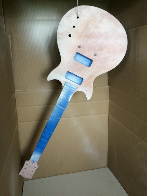

    Not that gap. The one down in the pocket itself. The neck doesn't touch the body.

  5. #25
    Jan 2013
    3,162
    OHHHHHHH I see now!!!! I reckon it is from the break angle, if you plan to mod the pickguard it can hide it nicely!

    I can hide it, but I was more concerned about the lack of contact in the set neck. Both for strength and resonance.
    Picked up some blackwood veneer (the leftovers will be useful for something one day) and will make a shim to fill the gap.

    So working on making a wedge for the gap. It turns out that if put more than just a single piece of veneer in there it pushes the neck out of the socket. So the gap isn't as big as it looks.
    Turns out there's enough room either side of the neck to slide a piece of veneer too.
    Perhaps we'll just call this space for the glue to go in?

    Sam what is the distance of the gap with no veneer inserted and the heel pushed flush into the neck pocket ?
    If its about 1mm or less I agree glue will fill this gap.
    If it's more then you need to sand the veneer in a wedge shape so it fits better and doesn't push the neck away from the pocket
  10. #30
    It looks bigger, but seems I can only fit one piece of <1mm veneer in there before the gap fills up. I think it must taper off pretty quickly. Will do some more experimentation.
    Definitely less than 1mm gap either side of the neck pocket, can only fit one piece of the veneer in there with the neck pushed to the other side.
