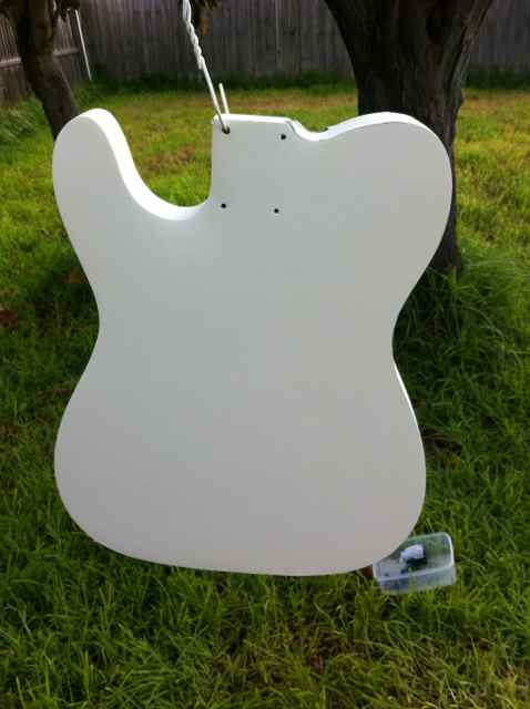

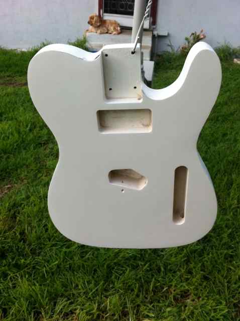

    4 coats of primer applied. Went for 4 as there were a few minor runs in the 3rd coat that need sanding down so I thought the coverage may have been a bit thin in those areas. Wet sanded between each coat with 1200 grit. The area that was gouged out with the router is now unnoticeable also, which I'm very happy with!

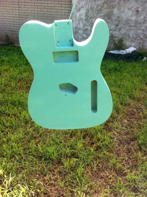

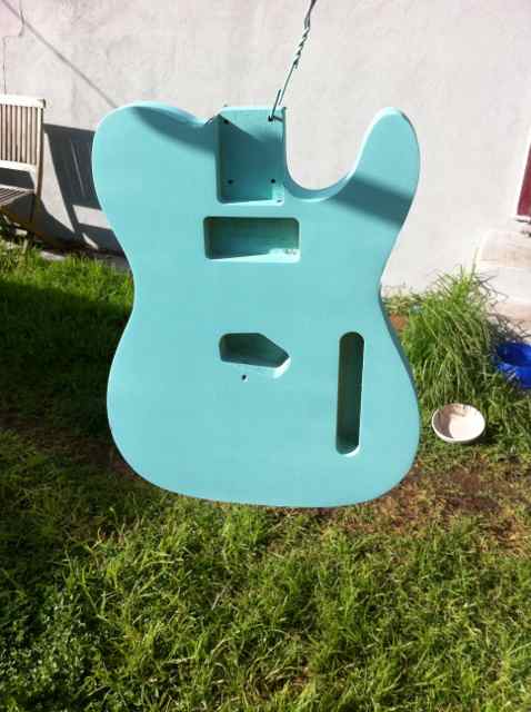

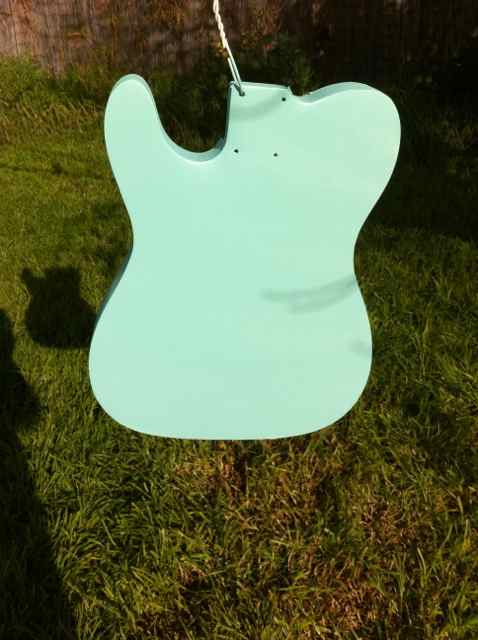

    I applied the first coat of MTN-94 luminous green, which went on nicely. The rattle cans are very low pressure so I found spraying out in the open took a lot of time as even a minor breeze blew the paint everywhere but on the guitar. got there in the end though!
    It's hard to photograph the true colour of this paint. It looks slightly different in each photo but you get the general idea.

  5. #25
    The photo on the top left is probably the most accurate representation of the colour.
