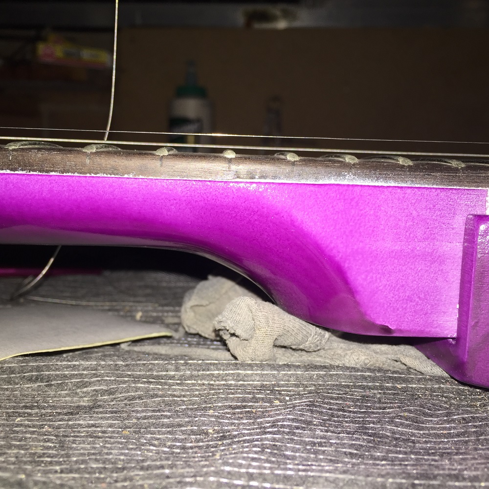

    *Will have to be less "zealous" when masking the fretboard next time, the tape revealing a sharp white line between paint and fretboard
Name:	11. Overmasked.JPG

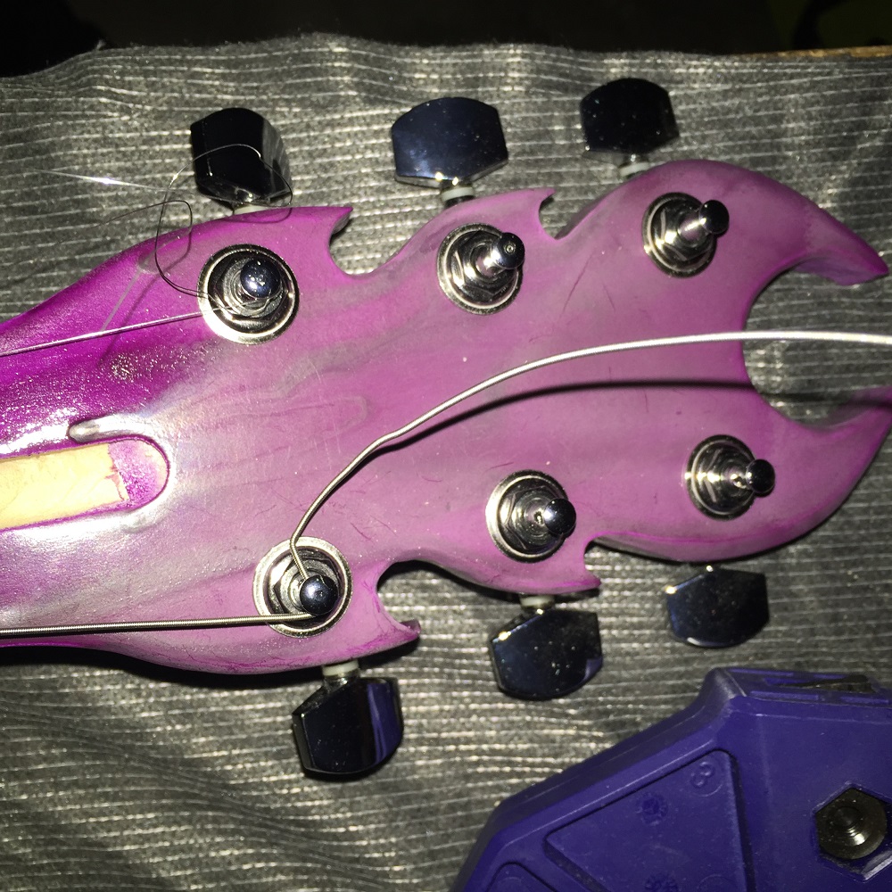

    Headstock turned out really nice. Am glad I put the effort into making it.

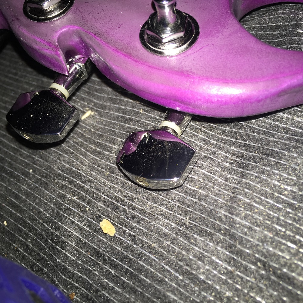

    One of the tuning machine overhangs a little but it's barely noticeable and can't be seen from the front.
Name:	12. Headstock.JPG
ID:	3912Click image for larger version.
Name:	13. Tuning Machine Overhang.JPG

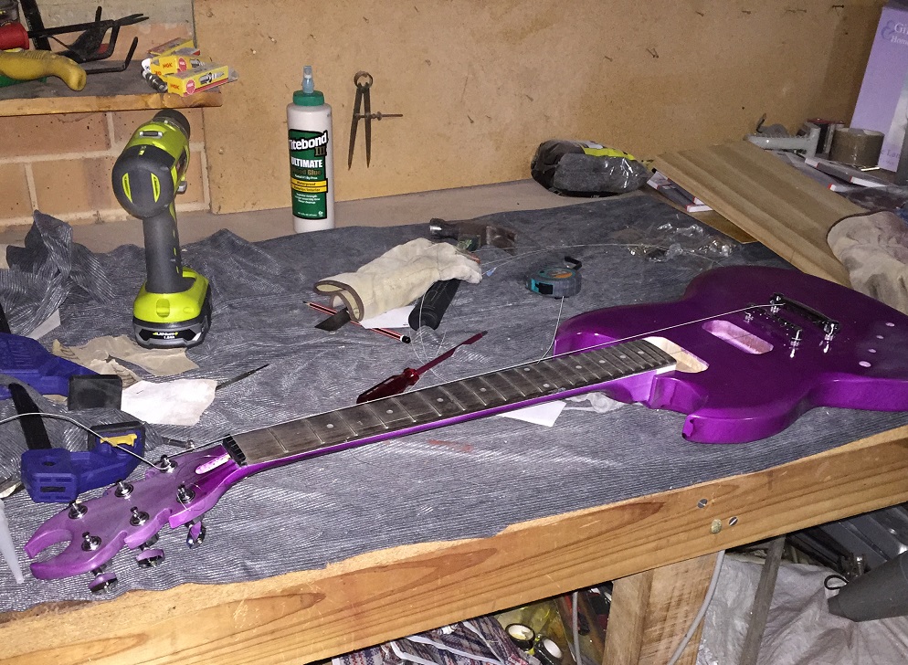

    So, mocked up the guitar getting ready to glue the neck then stumbled across my first real challenges.
Name:	10. Mock Build stringed.JPG
    The dreaded nut to 12 th fret measurement not matching bridge to 12th fret
    http://www.buildyourownguitar.com.au...ead.php?t=3996
    and a loose neck cavity
    http://www.buildyourownguitar.com.au...ead.php?t=3997
