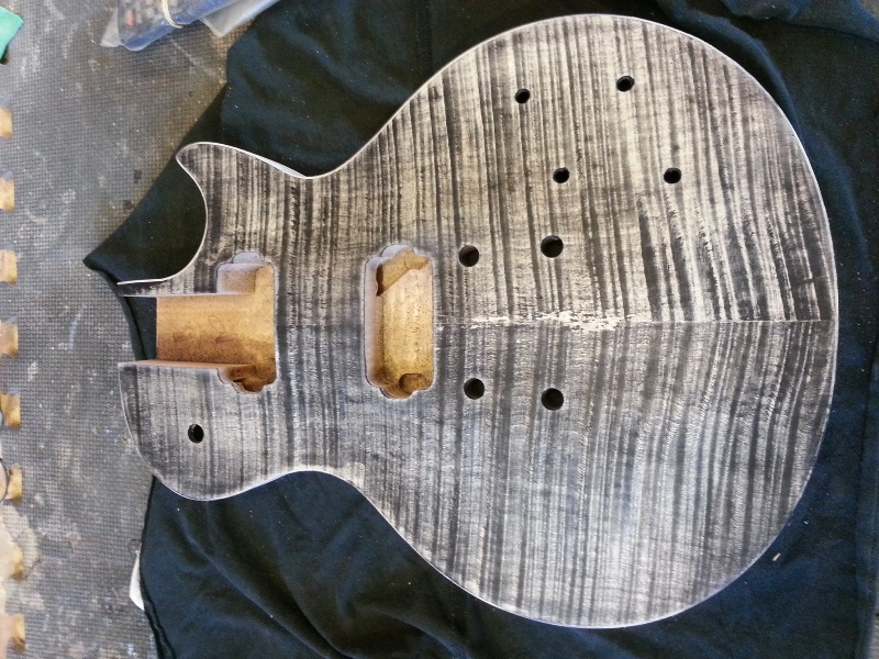

    I have a noob question but is there a way to make the maple grain really stand an pop out? I saw some other forum members on other threads about 'popping the grain' thought that it was literally what it said? Just thought if it's doable I may aswell do it so it's ready for stain!

    Dye with a dark stain first, then sand back. The darker stain will stay in the open grain to give a nice contrast.

    Kurt,
    as Pabs said don't do any pre sanding on the cap (if you haven't done so)
    put a black stain coat down and sand back till it pops the flames.

    Thanks fellas, what sort of black stain do I put down? I've seen people use cartridge ink, coffee. Etc, do I then sand that colour straight out or just antil it's flat again?

    Kurt, what type of stains are you using for the green and black edges ?
    Keep it the same brand/type if you can. I'd use the same black stain you plan for the burst edges.
    Sand back the dark stain coat to look something like this so there are lighter and darker flames.
    Just be aware the caps are ultra thin so keep the sanding on the cap to a minimum, thats why I said best not do any pre-sanding of the cap before the black pop coat goes on

    The actual stain itself is a dark green then I'll end up airbrushing the sunburst on with a solid blackcolour. I'm hoping for it to look fairly similiar to the Gibson Green Widow when it's done. The stain itself is a custom colour from DB.
