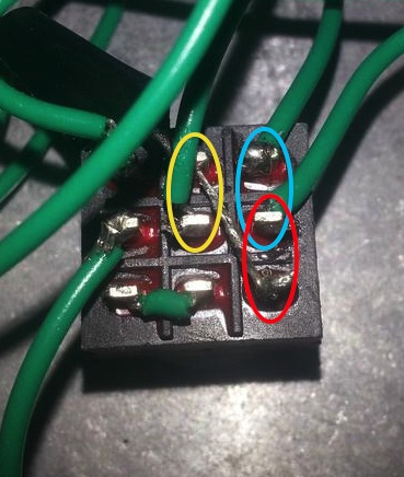

    The footswitch's bypass is mechanical, so if wired correctly should work regardless of power (assuming the switch is ok).
    The blue and yellow contacts are the signal send and return, respectively, and the red contacts are the bypass. Use your multimeter to check the continuity between the red contacts and your in/out jack tips and see what's what.
    (Oh, and buy some more damn colours!)
  5. #25
    Mentor Nickosaurus's Avatar
    Mar 2014
    Adelaide
    1,077
    Haha yes sorry weirdy. Will be buying some new wire soon.
    I've got continuity between both jack tips and the red circled lugs.
  6. #26
    OK, you've got continuity between the tips, good, but you're still not getting a bypass signal? Have you checked ground continuity between the jacks? Also check that you're not getting a short with any of the other lugs on the switch. In particular, check continuity between your jack tips and ground, in case there's a short killing your bypass. The centre 'yellow' lug on the switch goes to ground in bypass, so that bare 'hot' wire running past it would be a prime candiate etc.

    Ground continuity between jacks and no shorts across the switch as far as I can tell. All the continuity is correct straight off the switch.
    I've found that I lose continuity between the input sleeve's resistor and the lug 1 of the pot. I removed the resistor to test it and it was fine. I then jumped the sleeve to lug 1 and got continuity. When I jumped the resistor across there I didn't get continuity though.
    I'm getting confused

  10. #30
    Did you check for non-continuity between the tip and sleeve of the jacks with the footswitch in bypass?
    Can you post some pics of all your wiring, green as it may be, showing the DC jack connections, the pot, jacks and switches. The bypass should be working, so there must be something awry elsewhere.
