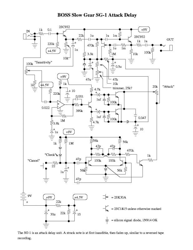

    I'm seriously thinking about building a Boss Slow Gear clone to add to the board, I made one from an old Electronics Australia circuit back in about 1970 ( Attack Delay Unit ).
    Gave a nice violin effect without using a volume pedal.

    Hi Dave,
    Any idea what the unlabelled op-amp in the circuit is?

    Damn Dave that's over my head currently. I'm starting with some simple pre-amps/boosts/fuzz/ODs then when I'm more confident I'm definitely wanting to make a CH1 clone. Love that chorus
    Just did a quick search and this page has some info about it.
    "The IC is a standard single op-amp, so TL071, TL081, TL061, LF441 or dozens of other IC works very well, and even better than the 741. Note the standard dual op-amps ARE NOT COMPATIBLE with this layout! This means that your lovely 4558, TL072 or LM358 will horribly die..."
    Parts list and schematic from above.
    (I wondering the same thing)

    Yeah. Like Weirdy says, any of those single op amps will work and be aware that the 741 is the noisiest one there is. My recommendation is the TL071 because they're cheap, readily available and reasonably clean sounding. For some reason the better sounding op amps come in dual and quad packages. Go figure. Should be a cool little project, this. Looking forward to some sound bites when you're done.
    Thanks Scott, I hadn't found that site yet so it answers the question for both Rabs and myself.
