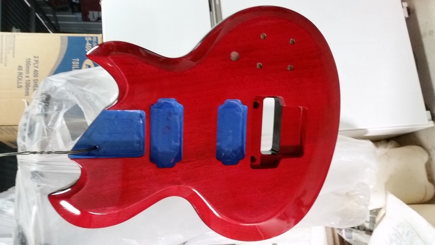

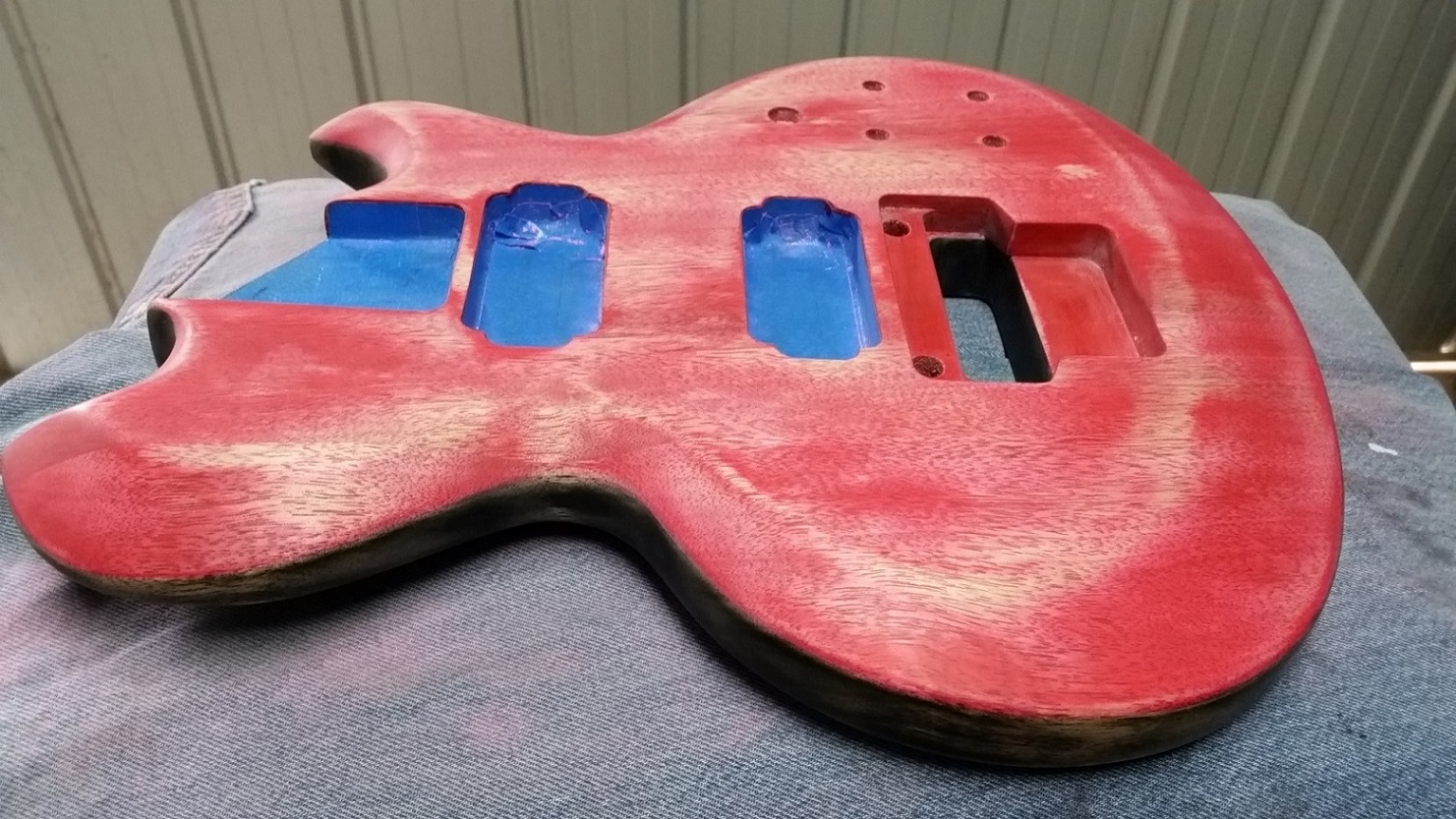

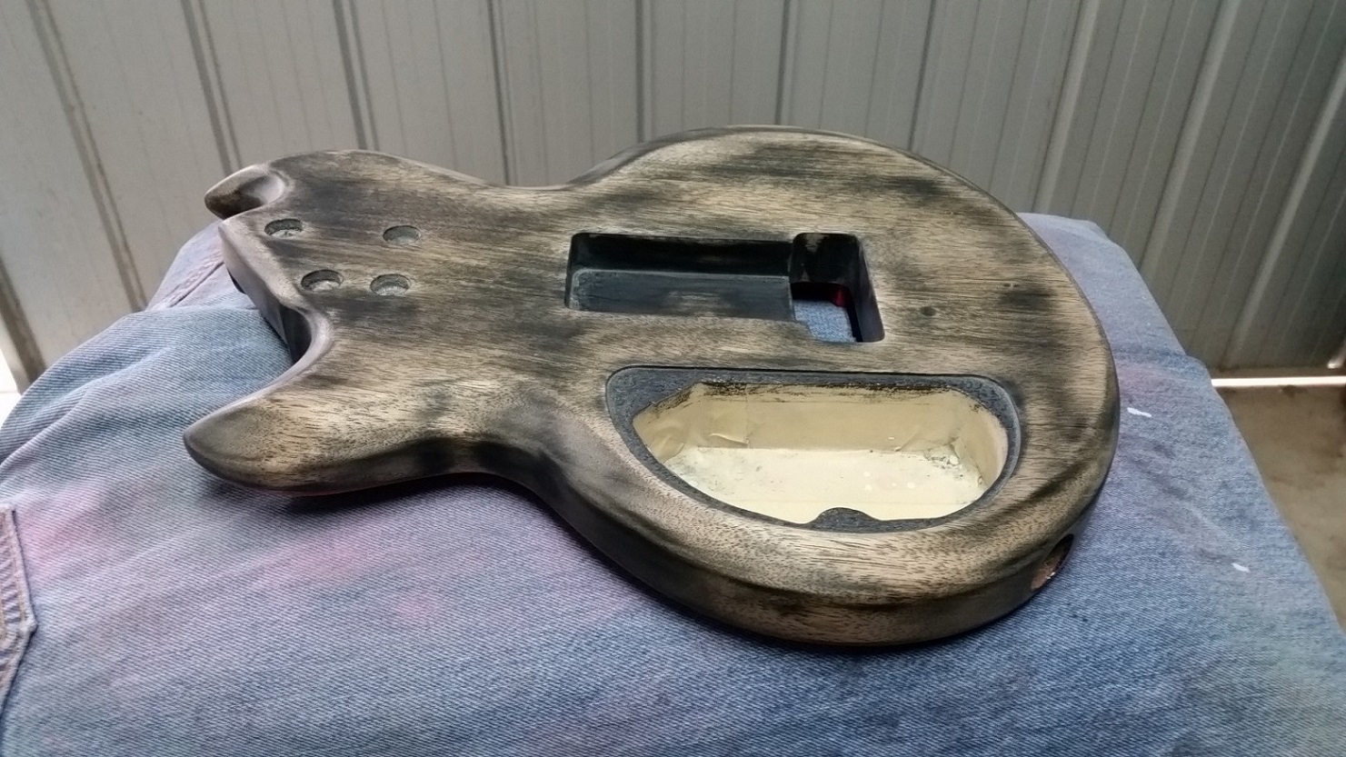

    Back to plan A. The poly ended up with fine cracking/crazing after a few coats. I left a day between coats, so not sure if I put the coats on too thick or too close together. Either way, it was sanding time.

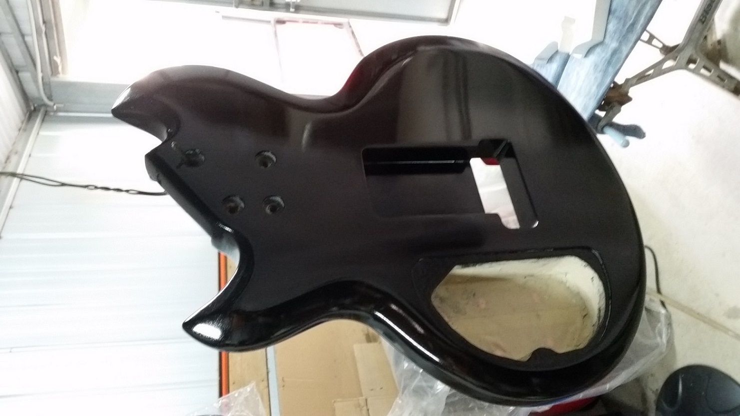

    Re-applied ink and used up almost all of the naughty oil. Forgot- didn't think to- do the grain fill again so there are some deep pores showing up, mostly on the back. All up there is 14 coats on the front and 22 on the back, with some sanding along the way.

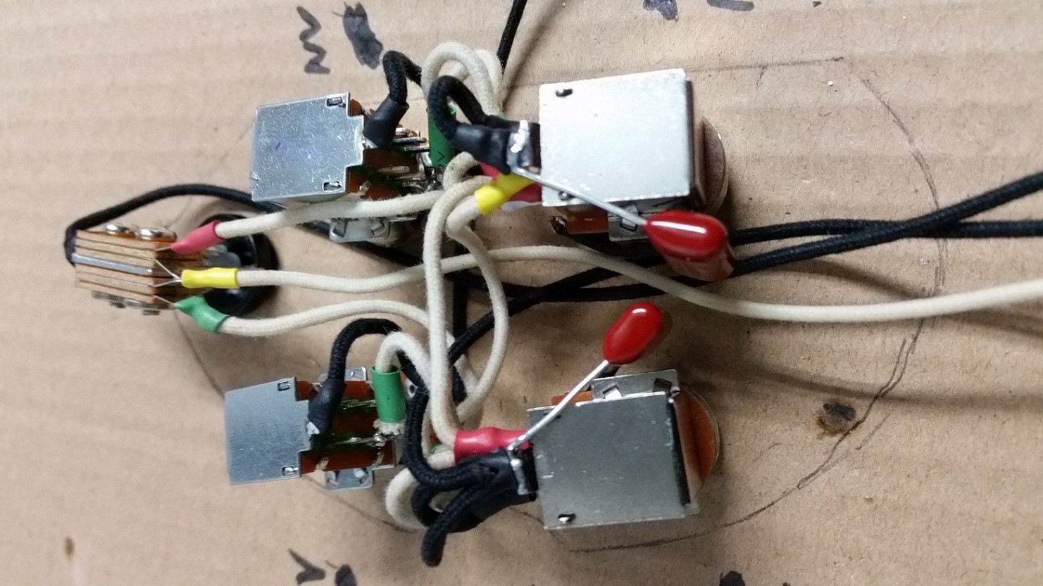

    Also tried to coil-split the stock pups and failed straight away. Managed to break the fine coil wire on the first coil I tried as I undid the tape. So, ordered a pair of Tonerider Rocksongs from Adam and proceeded to fry whats left of my brain by trying to do a Jimmy Page style wiring set-up.
    Spaghetti farm

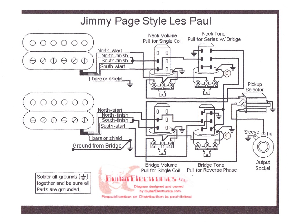

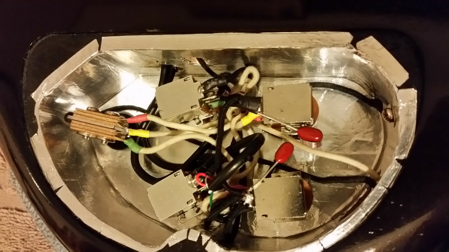

    Also have a question about the wiring. I followed this diagram
Name:	Jimmy Page Les Paul.jpg
    Only thing I needed to change was add a ground wire between the tone pots as the adhesive on the shielding tape wasn't as conductive as it could be.
    Everything appears to work fine, however when the pup selector is set to bridge only and the neck tone is 'up' there is no output.
    Is this how it's supposed to work? Tried to check on their site for specifics (switch must be in this position, etc) and couldn't find this diagram listed, just my luck.
    Any wisdom will be greatly appreciated.
