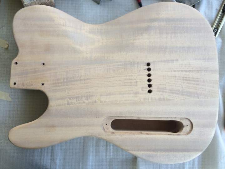

    Over the last couple of days I’ve put a belly cut in the back and sanded down to 400 grit and grain-filled with Walnut TimberMate. I want to enhance what grain there is in the Basswood body and thought that a dark fill like Walnut would give it a bit of a boost.

    Pic #1 - Back before grain-fill
    Pic #2 - ditto after grain-fill

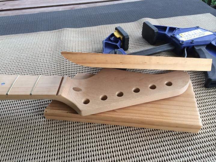

    Pic #3 – a caul I made up to press the headstock veneer.

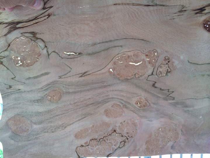

    Pic #3 – Veneer held up to the light to show holes. Man I was disappointed that I couldn’t use this section. It would have looked awesome.

    Thanks Warren. The veneer is Pimento Burr. That's the cool part you're looking at there Warren, the part I had to use is the boring part and looks nothing like that lol. Should have pics up later today, all going well with the veneering.

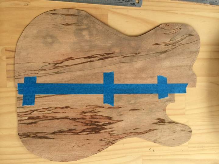

    I taped the two halves of the veneer together to get a really tight join and applied the glue. Within minutes each piece of veneer started to curl up in an attempt to mimic a Pringles tube, ripped away from the tape and as it curled in on itself proceeded to get glue on the top surface of the veneer and all over my working area. I quickly grabbed a damp cloth and moistened the top surface and tried to straighten out the pieces as best I could. But I ended up with glue on my hands and in my panic I managed to transfer it to everything that I touched, veneer, guitar body, work surface. Lol. Oh, and I also managed to put a rip in the veneer just for good measure.
    With that catastrophe averted it was plain sailing, or so I thought. I think that in the process of heating up the damp veneer to reconstitute the glue the veneer must have expanded so my nice tight join that I painstakingly endeavored to achieve started to part as the veneer cooled. It has left a gap of about 1.5 mm between the sheets. Darn!!

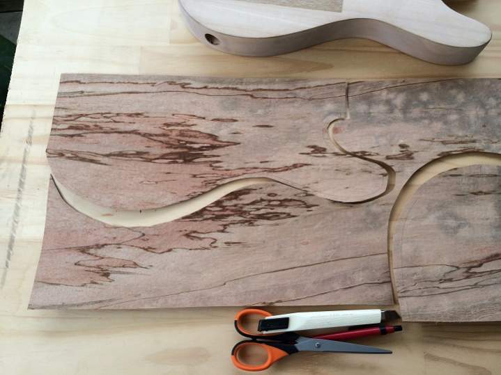

    #1 – Cutting out the usable sections of the veneer
    #2 – Taped together to give what I hoped would be a perfect seamless join (lol)
