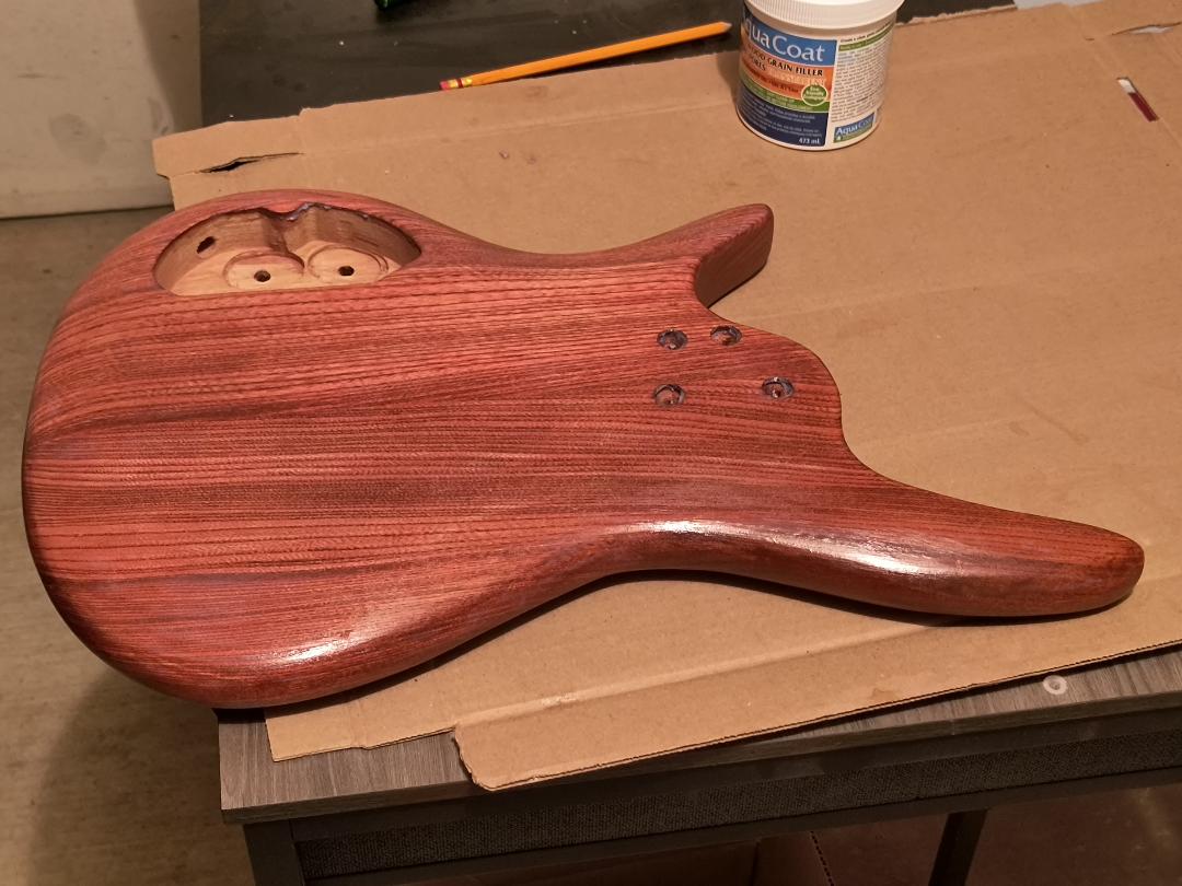

Next, I did a bad job of applying a coat (or more) of stain. I’m not sure if I should have diluted it a little first, as it seemed to go on kind of thick, but I believe the real problem was my lack of experience in applying stain. As seen in the photos, it was way too thick. Either it was due to my lack of experience, or the wood was super thirsty, causing it to dry very quickly (or both). I tried wiping off the excess with a clean cloth, but was a little too late as it got thick and tacky in less than a minute. Lesson learned: have a cloth ready to wipe the excess stain off within about 10 to 20 seconds, and don’t do a large area all at once.

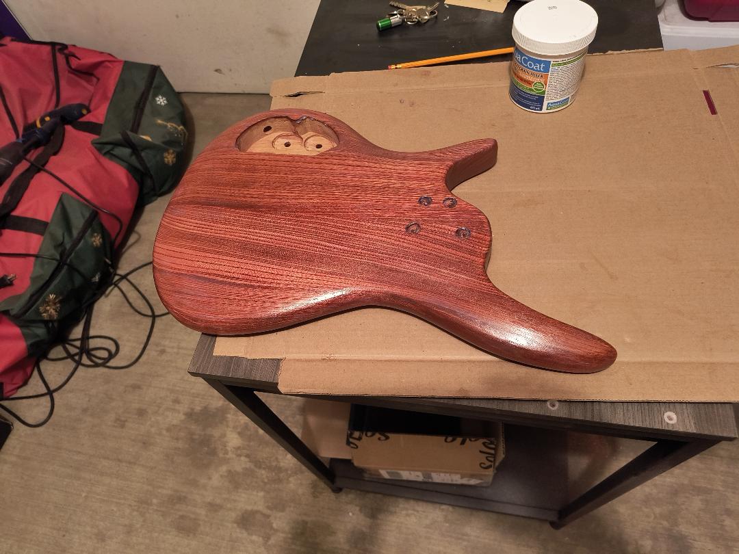

Luckily, a lot of sanding got the the stain back to a decent looking level, eventually with little visible blotchiness. The top edges between the “horns” and the neck pocket were the hardest to get to a decent level. I went from 80 grit up to 240 grit, and even tried 400 grit to see how well it worked. I then saw a video where it was advised to not go more than about 120 grit between stainings, so I went back and tried to rough it up a bit with a quick sanding using 80 and then 120 grit.
Next up is to finish sanding the blotchy areas down better before the second coat of stain.
