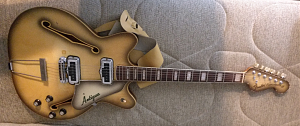

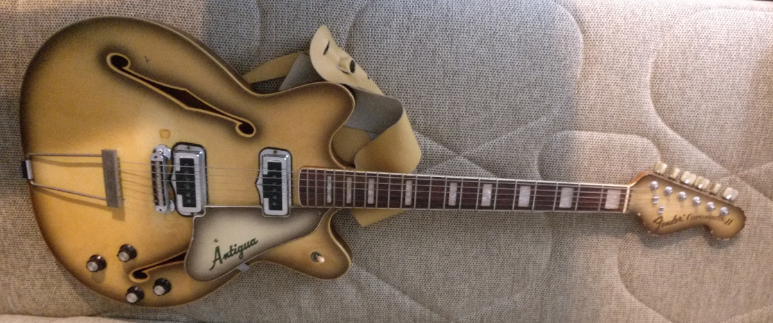

    You could possibly ground the tailpiece similar to the way the tele bridges are ground! Just thinking!
    This is the most common way of grounding the strings when the guitar has a floating bridge. It's the way my old Fender Coronado is grounded, since the bridge (although metal) "floats" on top of the finish rather than on posts.

    Love the Coronado in Antigua finish, F3x, very nice.
    Grant
    Trevor beat me to it.
  10. #30
    3,061
    Quote Originally Posted by neverwas View Post
    IRL the finish is not in very good shape. LOTS of crazing and cracks. Not all of them, but most of them, were already there when I acquired the guitar in the mid-1970's. It was made in 1968 and had a hard life before landing in the pawn shop where I bought it. I don't think I was even in high school yet. You either think it's ugly, or you love it, or you love it because it's ugly. It's not helped by the yellowing over time of the clear coat which makes it look all of the various colors of snot ;-)
