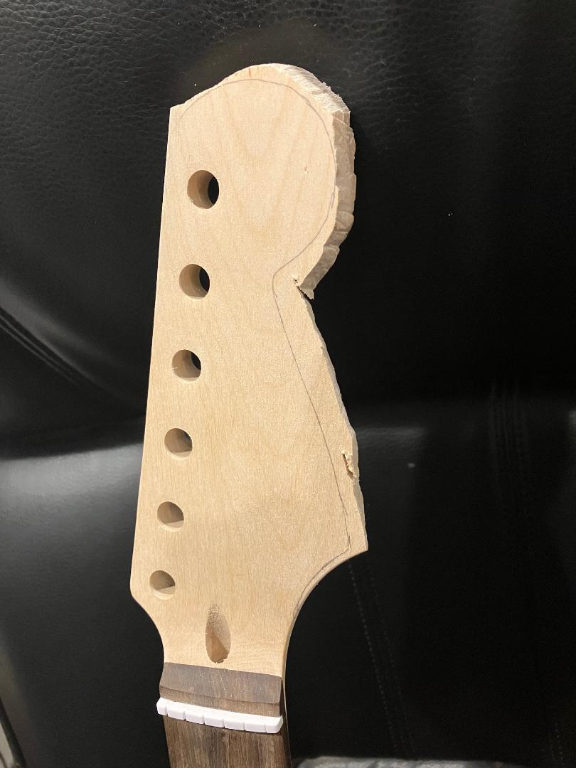

    Yeah, I am still alive up here. Been busy with a banjo and a saddle, but I'd better get serious with this build. I'm posting a photo of the headstock roughed out (Rough! Looks like is was gnawed out by a mad beaver). I only broke one coping saw blade, and should break down and buy myself a little jig saw. I'm attacking it now with a hoof rasp, and it will come along. Somewhere between a Tele and a Strat for design, I think. Click image for larger version.

    1,967
    A maple headstock is very hard to cut with a coping saw, so 1 months work sounds about right.
    3,003
    1+
    Maple is tough. I am not good with coping saw and have not used one for a headstock. I have done it several ways, but my go-to first tool is a jig saw. I get it to roughly the way you have it...but a jigsaw in 1/2” maple is imprecise (at least in my hands. The bottom of the blade tends to wander on curves, so I can't get too close to the pencil line.
    My grandfather had hoofing rasps. I use wood rasps to even it up a bit and take off a bit more material. I haven't seen a hoofing rasps since I was in high school, but I think it should be pretty similar to wood rasps I have. Pretty sure that hoof is softer than maple though.
    I finish with a router or, more recently and improvised spindle sander on my small drill-press, which obviates the need for a template.
    I think most people use a power tool (saw, rotary, sander, router) for at least part of it. But there are some hearty folks who do the whole thing with hand tools.
    That said I think you are the first I have seen use a tool designed for a horse!
    Sent from my LE2125 using Tapatalk

    Well, in this dry country in late summer, those hoofs can get about as hard as flint. Maybe you don't have that problem down in the south. I got a pair of front shoes on my little mare last summer, but, truth to tell, I'm about aged out of that business. Back and legs won't take it.
    Headstock looks pretty good, at least it passes TD's 3-foot rule (maybe 5 feet for my work?). I'm on my 3rd go at filling a chip the coarse rasp took out of the face. Wipe with wet cloth, sand, and apply maple stain. I like the color and have used it on all my necks.
