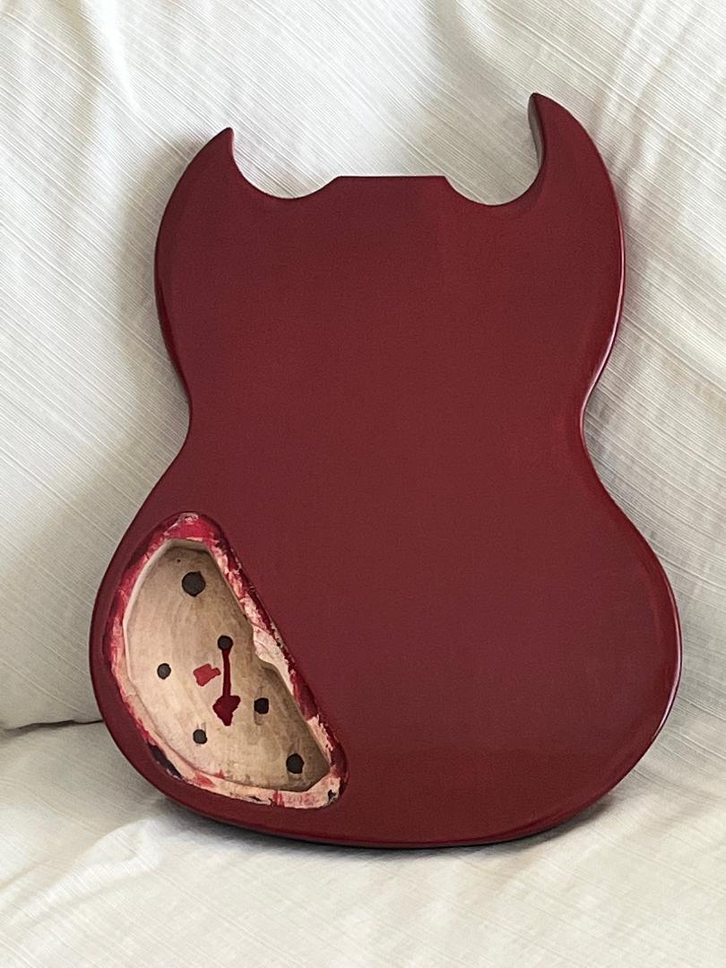

ID:	45026Click image for larger version.
    This is how it looks today. On my way to about 10 or a dozen light coats of wipe-on Poly, with very light sanding at 400 between coats to keep the little pimples down. This is when all of the little unevennesses and flaws that you thougt you had sanded out become obvious. I suppose most of us started thinking our finishes would look just like Gibson or Paul Reed Smith, but wrong. I at least have had to lower my expectations considerably. But that is OK. Early on I was not too sure of the color, but after half a dozen applications of deep red acrylic, with a 2-week wait for the acrylic to dry and cure completely, I am pretty happy with the color with the clear coats on. StewMac has posted a series of videos that are supposed to teach us to produce a guitar store-quality finish. I think I will study that perhaps with next winter in mind.
    High temp in western Utah today was about 3 C.
  8. #28
    1,979
    Looking good. And I agree with the difficulty in getting a great finish! I go by the three foot rule. If it looks good from 3 feet away, when I'm not wearing my glasses, I'm happy! But keep trying and hopefully it gets better with practice.
