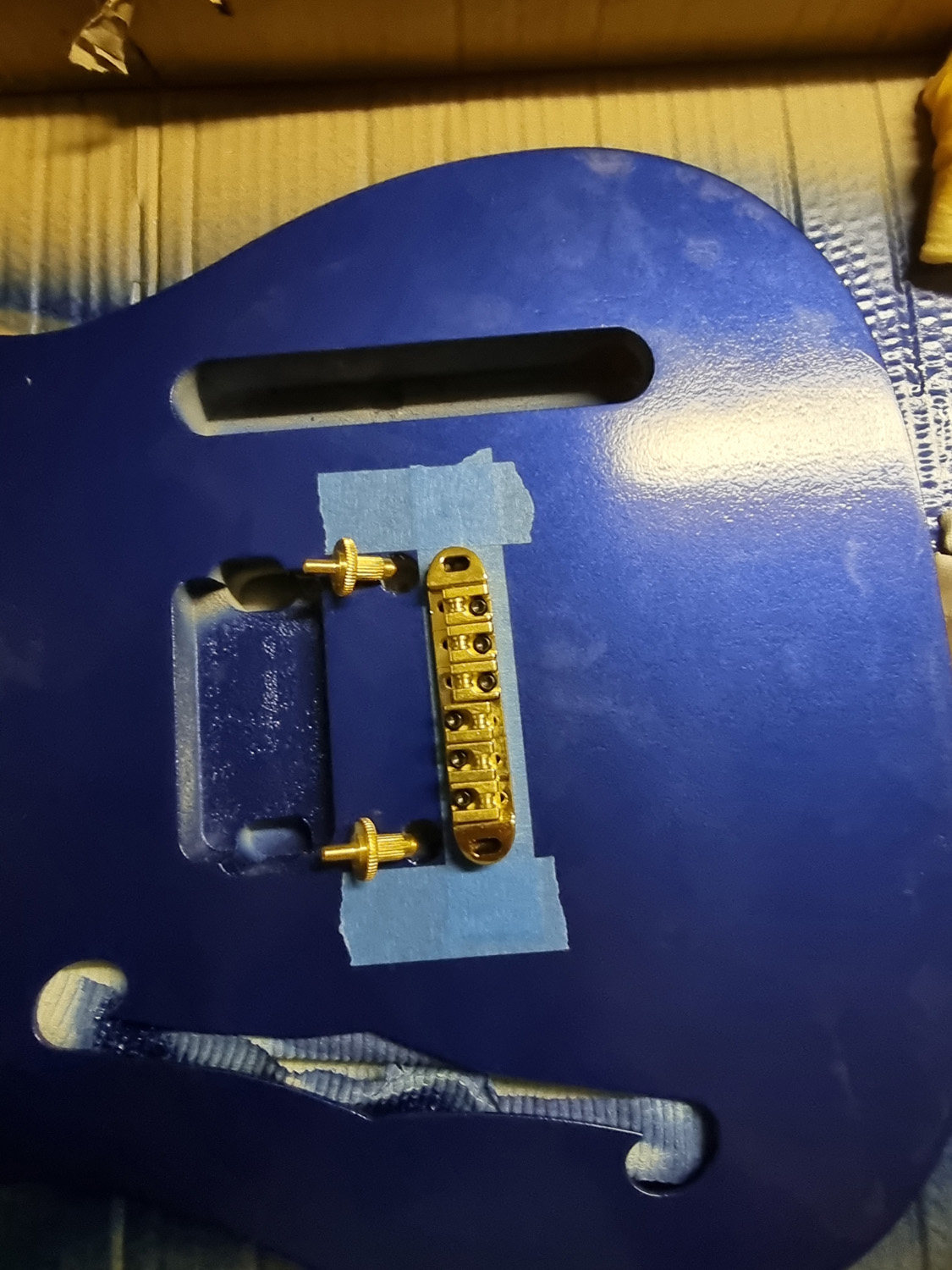

    Another part has shown up, a common issue with bigsby style trem is tuning stability so has sourced a roll-a-matic bridge. Fortunately with the relocation of the bridge back to suit the scale length new holes have to be drill as the new bridge has smaller posts.

    It’s easier to find the correct bridge position if you can string it up first, and run the strings over the bridge to check the alignment fown the neck. With a Bigsby instead of a stop tailpiece, that’s not so easy, but to hold the strings behind the bridge, I’ve seen people use a cheap trapeze tailpiece simply fixed to the rear strap button position, with the bridge raised up to a fretboard-clearing height on a suitable thickness of cardboard. You still need to get the bridge angle correct, but you can certainly mark the side-to-side position with ease, rather than try and work out a centreline.

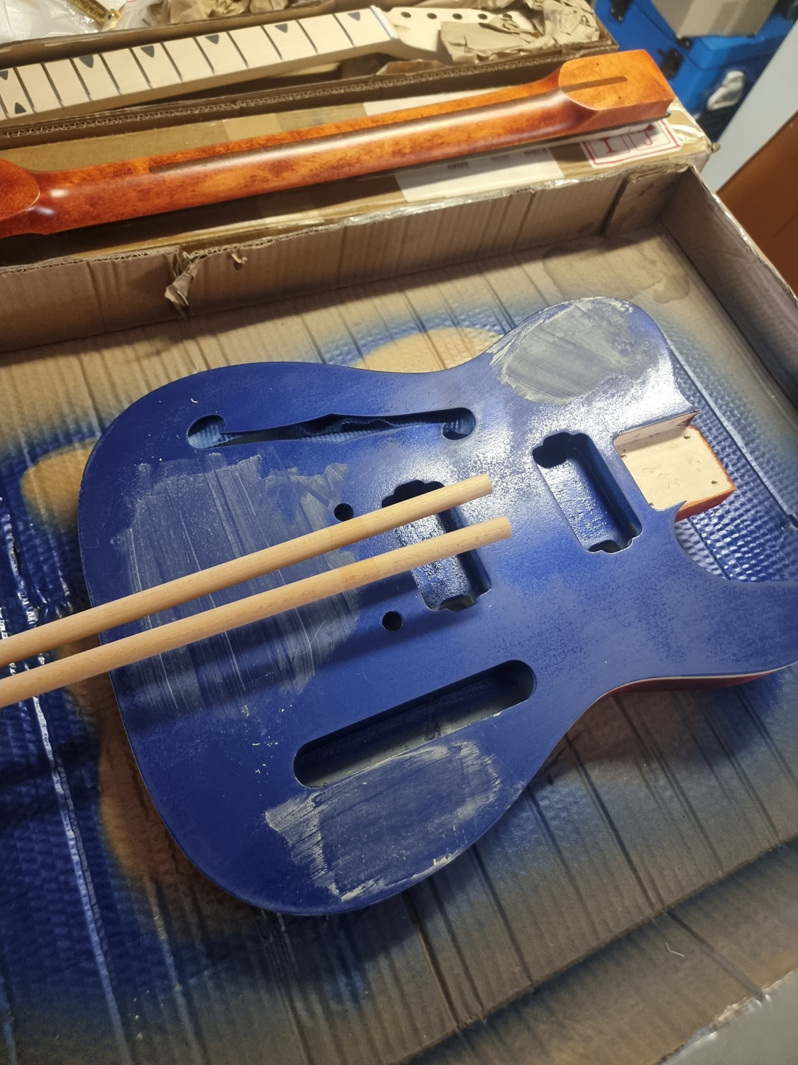

    So my dowel showed up this week and it's just a little too big for a straight fit by 0.5mm, have to carefully drill it out then cut plugs to fit. Flatting the top didn't work out as planned, the filler keeps scrapping out and not remaining behind. I then tried to fill the entire top to flatten it out but decide against this as I still have a lot of work to do on the top.
    FWIW, I think I would sand the edges of the dowel down to fit the holes. If the dowel fits into a drill chuck, you could place a small section into a drill and spin that around some sand paper.
    Thanks for the tip, that is what I did to fit the dowel into the body and used a proper wood glue to set, sanded them down to size then took to the whole top to finish it. Tried setting up the tail and bridge using the provided strings in the kit but having no luck getting it to stay in position, will have to clamp it down in rough position then adjust before making any drill holes.

    Quote Originally Posted by Pendragon View Post
    ...Flatting the top didn't work out as planned, the filler keeps scrapping out and not remaining behind. I then tried to fill the entire top to flatten it out but decide against this as I still have a lot of work to do on the top.Click image for larger version.
    It's not cheap, but in similar circumstances I have had decent luck using AquaCoat Clear. I have pretty much only used it with shellac and water based finishes...but it has suck well to bare wood, two different water based clear coats and acrylic spray paint.
    You had also asked about clear coats. I like General Finishes High Performance Satin. I have used it on all my necks. I apply with a brush, which requires a fair amount of sanding...but I am told it's better if you have spray equipment. It's pretty hard, and often used for musical instruments.
    I have used Crystalac Brite Tone, which is advertised as an "instrument finish" and as "the hardest." It may be a tad harder than the GFHP, but I did not notice a great deal of difference. I used the gloss rather than the satin, but they make one...
    These are the two that I have used that produce the hardest finish.
    I know that there are epoxy and and solvent based finishes that are harder...but these are the hardest water based finishes I have used.

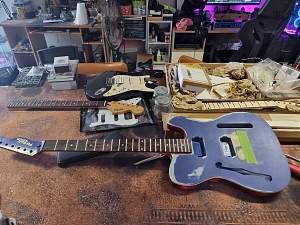

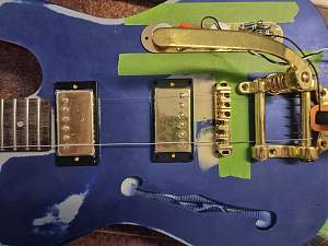

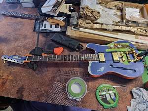

    Attempt number 2 has been more successful after realising that the strings go under the front roller of the bigsby, it's my first one but believe I have everything just about right. The bridge pickup is just a little off and there is no more room to adjust it so the bridge has to moved hopefully it will be good enough. Taped of the control plate so I can see how wide I go to fit the new pots and not over space it.
