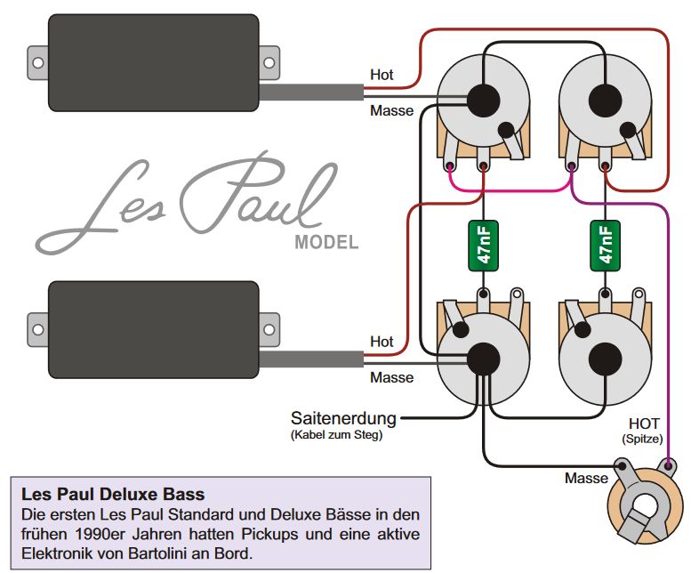

  7. #27
    3,084
    Not sure what you used for a wiring chart, but it should be like this one:
    I think this should be right for yours: Two tones, two volumes, no switches.
    I took the diagram from a German source but it's pretty clear if you remember that "Masse" means ground/earth. The wire that says it goes to "Saitenerdung" is the ground/earth wire for the bridge. "Hot" is exactly what you'd think ;-)
    First thing to do: See if the way you wired the bass looks like this.
    Second thing to do, turn the volume pots all the way up and see if that makes a difference. If not, turn them all the way down to see if you hear the bass (you would not be the first person to wire it backwards).
    If the hot leads from the pots go correctly to the pots, and the hot leads go from the pots to the hot on the jack, then the problem is may be with the ground wire going to the jack.
    Since you are hearing nothing from either pickup, the next thing to check is the jack. Could be no ground to the jack. Could be hot wire and ground wire are reversed on the jack.
    You may want to take some pics and post them. Sometimes folks here can see where the wiring might be off.

    Hi Nigel,
    I had a possibly similar issue with my TB-4. Those pups had a hot wire and ground (bare and green) wires. The green wire part was not grounded as I had accidently trimmed it! And No sound.
    For my TB-4, with the volumes on 10, I get a resistance of about 7 300 ohms. This is from the end of a lead plugged into the jack socket.
    I would also test the hot to ground from the pups, the hot tab of the volume pots, tone pots and jack plug.

    Thanks for the advice, guys!
    Some wiring mods and I now have sound - sounds great. I think the problem may have been shorting between the pot terminals and the conductive coated cavity. I've now got washers to prevent this and will fit tomorrow...
    Nigel
