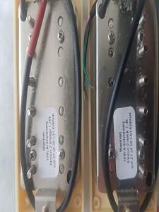

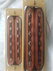

    This is the pickups I have bought. see through covers, to see the windings.Click image for larger version.
