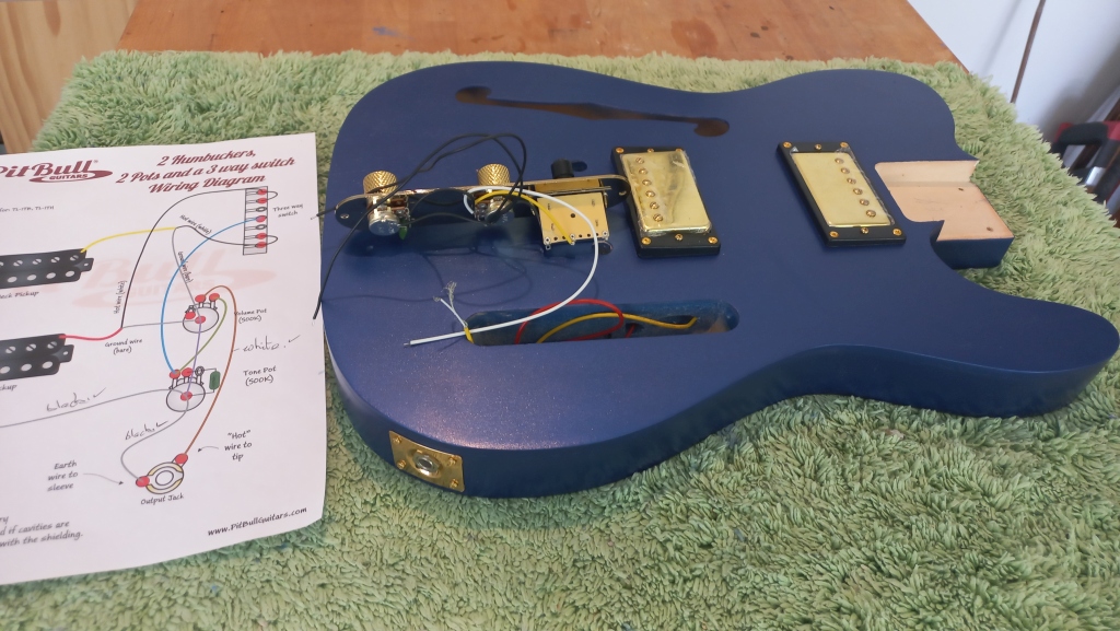

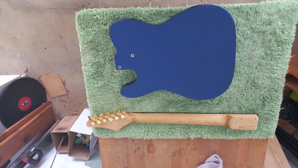

    Well I was hoping that I would have a new guitar for Xmas but “the best laid plans of mice and men” in this case my paint job didnot turnout the way I wanted. So sanded back and used acrylic lacquer instead of the enamel I had tried. The paint is now finished (tung oil on the neck)
    I have now fitted the pickup’s and next is to solder the wiring
    I have looked at the wiring diagram and it seems straightforward (apart from the actual soldering)
    My question is, the earth wire from the PU’s is a wire ‘mesh’. Is there anything to be careful of when soldering this. Thanks

    Quote Originally Posted by Olddon View Post
    I do not think so, treat it like a wire. Trim/cut it to the size needed. Just make sure the wires inside can get to where they are needed!
    Simon has talked about this before - but I cannot find the thread!

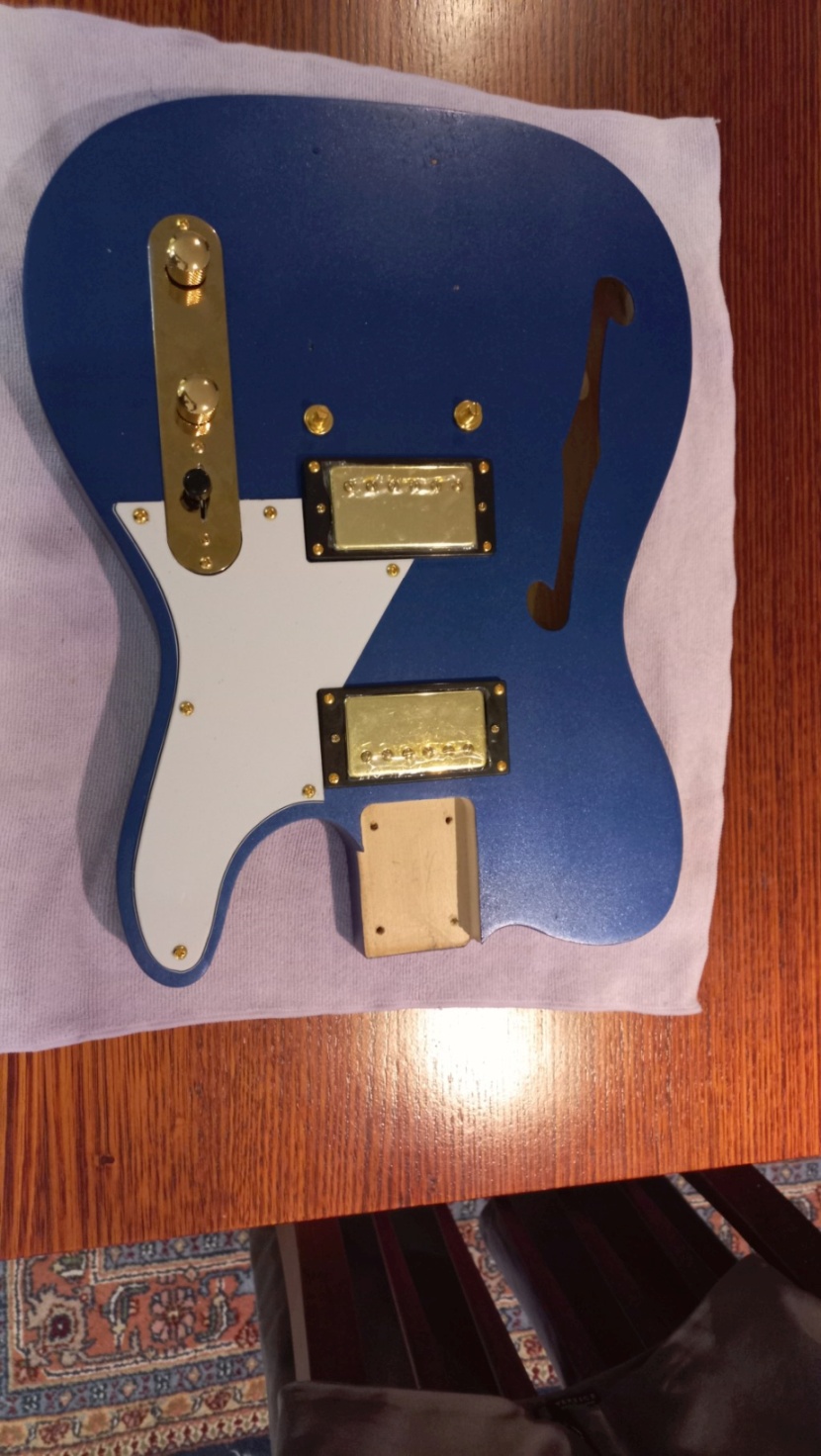

    Thanks Stewartm, as I know nothing about painting, electronics, soldering or guitars it seemed an apt title. I am however enjoying the experience immensely.
    Thanks Trevor for the soldering tips, I also went and had a look at a PBG video on wiring a TL1. It looks like the selector switch has changed sometime in the last 8 years, but I got the general idea. So today I took the bull by the horns and it turned out a lot better than expected. Some solders went well, others took a bit longer, but nothing got smashed or thrown at the wall The PU’s were wired in, the output jack (puretone) was wired up and then it was time for the tap test !! … and it worked perfectly. Very surprised. However as I was about to install the ‘switch panel’ luckily I noticed that an earth wire had come off. A quick resolder and hopefully all good. Seeing I was on a roll I also installed the pick guard and hammered in the bridge pins (and even remembering the earth wire).
    Next is fitting the neck, straightforward, and then aligning the Bigsby, possibly not so straightforward.
