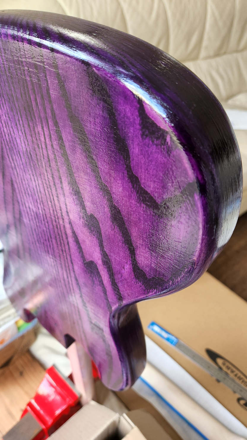

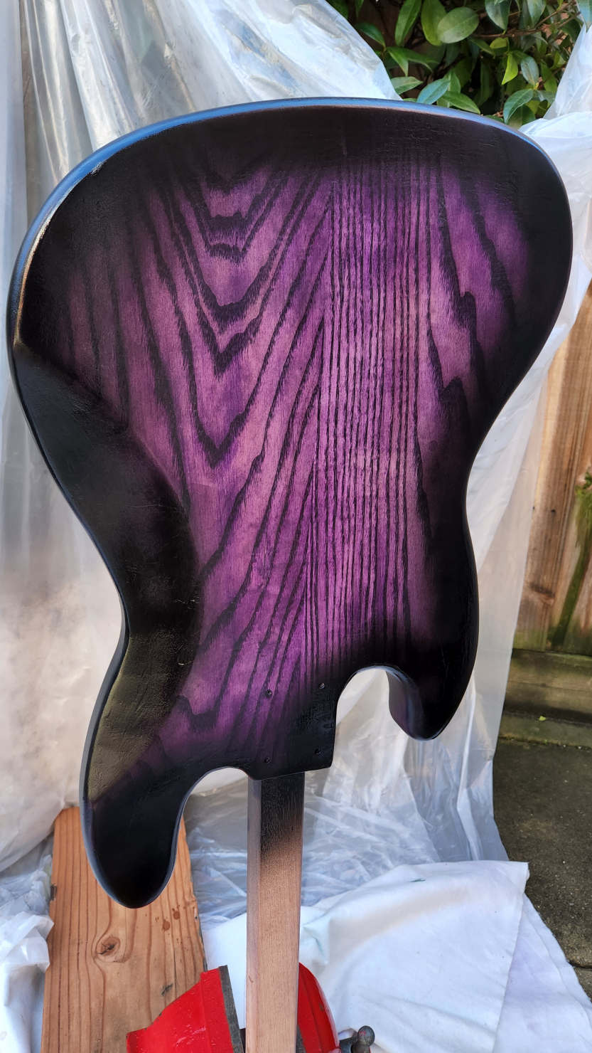

    Member Mathew's Avatar
    Jul 2022
    70
    So...
    If I was confident with what I was doing, I would have followed Chris' advice and sanded the clear coat. But as I was unsure how the burst would come out using cans, I followed Phrozin's advice and didn't sand, in case I needed to sand the burst off and start again.
    But...
    I'm happy with the burst! For cans, I think it looks pretty good. The body matches what I had in mind, which is a purple glow popping out of a dark body. I think it will look great with Clearcoat. The headstock came out just as I intended too, with just the purple popping through the centre.
    I'll let it dry tonight/tomorrow, and lay Clearcoat over the weekend. I'm planning 15 double-headet coats of SCA Acrylic on the body, and 3 coats of Cabot's Marine poly on the neck - gloss on the face of the headstock and satin on the rest.
