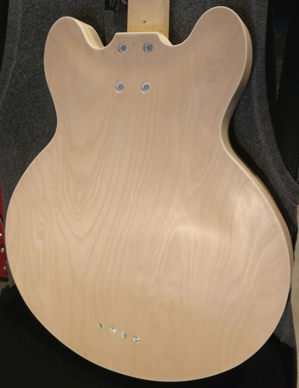

Couple of thoughts about the finish. I think what Simon says about basswood is mostly true, but YMMV. This is a basswood back on an ES style bass:
I liked it so well that I just sanded lightly and clearcoated. I have also seen basswood with almost no figuring.
