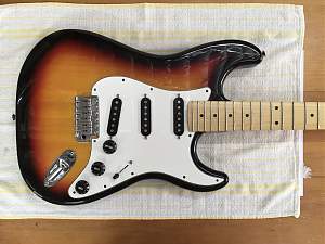

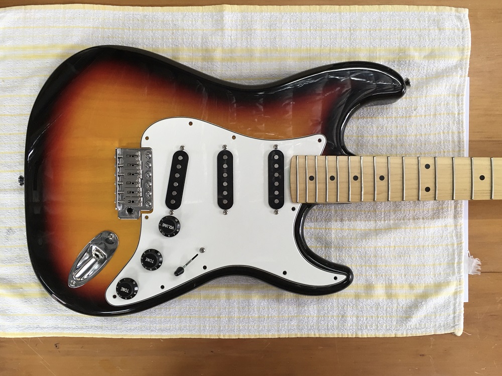

Nothing really exciting to show, but it's getting closer to done. Since last post I've mounted the vibrato, got the neck
and tuners installed.
I've been waiting on the pickguard & back plate since ordered 10/10/21. Just got notification that it's finally in
Australia! (30 days and counting in transit) The pickguard in the photo is just temporary so I could wire up the pickups.
I haven't fully decided on the black knobs/pup covers, but I'm leaning that way. I'll wait and see how it looks with the white pearloid. I have the whole kit in white and cream as well.
I did have one little setback with the neck. I somehow managed to ding the 17th fret (still don't know how or when it happened). It was pretty much right where the B string would pass and was too deep to just level out without levelling the remaining upper frets, so I just replaced it. Oh well, all sorted now.
One thing that's deviated from the original plan is the pickups. I was going with a set of Tonerider Classic Blues, but
remembered I also have a set "Duncan Designed" SC-101's from my Squier Deluxe strat. The 101's have been discussed and debated online as to being a poorman's version of SD SSL's. Opinions seem to be quite polarized between love 'em or hate 'em. I didn't have them in my Deluxe for that long, but remembered them favourably. After doing some looking around online, I found this article/forum post and decided to try the mod and give them a try.
https://www.strat-talk.com/threads/d...hereof.467148/
As per the linked post, I removed the shielding and adjusted the pole pieces to a vintage stagger. I've got the TR's if they don't do it for me.
