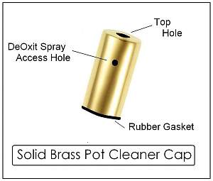

    I do mine like doc...but the device I was thinking of is something like this:
ID:	40119Click image for larger version.
    ...I am, of course, too cheap to own one.
  5. #25
    I think Stewmac stock something like that.
  6. #26
    However that method may not get the cleaner/lubricant on the track, or be patchy at best. Better than nothing if you don't want to take pots out of a semi-acoustic to spray them, but not as good as being able to spray inside the slot.
  7. #27
    3,100
    Yeah, I suspect that's right. I have been tempted for the semi accoustics where I don't have easy access. Then I see the price and begin wondering if it's even effective. a curved tube like Doc posted is probably better if you can get at the back easily.
  8. #28
    Loosening the pot nuts slightly so you can rotate them if necessary, a flexible nozzle for the spray and a mirror should do it. Only if the wiring harness is very tight and doesn't allow the pots to turn enough to get the nozzle in might you need to think about dropping the whole harness down so you can pull it back nearer the F-holes.
    Of course some of those Gretsch styles with knobs in the top and front horn could prove very difficult without removing pickups and almost fully removing and re-installing the harness again.
