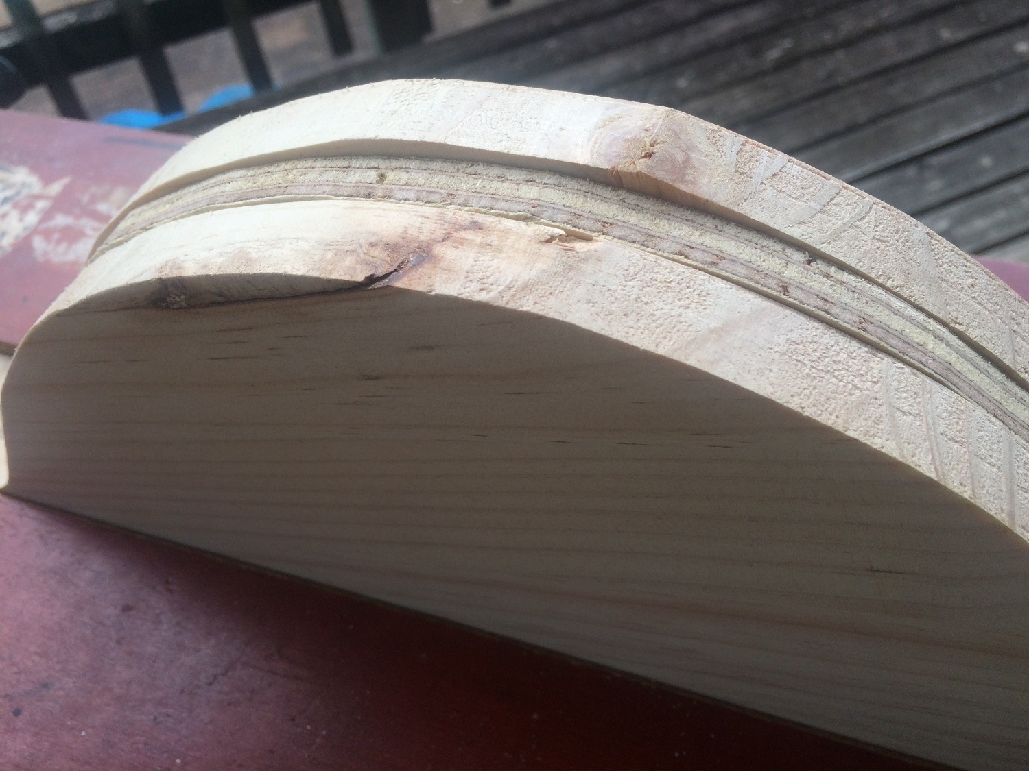

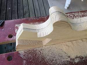

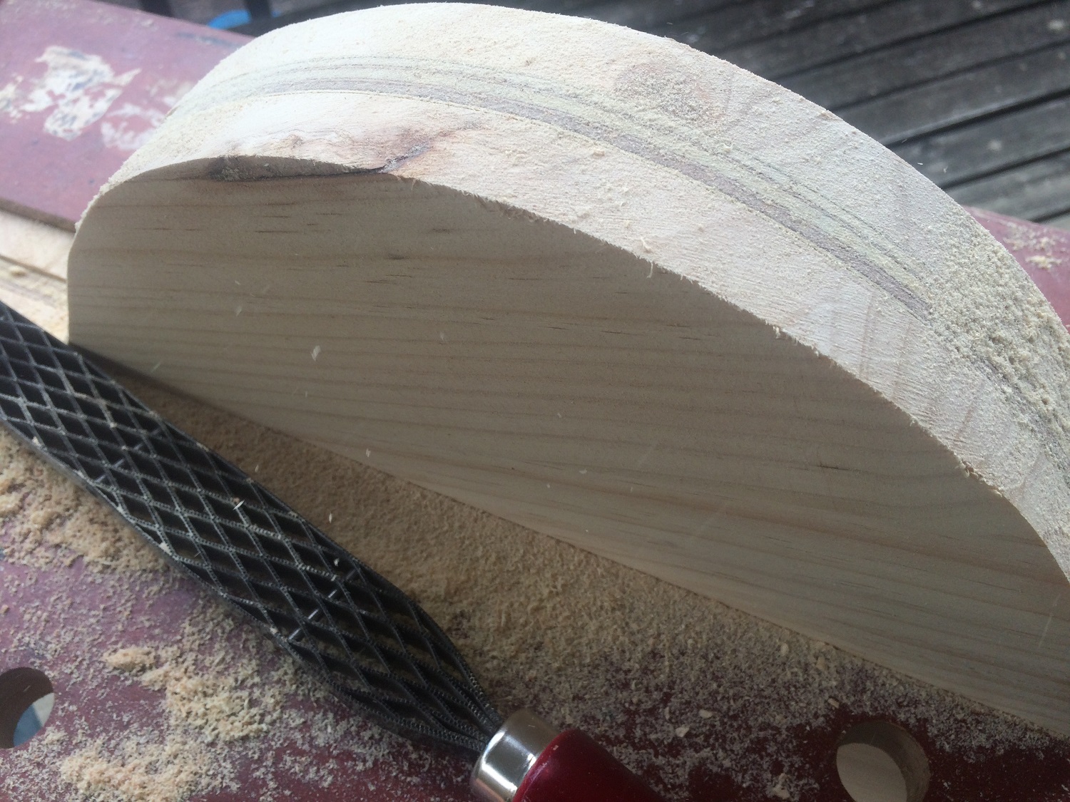

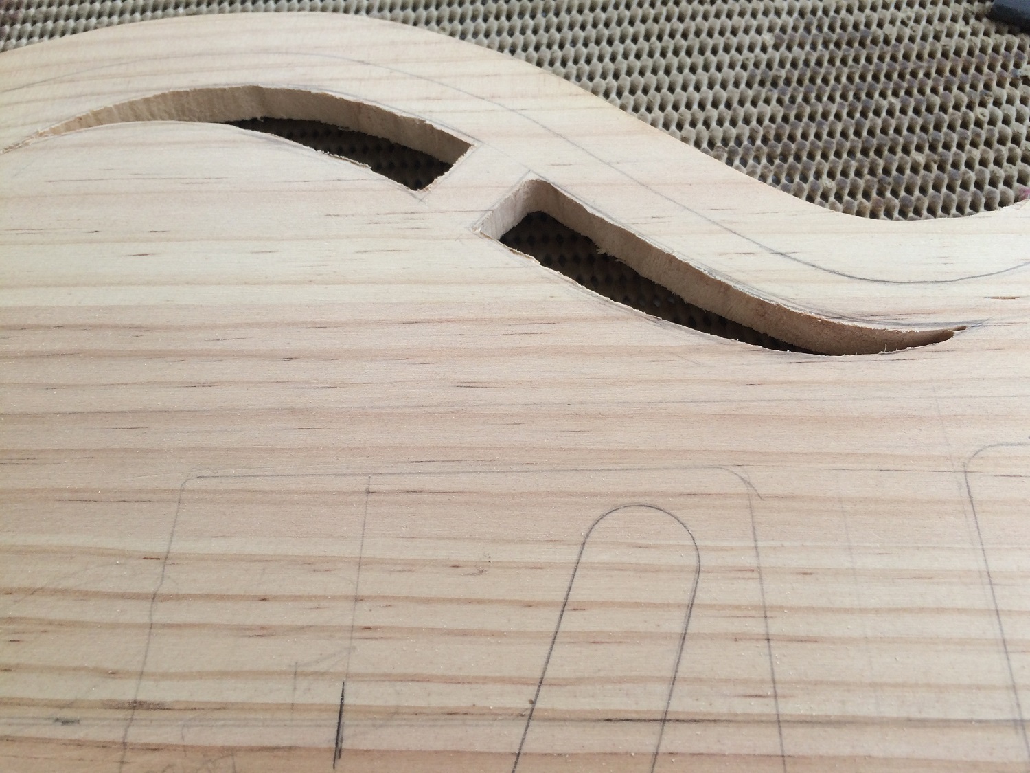

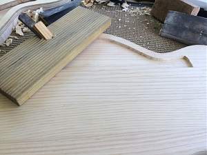

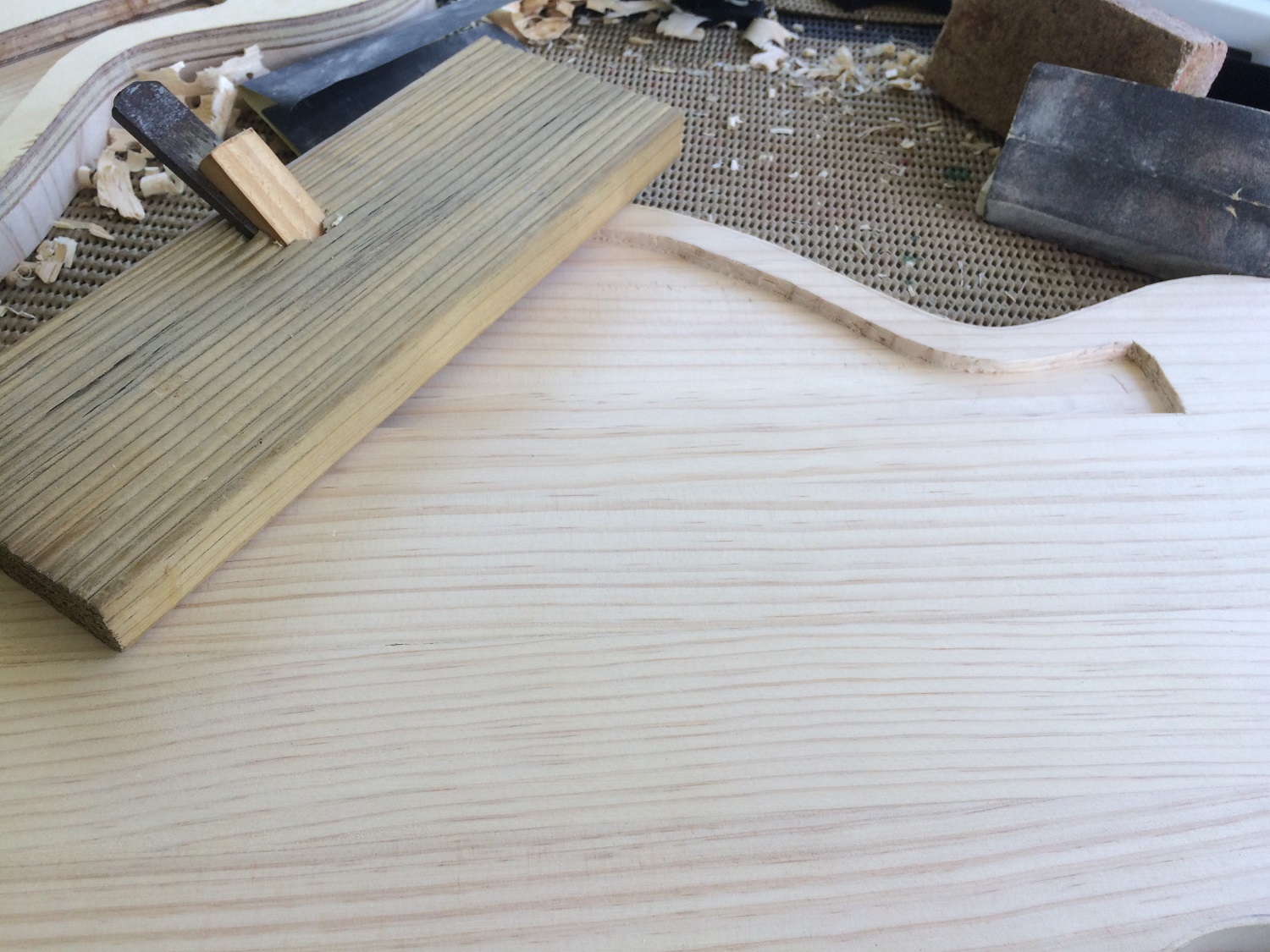

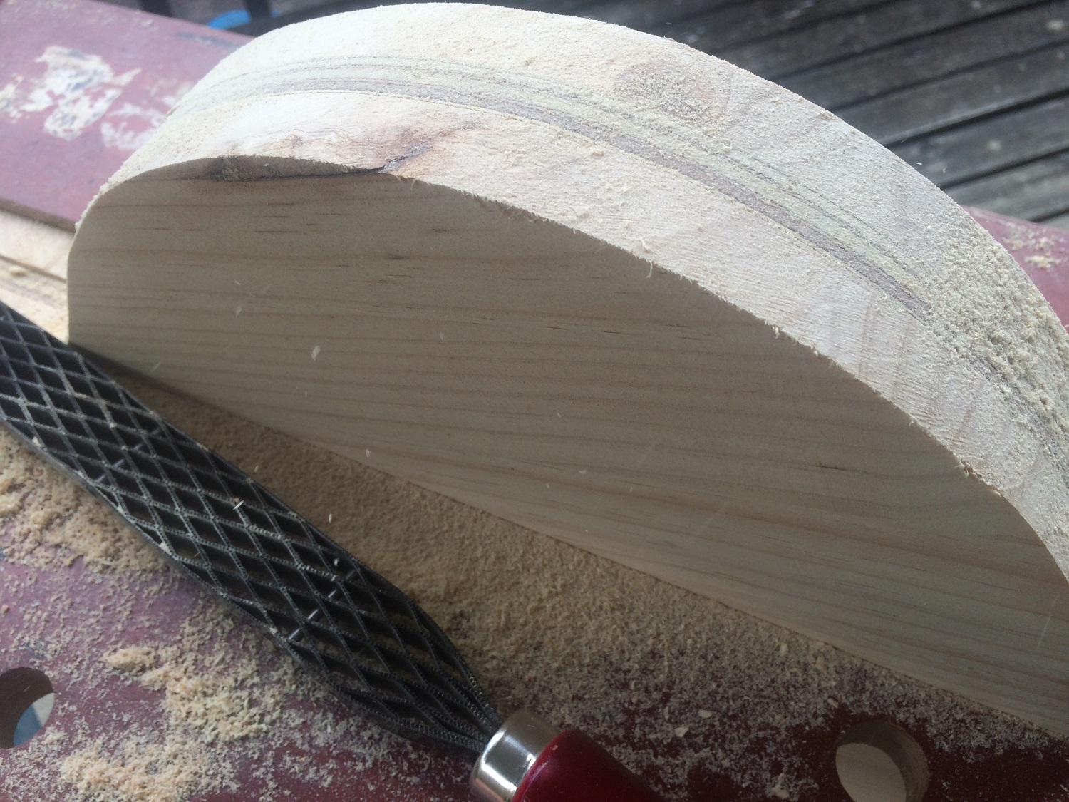

    Another full day, this time filing and rasping. I now have the body roughly in shape.
    Before – Ugly
ID:	39172 Click image for larger version.
    After – not so ugly.
ID:	39176 Click image for larger version.
    I haven’t started final shaping and sanding yet and will leave that until I have the body glued together.

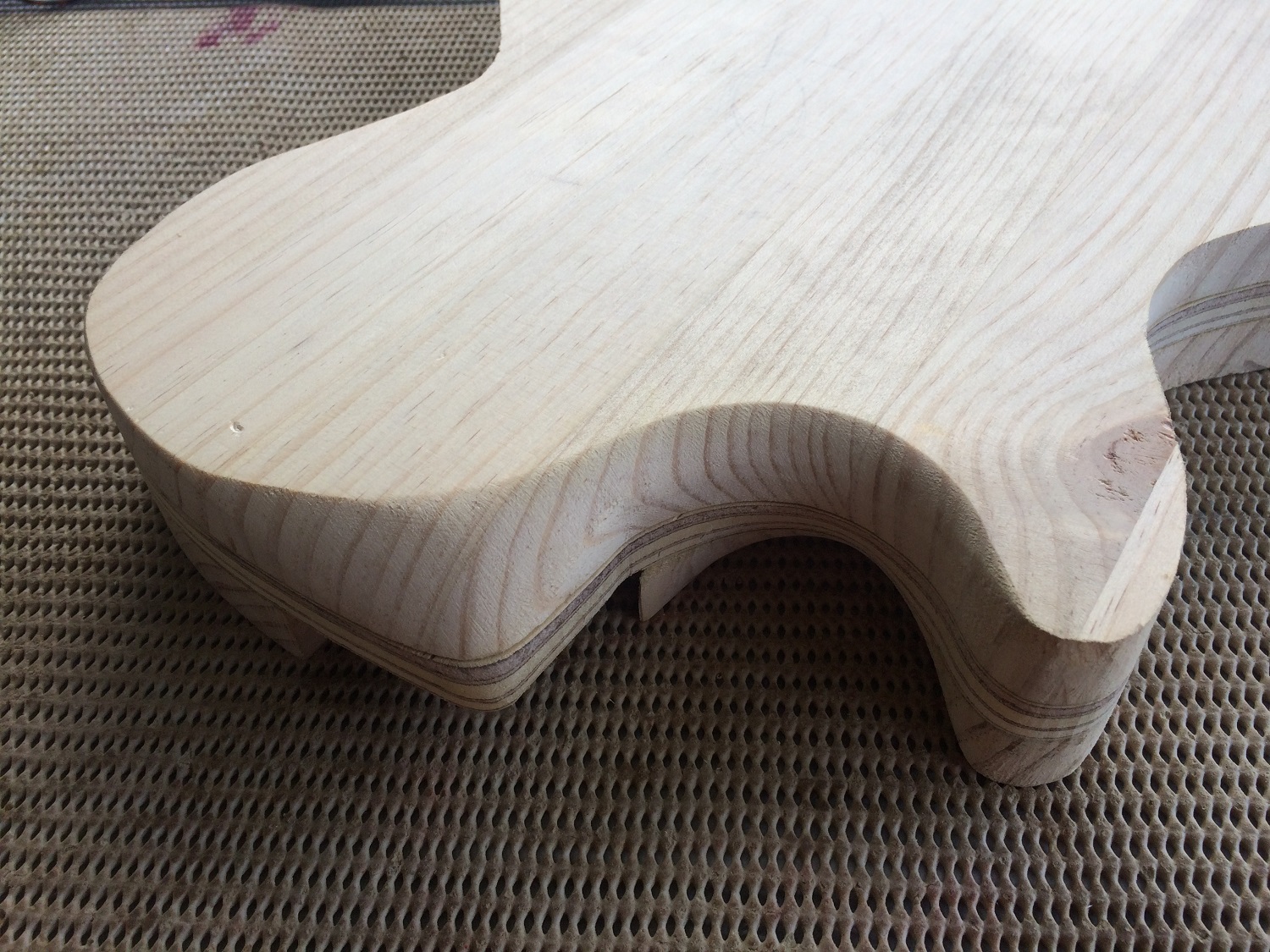

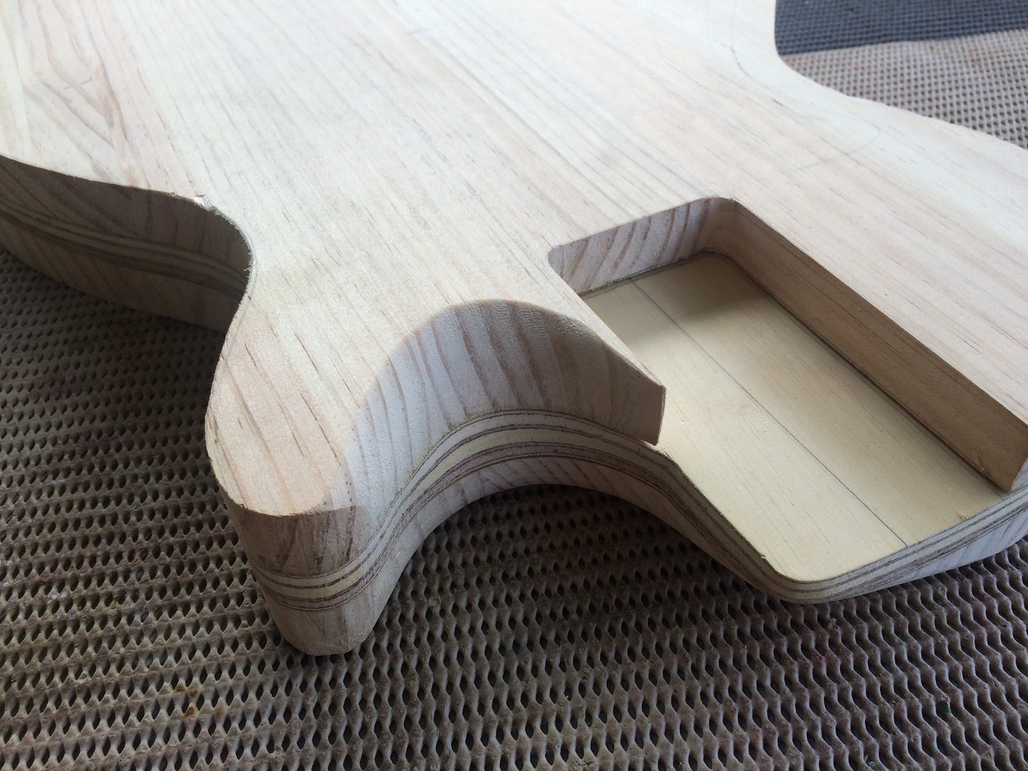

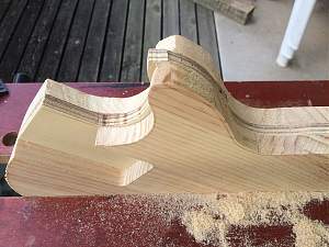

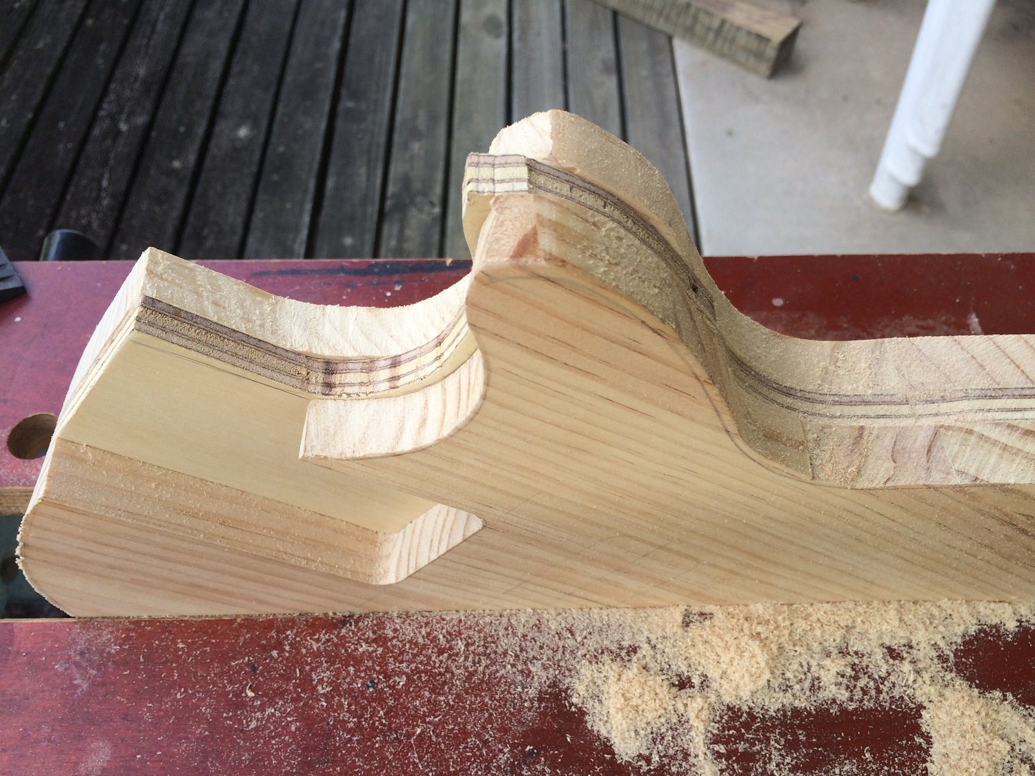

    I fixed Mistake #3 by reshaping the profile of the lower horn a bit to get some access to the higher frets. I have still retained the general LP Jnr shape so its kind of a fix.
ID:	39231 Click image for larger version.

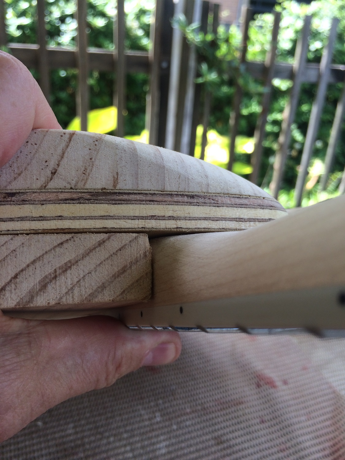

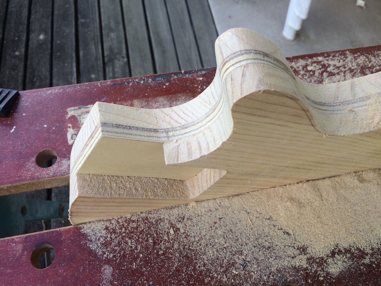

    I also reshaped the heel of the neck to get a better transition to the body and that’s when I noticed…
    Mistake #4. It’s not a biggie, but I shaved too much of the heel and now it has left a bit of a gap where the neck joins the body at the upper bout. I’m not going to worry about that just now and will wait till I have the neck screwed securely in place and see what I can come up with.

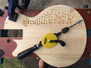

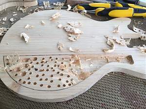

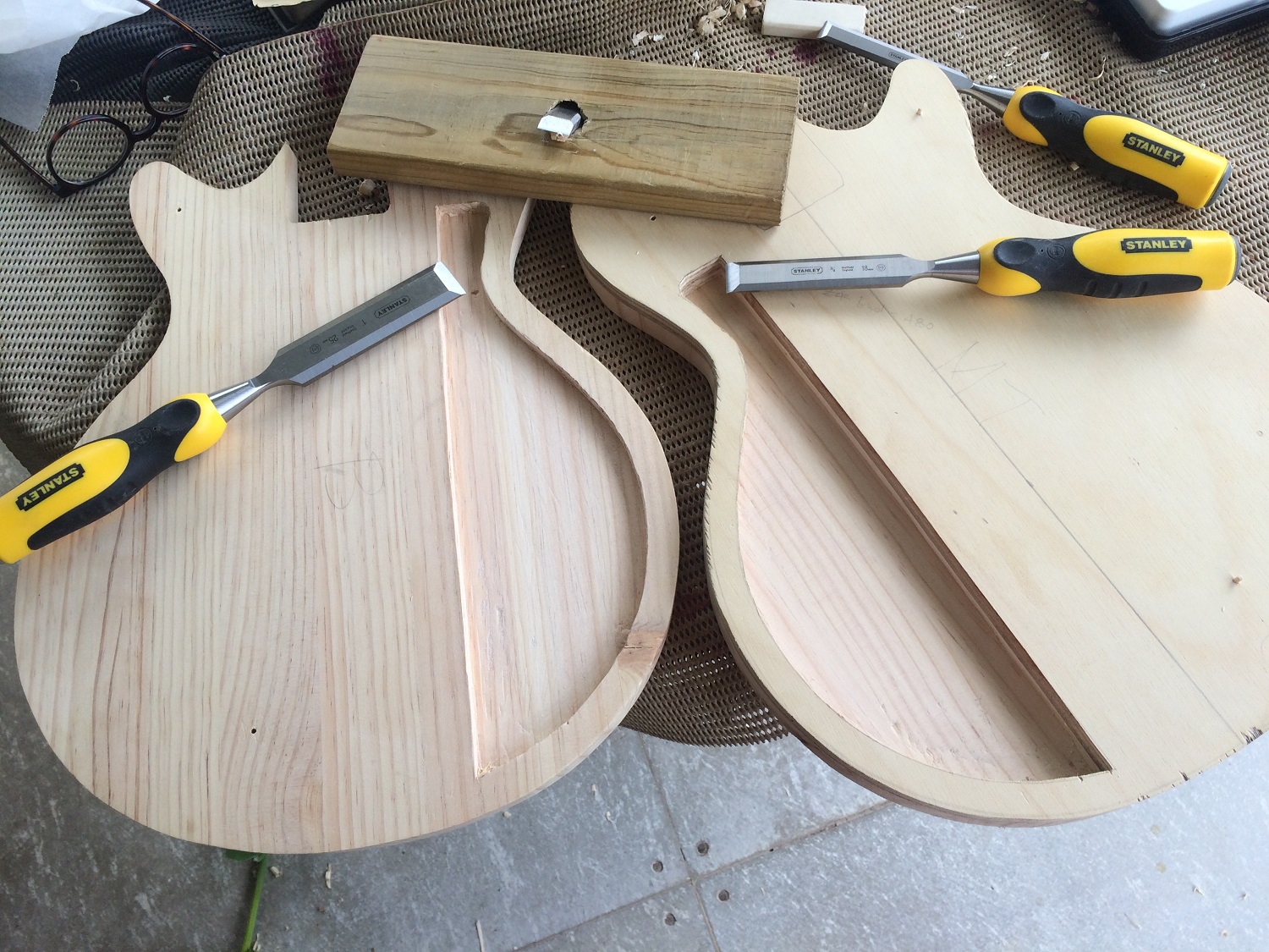

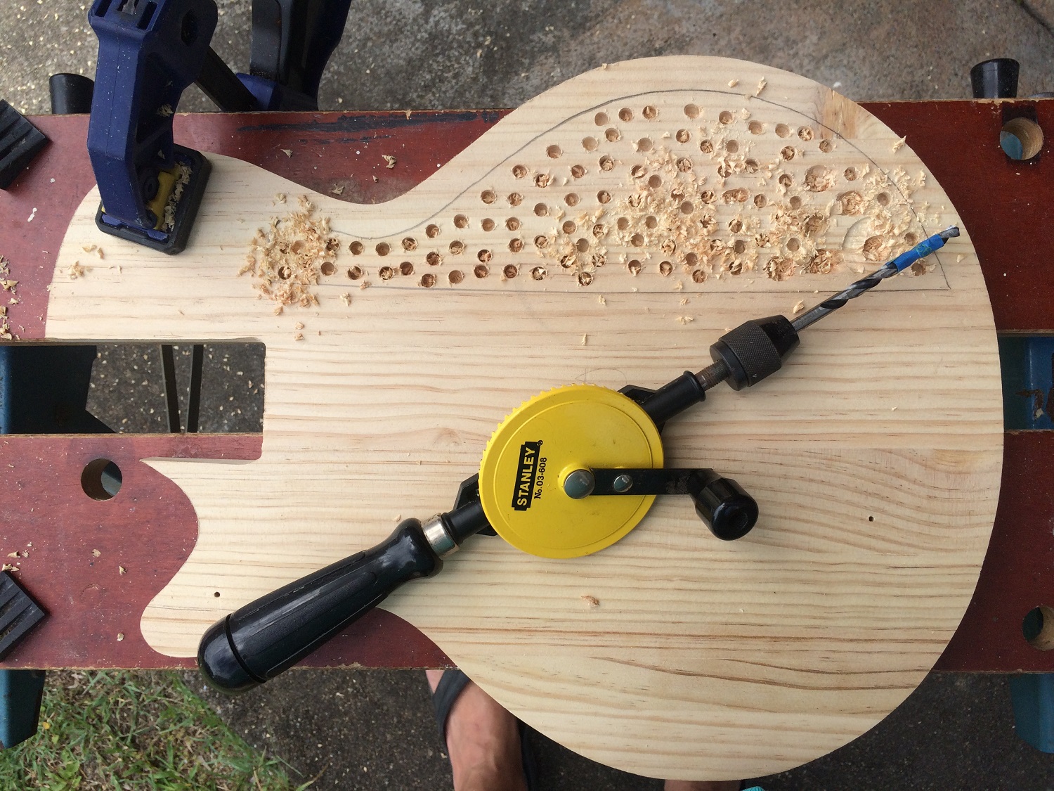

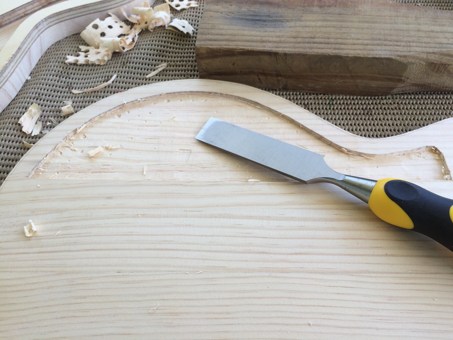

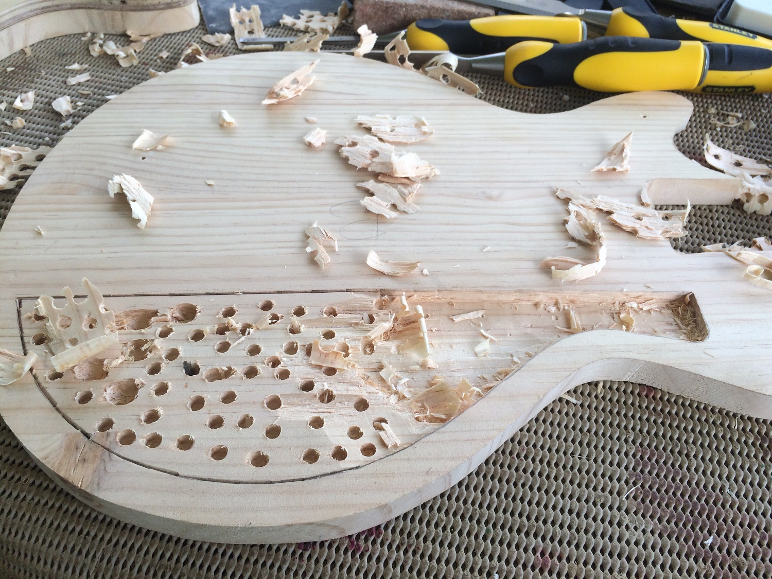

    Next job is to route out the upper portion of the body for a chamber.
    First I drilled lots (and I mean lots) of holes with a hand drill. This not only makes chiselling out the chamber a lot easier but I have also used a bit of tape on the drill bit as a depth guide so that I know how deep to chisel.
ID:	39234 Click image for larger version.

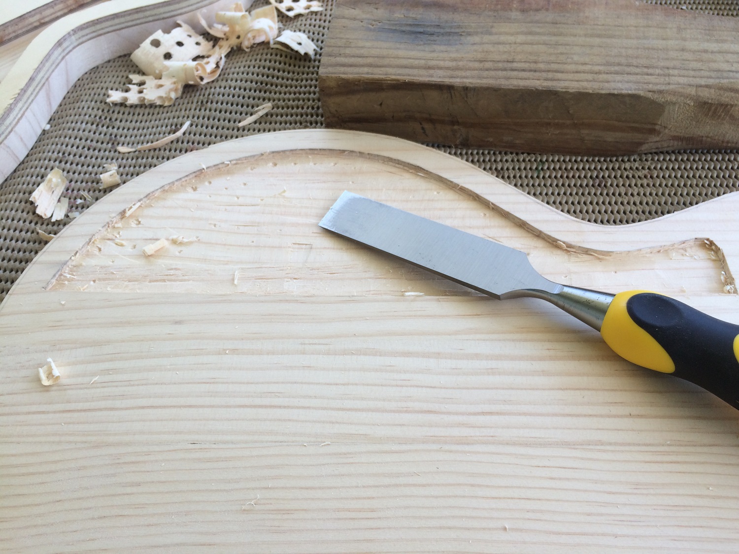

    Its a bit rough,

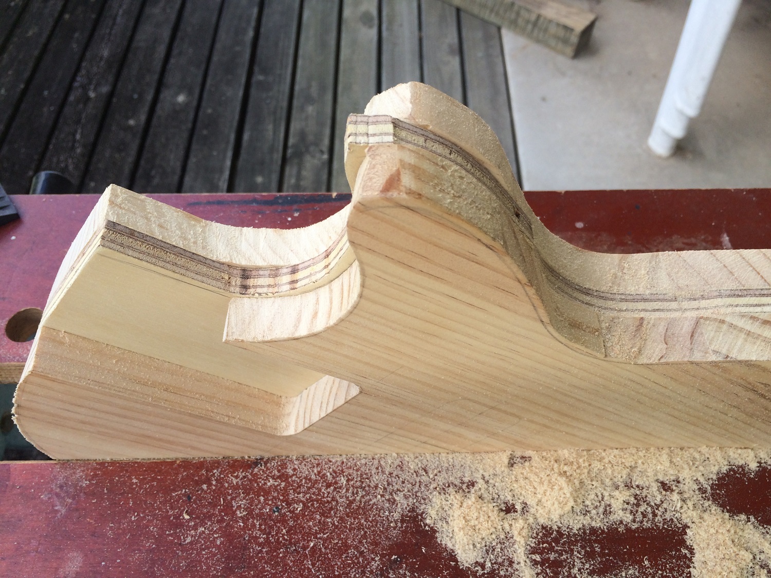

    but then I get out my DIY router plane and try and smooth it out a bit more.
    Do that on the front and back and cut a matching void on the middle ply layer and I now have a chambered guitar.

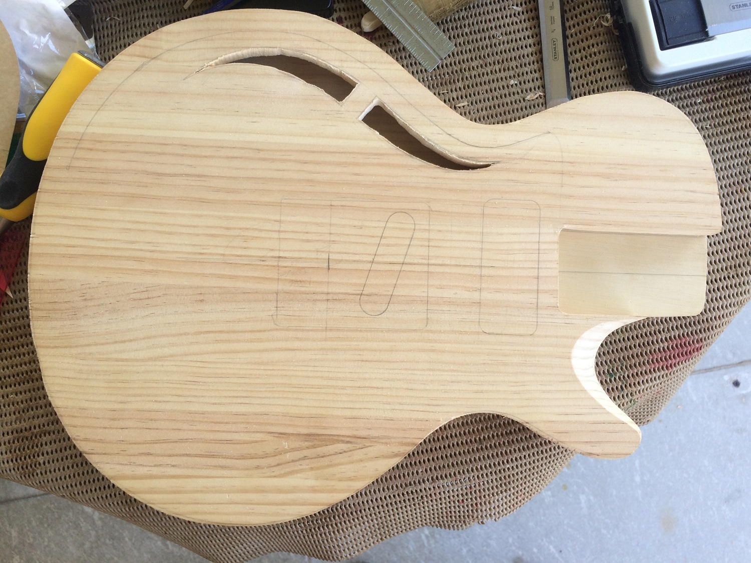

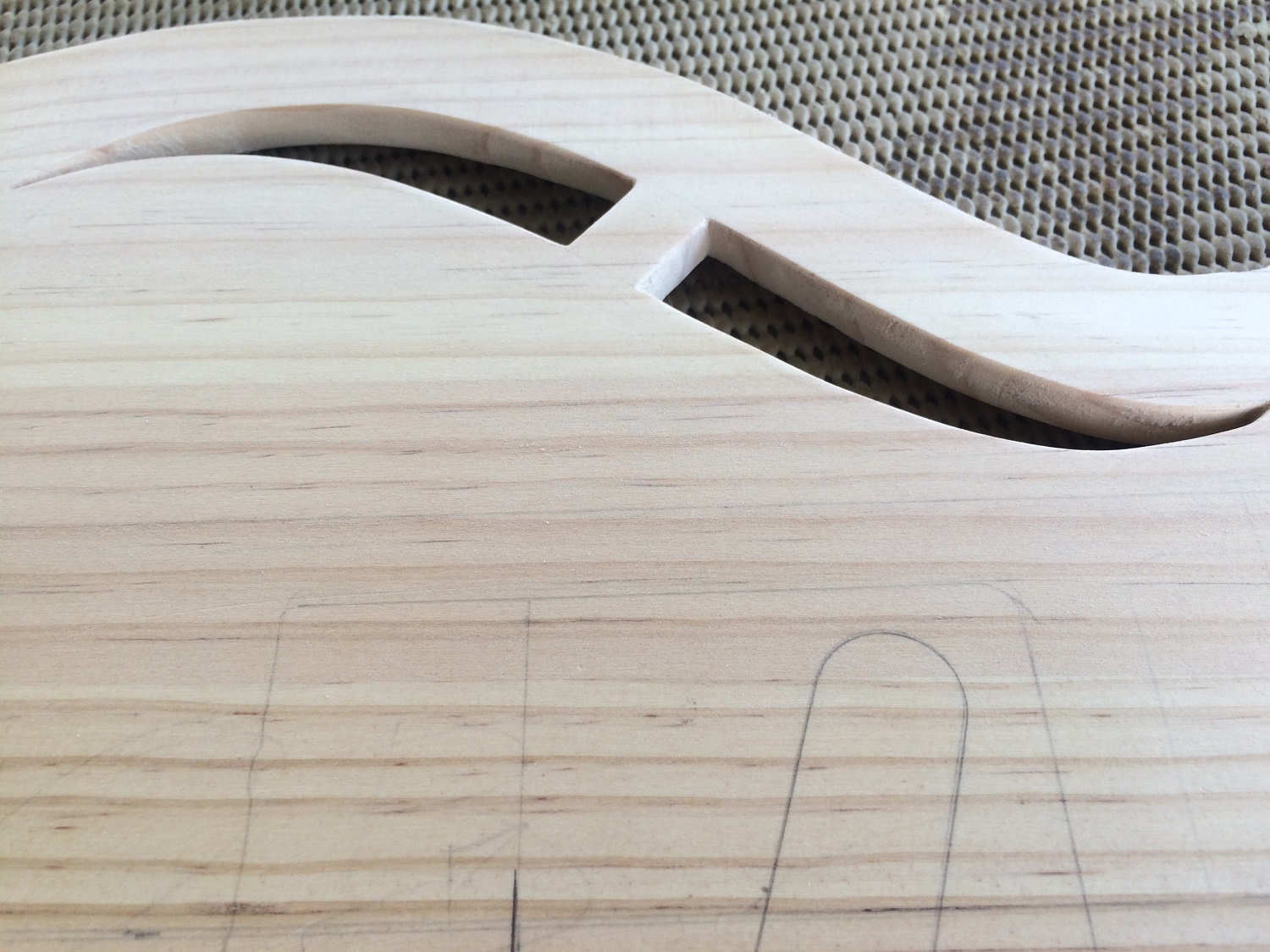

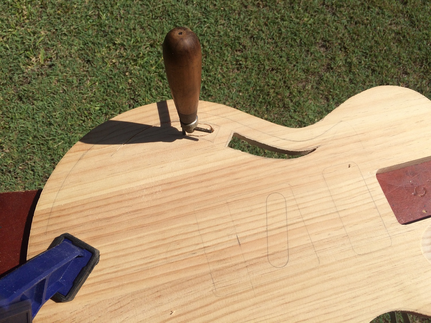

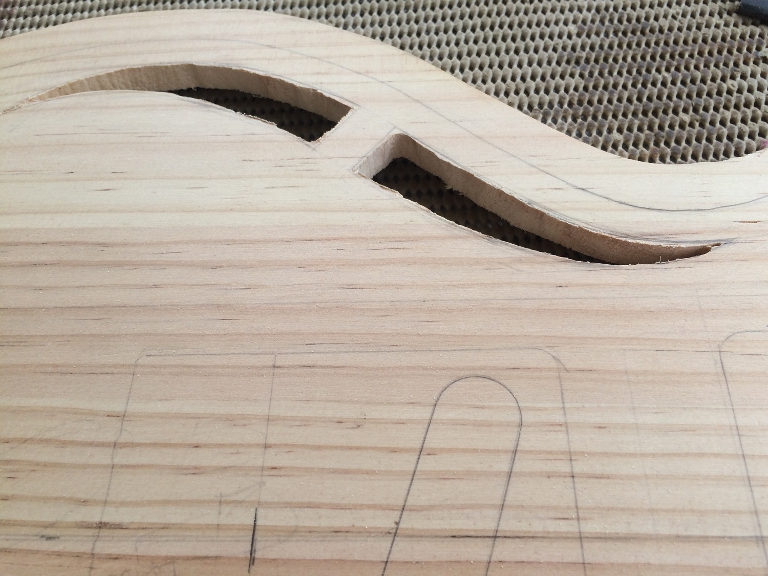

    Now, not much point spending hours to chamber a guitar body if nobody else knows about it, so…..
    Not exactly an “f” hole, but I’ve used this design before and kinda like it.
    A couple of shots before a bit of a tidy up.
ID:	39247 Click image for larger version.
    Still a few tool marks to remove but I will wait untill the body is glued together before I do my final shaping and sanding.
    My next job will be to measure out the scale length so I can locate the bridge and then route out for the pickups and control cavity etc.
    Cheers guys
    rob
