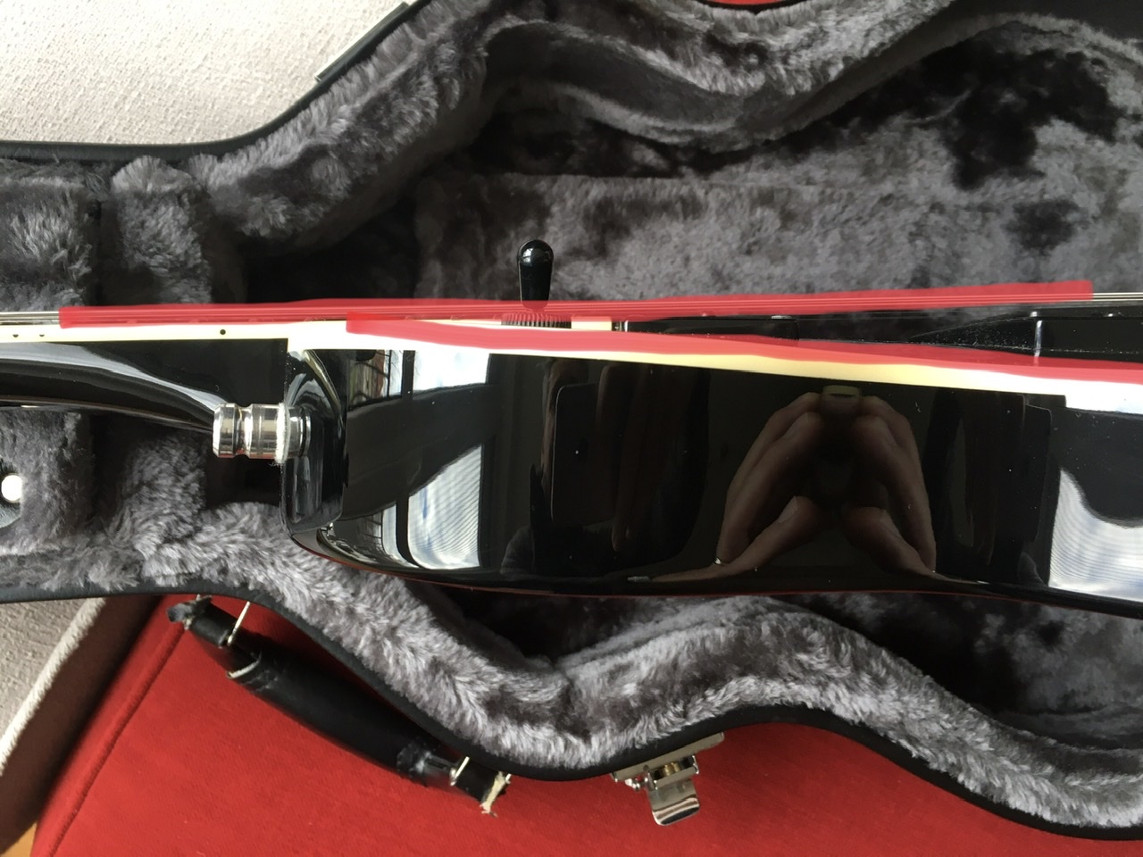

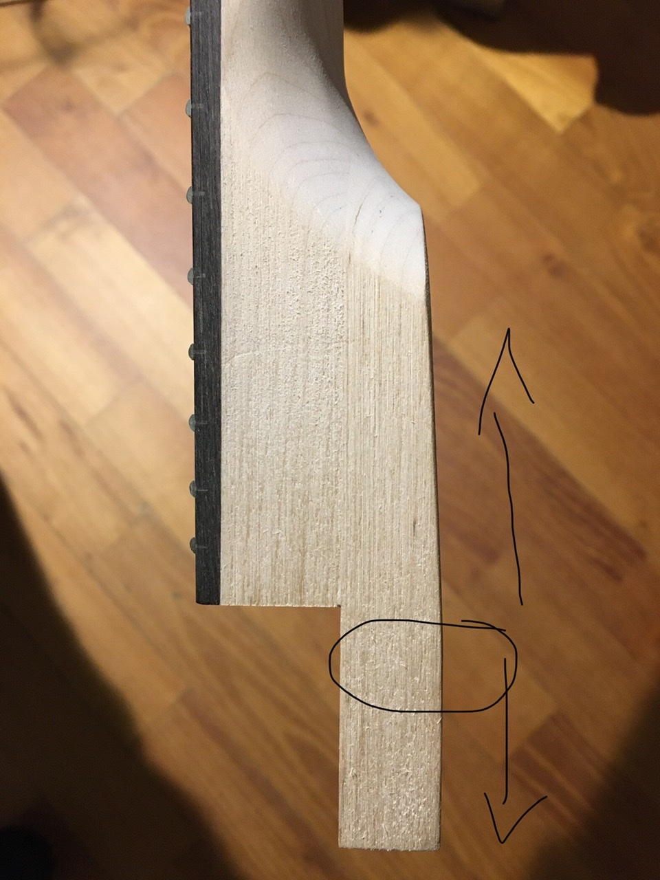

    At first, I was also a bit puzzled by the two planes on the back of the neck that goes into the cavity:
    I am pretty sure the longer one towards the headstock should be up against the body cavity, to create the angle between the body and the neck. Seems a bit odd, but here is a picture of my set neck Epiphone for reference.
    And I hope someone will correct me if I am wrong...!

    The bit at end of fretboard slides in neck pocket and ends up sitting below neck pickup.
    Just beware that end of neck may not need to be hard up against body as this has been done on purpose to allow for adjustment to find right Scale length before gluing & clamping.
    Cheers Waz

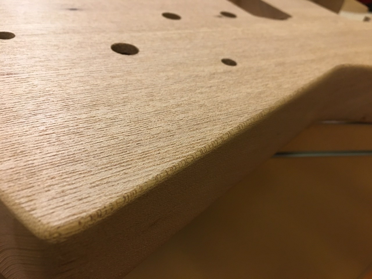

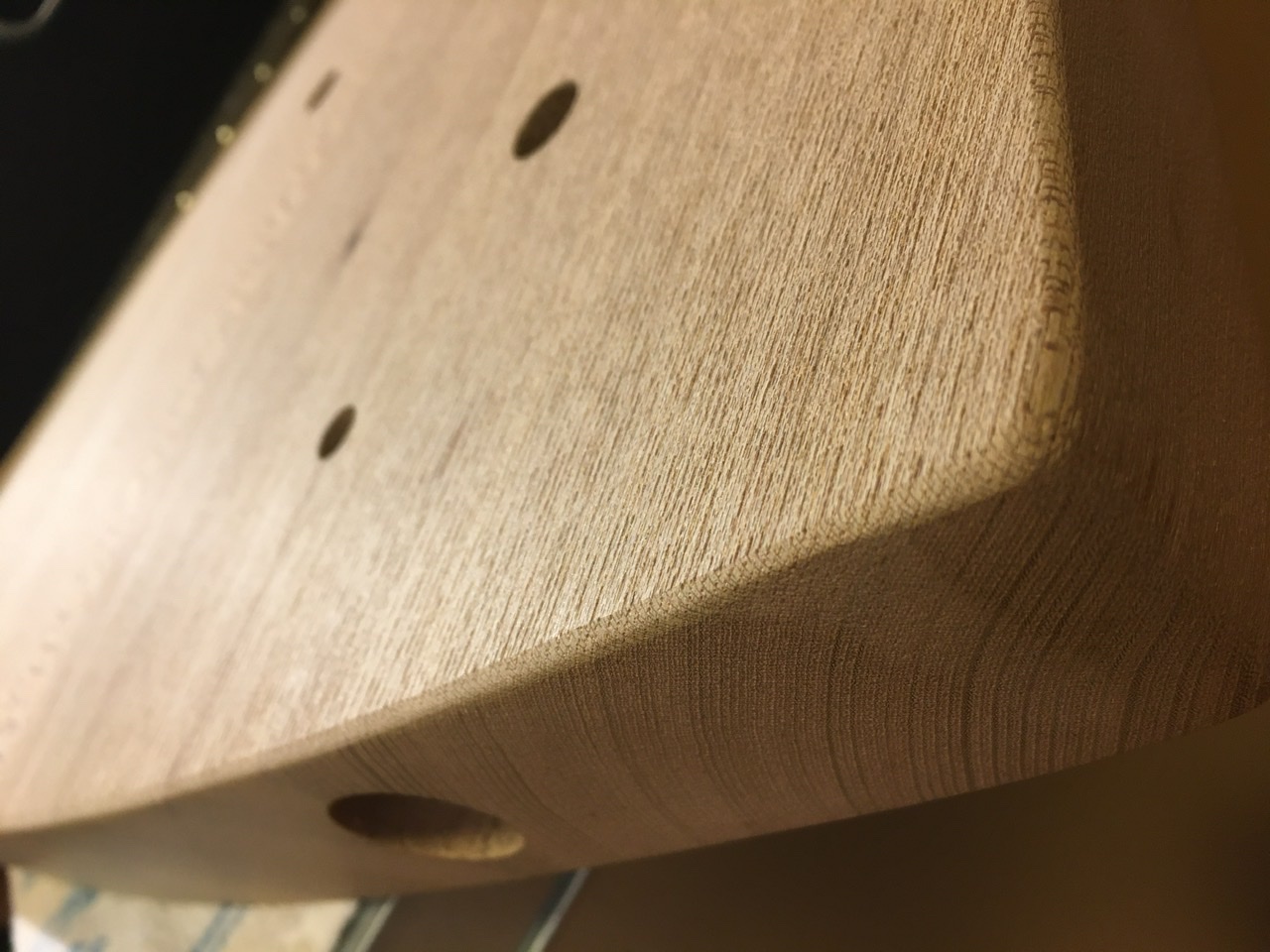

    I worked on finetuning the bevels on the body today. I went for a subtle but visible and even look, but screwed up a bit on the top side of the upper horn: took off a bit more than I wanted to 🤦*♂️
    Anyway, as a first, I think I can live with it.

    You could use some 180 or 240 grit sand paper to help smooth things over to look more uniform unless you want to keep the angular bevel appearance.
